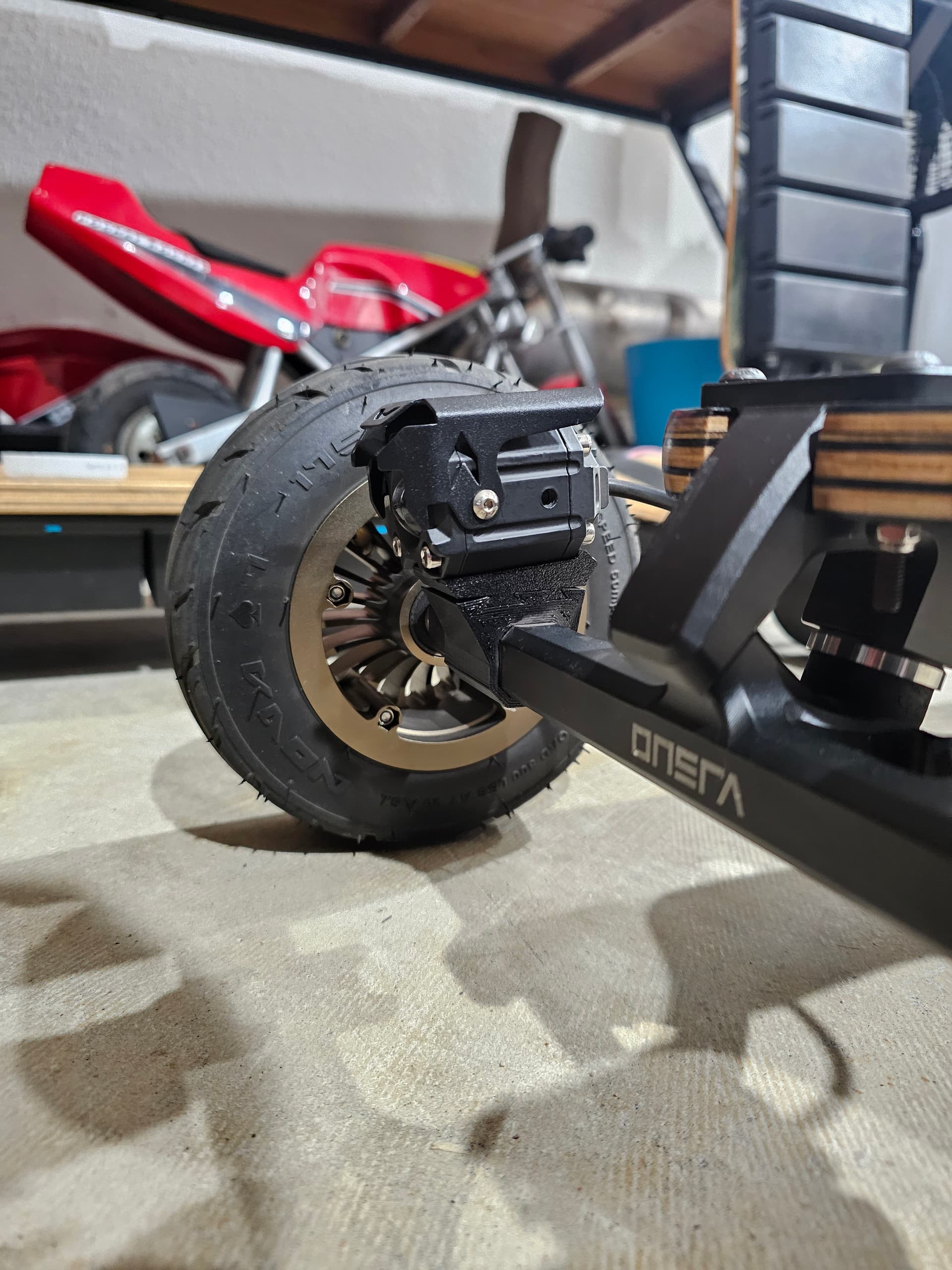

Happy to announce that Big Beems now support the market frontrunner: Duality!
Since the Big Beem mounts already come with an assortment of angles, you should not have any issues getting it to work with your setup by switching out the angled adapter.
Included in the box are: 2x -4 degree, 2x -9 degree, 2x +2 degree, 2x +4 degree, 2x +9 degree.
For my Lacroix deck with a 30 degree front deck angle and the flat baseplate truck, I recommend using the +2 degree adapter. However, for decks with a 35 degree angle, I recommend using the -4 degree one.

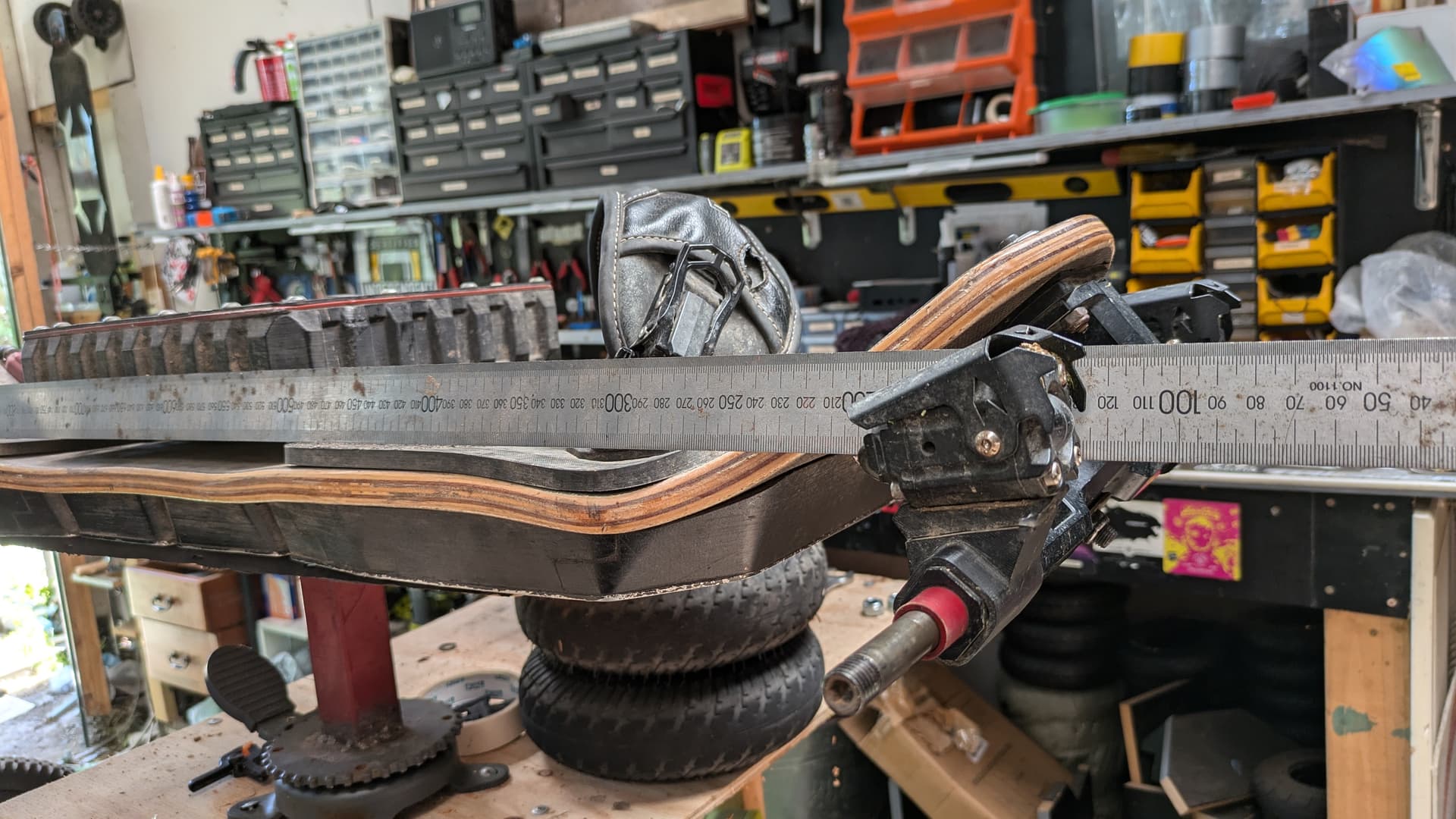

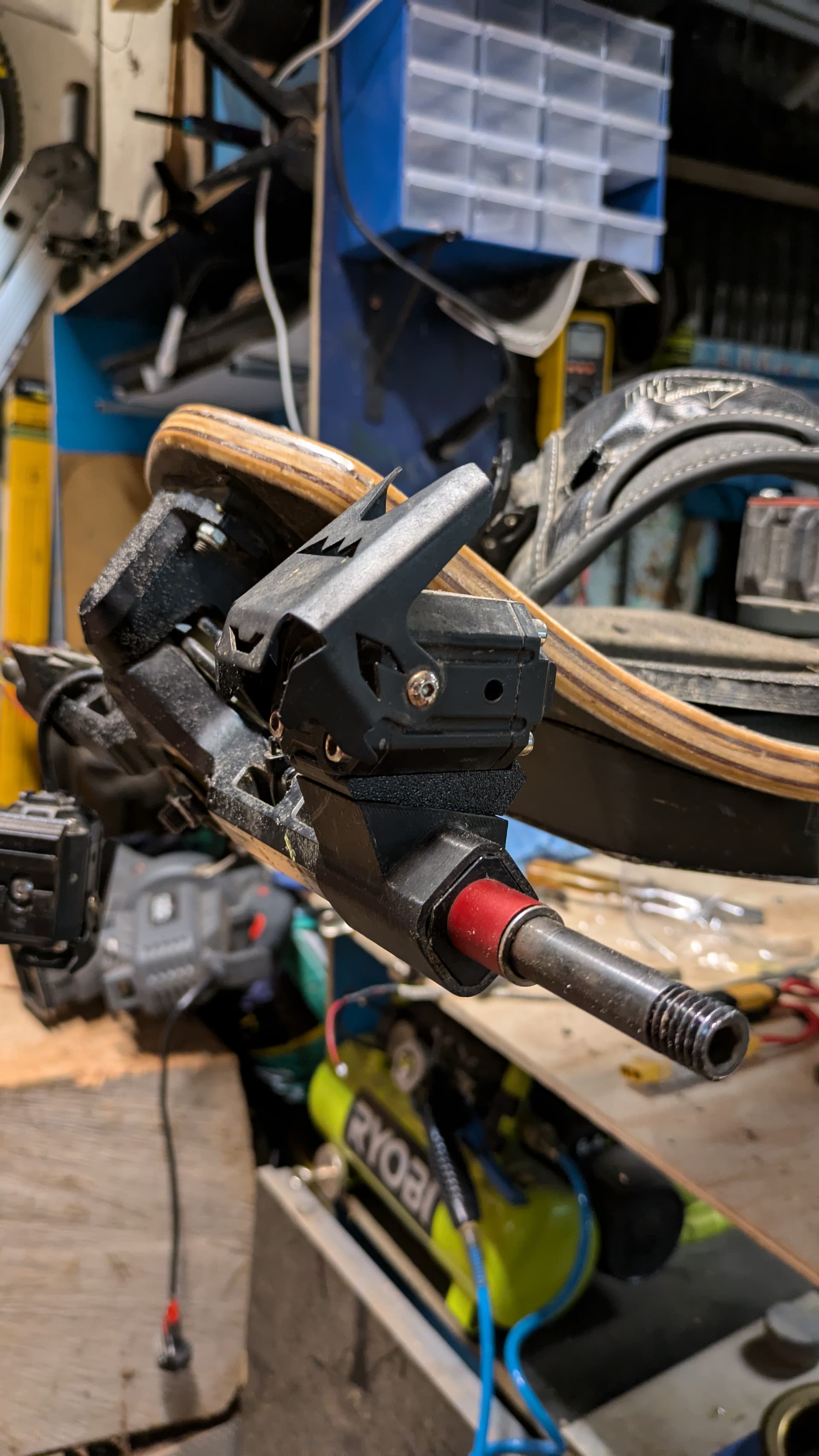

This angle had possums in trees being toasted
This seems level with the deck and might still be a bit high? What angle relative to the deck is usual? I’d think a slight downward tilt would be ideal.
They aren’t too bad due to how their lenses work. They have a flat beam rather than a circular one and that helps a lot with light leakage
Of course the angle you mount at makes a difference too, which is why I provide angled adapters with them. I have an idea for a much more adjustable version in my mind I just haven’t gotten to designing it
Nah this is way off, They should be aimed down at the ground a bit, not up at all. Up at all and you’re shooting cars 500ft away haha

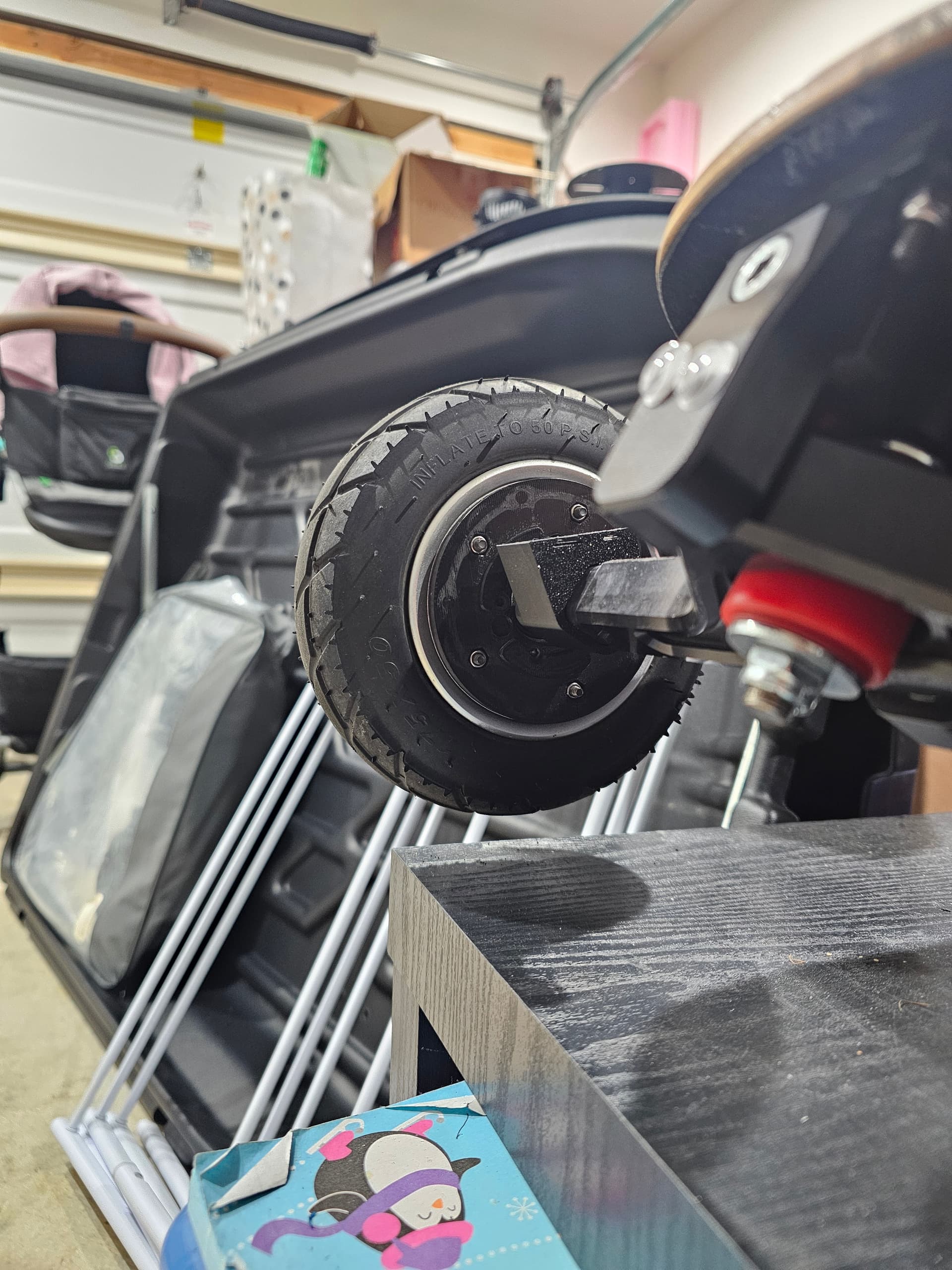

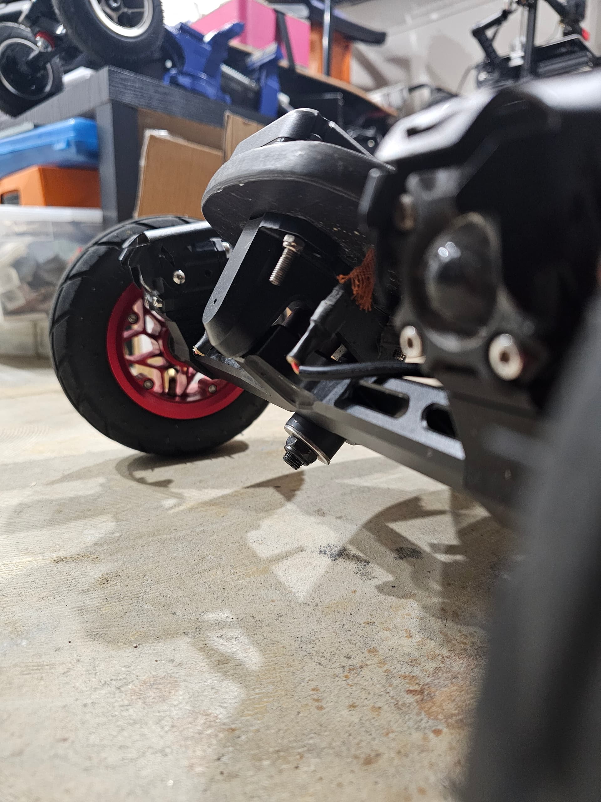

Those mounts were never intended to be at that angle or on those trucks, so it makes sense that it isn’t working right - see examples below:
Haha… thanks. The best I can do is about level and I might be able to use them again with the shield positioned up for now.
