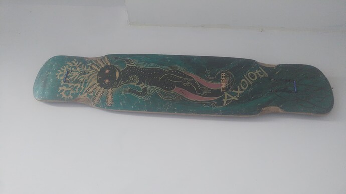

I’ve been tempted a lot to do that when I stoped using my timber deck as a daily driver, then I decided it would be a shame to ruin this sick grafics by having an enclosure bolted to it,
so now it seats on my wall ^^
