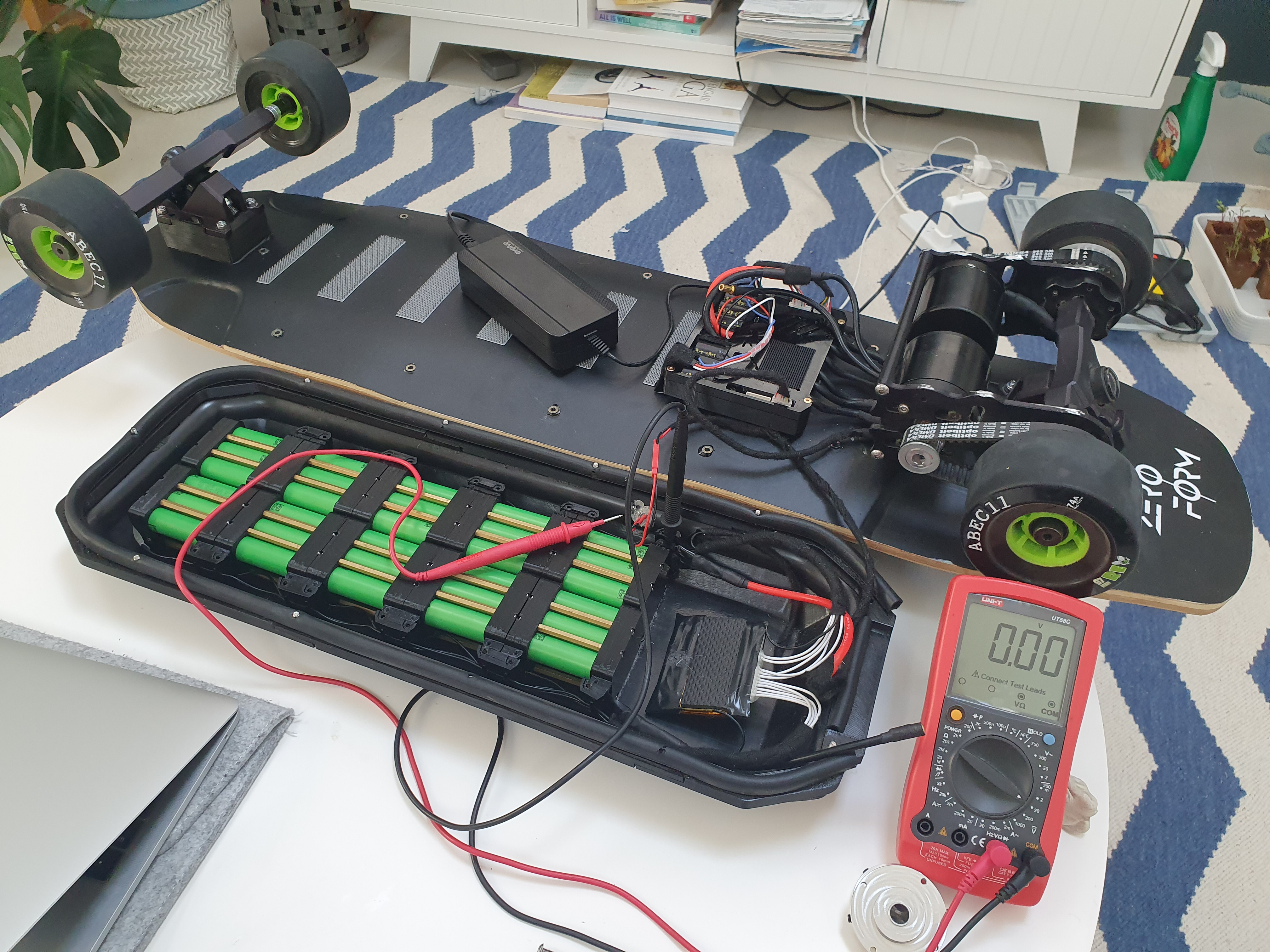

Hey guys,
I have the D140 10s BMS wired to a 5p10s VTC6 pack charging with a standard evolve 42V charger.
My problem is that it won’t allow a full charge (stops charging @40.5V and the light goes green)
The pack also doesn’t stay in balance.
All cells where balanced with in 0.01V when I built the pack, have skated about 40km with top up charges here and there.
Cell levels at a “full charge” (green light shown on the charger) 40.5V.
–battery negative–
*4.05v
*4.04v
*4.05v
*4.04v
*4.03v
*4.16v
*4.02v
*4.02v
*4.04v
*4.04v
–battery positive–
Wondering what my next move should be?
I was thinking to discharge cell 6 down to the rest of the pack and see if it keeps in check with the rest after a skate.
Hoping someone can point me in the right direction as I have used $5 aliexpress BMS with more success in the past.
Thanks so much!

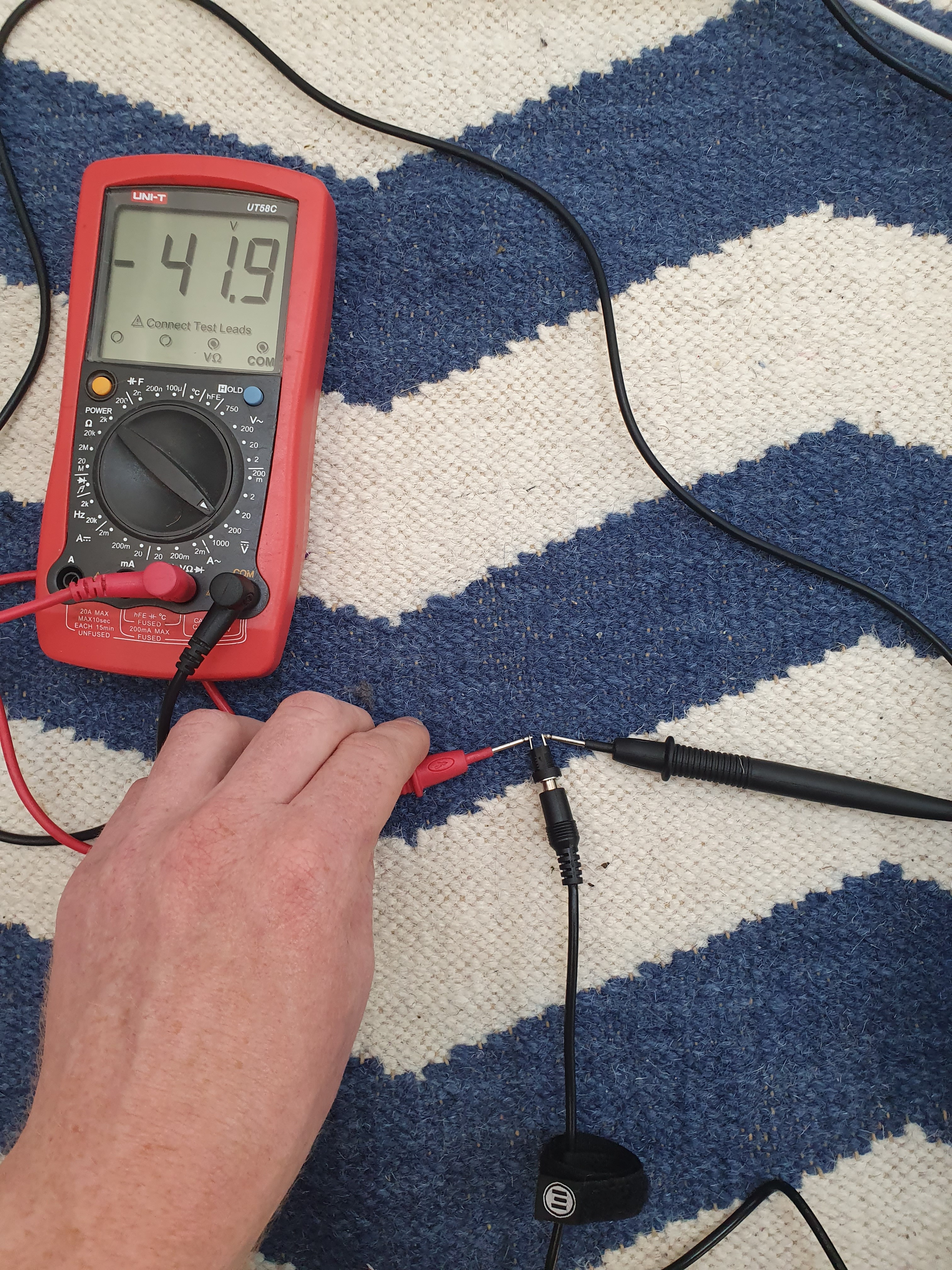

can you somehow check output voltage on your charger? if its normal 5.5x2.1mm, you can stick one multimeter probe inside hole and second on outer cylinder, just be very careful to not short anything.

@tinp123 good idea, yep, I have a few spare charging jacks to test, only problem is I think k if there is no load the charger doesn’t deliver the voltage? I’ll rig a test up tonight and see what I find and report back👍
Charger is putting the correct voltage out.
Next step is to pull the pack apart and check individual cells.

charger is good. I would bet on faulty bms. is it warm/hot?

Ok,
So I balanced things up as best I could.
–battery negative–
*4.11v
*4.10v
*4.10v
*4.10v
*4.09v
*4.17v
*4.09v
*4.09v
*4.10v
*4.10v
–battery positive–
Still getting 41v and the light on the charger goes green :sweat_smile::sleepy:
Can anyone see anything I’ve missed?
Check the 6th balance wire. It might be placed slightly off.
It looks like you already broke down the high group and checked the individual cells. Did you notice anything?
Not anything odd other than all of the voltages being higher than the rest of the pack (and in general, the fact that it will only charge to 41v)
I did find one cell that showed 3.6V then 4.15V - flicked around for a little. Had the same internal resistance as the others.
Marked it and replaced it with a new cell charged to the same voltage.
I was thinking to wire up another 10s BMS I have laying around.
https://s.click.aliexpress.com/e/4CaqTUw8
It’s just a cheap one off aliexpress which I didn’t use because I thought the bestech would give me less trouble :joy:
If I’m honest I wanted to be sure it wasn’t something else causing it because stripping and soldering balance leads is one of my least favorite jobs.
I’ll go for a skate tomorrow, get a partial cycle or 2 through it and check again.
I just checked all of the balance leads, all seem to have good connection, same as the pins in the plugs.
Anything else I should be looking out for?

I’d say that one of the P groups has either a dead cell or a bad connection. Specifically the 6th group. What is happening is under charge voltage, that group is hitting 4.20v and the bms is cutting off the power to avoid overcharging that group. Dropping back down to 4.17 is just the voltage dropping back after charging and is pretty normal for those cells.
Tl:Dr - Your 6th P group has a dead cell or bad connection to one of the cells and there is nothing wrong with your charger or BMS (they are operating as intended).

I’m hoping with a few cycles and the cell I replaced things settle in to a pattern and then I can just enjoy the board :sweat_smile::call_me_hand:
It’s all back together and ready for a carve tomorrow morning.
I’ll monitor the overall voltage on the vesc app, see if it’s discharging is making sense to the wh consumed and do a balance check after a few sessions.
