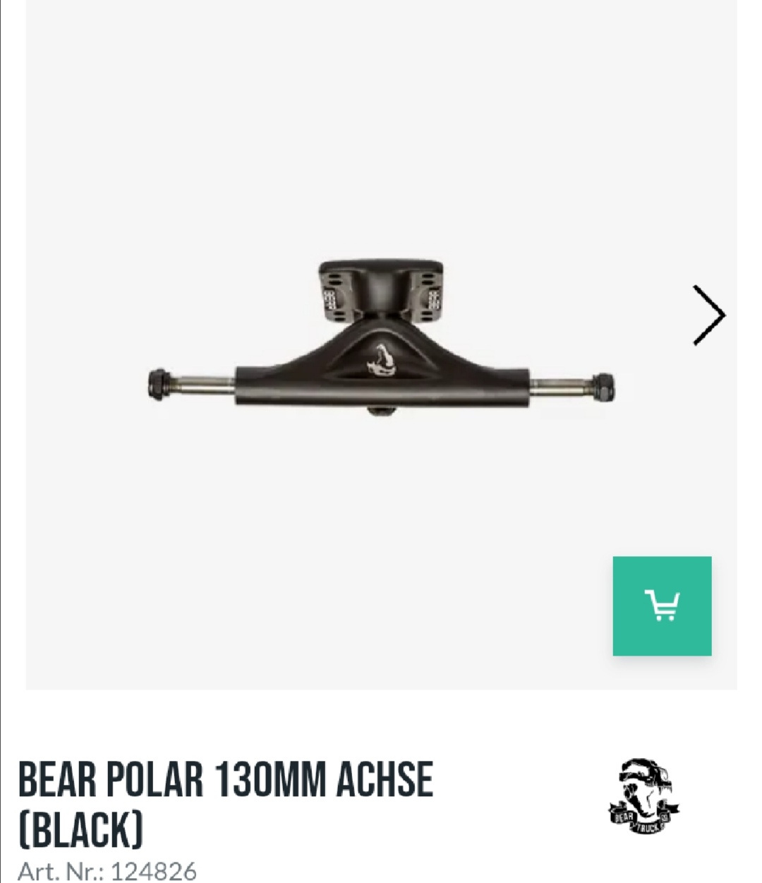

I’m thinking more of 130mm, like those

Surf-Rodz has a 127MM TKP hanger.
They look reaaaallly nice! Also really expensive tho :frowning:

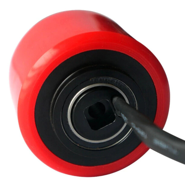

Depending on the axle length you may be able to fit ~500W hub motors on narrow trucks if you file them a bit to fit the square end.
If you want to have more power ether use 4 hubs or you could do diagonal belt drive motor mounts. One in front and one behind the truck. You just need to get a little creative how you attach the mounts.
Following because I have some narrow bear trucks and have often wondered how awesome it would be electric.
Pretty sure the Loaded hubs can mount on a standard length axel. I think the pre-built version comes on Paris v3, so could probably put them on most width of hangers.
Which hubs are those?
That would be the dream but they are also soooo expensive
There are several Hub motors with this similar design. It was just the first thing i found as an example.

So, if you go pretty narrow like 130 like you described, think about your wheel size first, bc 90s or 100s on 130 are just no.

How much axle space do the hubs need though?
