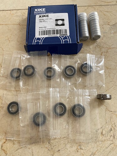

Gonna try these 6900 2rs Xike bearings out.
I’ll keep you posted.

i’ve used xike a lil bit, i’ve had very little issues with en
i tend to always open em up, clean em out, then regrease em to my liking and ive had 0 issues with water

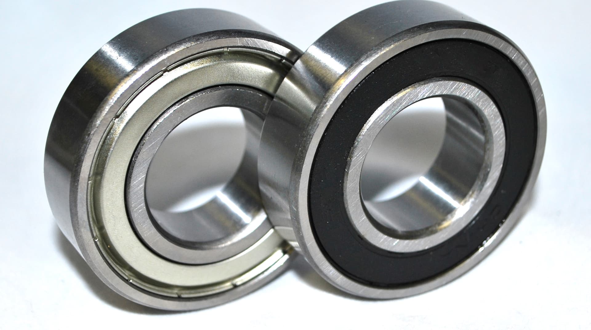

Regarding ZZ and 2RS bearings, is there one that is inherently better for esk8 applications?
The differences are summarized in short here:
ZZ on the left, 2RS on the right:
I go with the sealed ones because of road debris, dirt, dust, and random water splash.
I imagine a strong majority of us use the sealed ones.
i thought the metal ones were better for a while (apparently less resistance) but they easily let in moisture and dust, + no way of opening them to pack them with grease. the rubber seals are sealed tight. i’ve opened old bearings and there was still a decent amount of grease left over, with the bearing in good health.
Imagine a drop of water sitting on the bearing, the metal one would gulp that shit up
