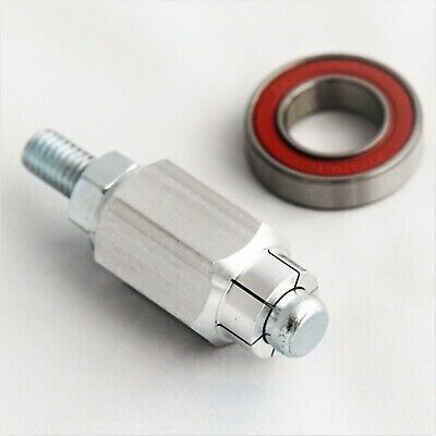

I second this. I heavily prefer bearings without integrated spacers for this exact reason. I have one set of metal core wheels, that i got secondhand, and it took me about an hour to get the included and shot to hell zealous bearings out of them.
yeah instead of pulling a brain muscle trying I would have just went and bought the proper blind bearing expand inside inner race thingamajig
Hammer and a screwdriver xD
Chiselled it out like da vinci. Broke 2 of them in the process but they were mighty crunchy anyways.

I don’t think that would work with integrated spacer bearings still
sure?
Oh that works differently than another I’ve seen, that one probably would work
You guys are aware that pvc pipes cost practically nothing and come in numerous IDs and ODs right?
If the hub can’t separate you can’t push a spacer bearing out that way
True, I’d have to use a flat screwdriver at that point and do some damage.
I wonder if that tool exists… A screwdriver shape that expands the tip like a drywall anchor almost.
Can probably buy a hex nut, cut it nearly in half, then drive in the next size up screw to make something like I showed above.
Would be an interesting challenge to print that tool as well
