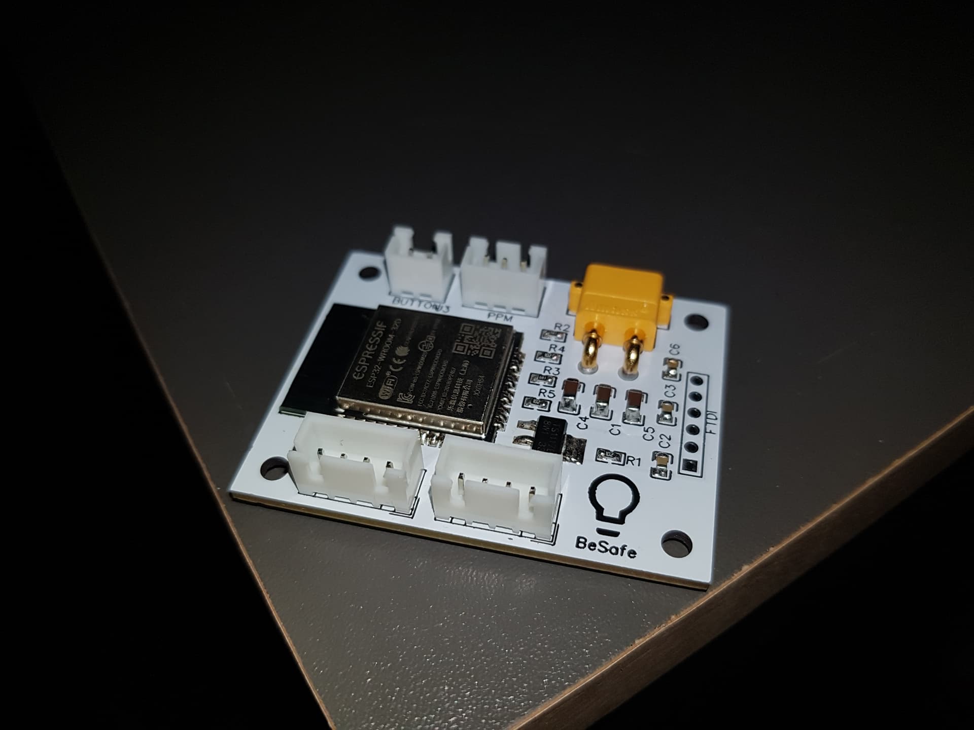

This project started as a simple Arduino thingy to control addressable led strips (such as Neopixel WS2812). I started it a long time ago, and finally finished when @Esk8_Spirit wanted better functions than a chinese module can provide. After a bit of testing, it was clear that setting parameters in code and applying changes by flashing new firmware everytime was very impractical. Therefore, I came up with an idea to make my module better, more intuitive and reliable. I already knew about TelTail Lights (link to forum thread here; I did not check which functions TTL have and I’m not trying to copy anything, let me know if something looks too similar). I made a working prototype which @Esk8_Spirit used and then I had to focus on other things.

This is the second version. It’s based on the well known ESP32 (used also in davega)… PCB was made by jlcpcb
And this is where I am right now. Second version of the PCB is done and a 3D printed case for it is on it’s way.

Think I’ve seen 3-4 projects with the exact same components now, with typically the same functions. Can you guys start cooperating already? xD
Also, put the ESP antenna edge to flush to PCB edge if you want optimal range(not even sure you’re using it but still), alternatively do a cutout under the antenna.
Thanks for the replies! I’ve actually never seen anything similar and that’s why I did this :laughing:
btw. Can u send me a link or something? Or did those projects fail?

Are you open-sourcing the hardware or software? I’d be interested in seeing the code and having a go at a buck for it. Haven’t done PCB layouts before and it doesn’t seem like a huge job
Ha, ESP32 on a white PCB! My legal department is already investigating whether this constitutes an IP violation. I may accept 50% of your sales as an out of court settlement but only because you fixed my Xenith.
Now, with the legal stuff out of the way… You should definitely incorporate the buck converter so that the battery pack could be plugged in directly. Modularity is nice but convenience is also nice.
Thought about it but not open-sourcing yet (not sure if at all)… This project is also my learning way into BLE, so quite a long way to go before usable results will be seen :slight_smile:
