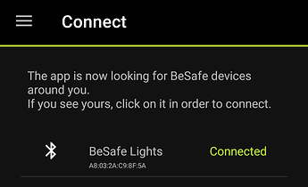

The module is still functional after 2 months of living in my mtb batt case so that’s the first success. Still developing the code so a lot of functions are missing, but the communication over BLE works great, and I’ve not experienced any connection issues.
Here is a short screen record showing the app“s visualization of receiving packets from the module:
The app works on devices with Android 6+ (lightly tested) aaand supports dark/light mode switching :smiley:

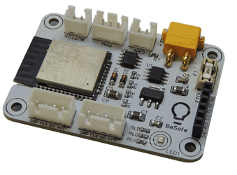

There’s still a lot of work for the app but the hardware might be close to the final version for now. I made another version, calling it the ā€œV0.3ā€, a list of added things is:
  • moved the ESP32 microcontroller to sit flush with the edge of the PCB and added a cutout under the antenna for better signal performance
  • moved the XT30 connector closer to the edge of the PCB - when the module was in it’s case and the connector was plugged in, you couldn’t pull it out without pulling by the wires, now the edge of the connector is sticking out
  • increased impedance on the PPM inputs by adding a opamp - for minimalizing the risk of interfering the signal and causing an unwanted brake
  • added a status LED - you couldn’t tell if the module was functional or not on the previous versions, now it shows different processes such as booting, sending/receiving data or just running
  • added a replaceable fuse - in case a short on the output happens
  • added a CAN transciever - for communication over CAN which all VESCs support, still needs to be made functional in software
  • a few visual changes such as moving text or rounding the PCB edges
I also have a few points for the V0.4, but no plans on realizing for now:
  • adding the ability of measuring voltage and current and showing these values in the app
  • adding protection against reverse polarity
  • galvanically isolating the outputs with optocouplers - fast enough optocouplers for the LED strip signal (800kHz) are pretty pricey
  • adding an IMU - for alarm functionality - when alarm mode enabled, the lights will show a simple animation and when triggered, signal that along with the sound of an external piezo buzzer

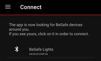

An example of a new feature in the app - this color bar changes color depending on the connection state of the module (red - disconnected, green - connected), so the user knows if the module is still connected everywhere in the app; original idea was to have a simple colored dot, but I did not want to look like copying from the metr app

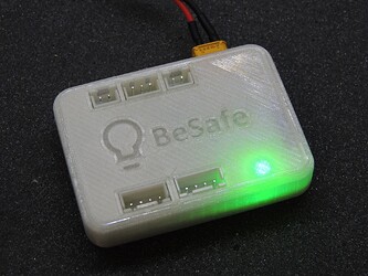

And this is how the V0.3 looks
The case is printed with transparent flexi filament, the light is not as focused as I wanted it to be but not a big deal

now we talking. Havn’t really dug into how the CAN msgs work but I’m guessing you could just listen for the break bits to turn on braking lights, this also separates the state from the remote to the actual ESC.
Adding RPM features and so on should be possible too.
Sure you could make the entire board blink red based on pack voltage too etc.
Might also want to add some transient suppressors into the design. (could be part of the polarity protection f.e)
