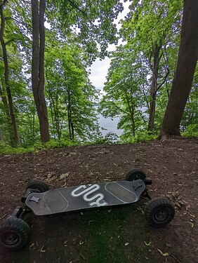

This is my first log thread, so bear with me.
Late last year I moved from Lithuania to Seattle for work. Due to battery shipping being a huge PITA I couldn’t bring my beloved flux across the pond and so it was a great excuse for a new build.
Previous board
  • Flux AT2
  • 12s10p BAK N21700CG
  • FlexiBMS
  • Finality AT 1:4 on fatboy 320 trucks
  • Bloody unity
  • Maytech 6396 140kv

Deck
I started looking for a deck in December and came across a kaly xl-r combo deal that was too good to pass up. It bears resemblance to the flux which I enjoyed a lot and can fit a massive amount of cells.
