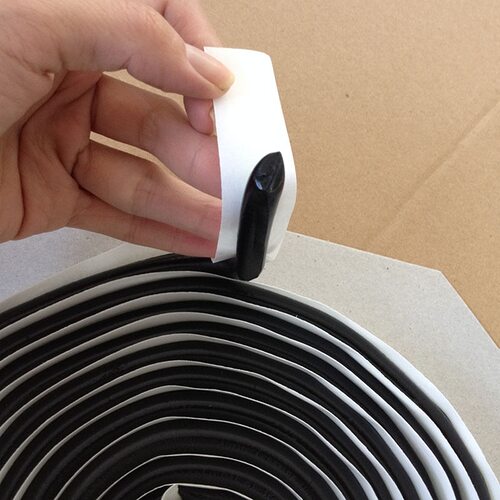

Is this different to butyl tape?

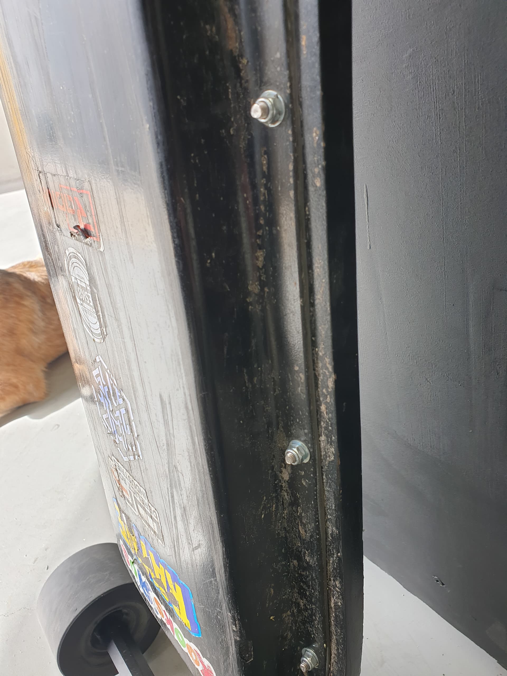

My issue is I have a gap that needs filling. I think my current solution will be a temporary dust only type of gasket till I can do something better
my idea for the future is some kind of thick rubber strip to fill the gap with butyl on top and bottom for waterproofing
I filled a gap between my battery and deck with hot-glue. Although it is only one of the short sides and the battery case itself is internally water proofed as well. Downside is that dry hot glue gets dirty very easily. It has been 9 months without any issues too

yeah. Maybe what i have is less of a gap and more of a chasm. we’re talking about 8mm here
I’d just use a fast curing epoxy to fill the gap then. Put tape down (some form of masking tape) on the deck, then put your enclosure on and fill the gap with epoxy. Let it cure and then sand away the excess so your enclosure now is flush with the deck.
At least that is what I would do if my gap wasn’t only 2mm max. You can then seal the edge between the epoxy and deck with whatever you want to use easily
It is only a different shape. Like if you roll a rectangular clay extrusion into a cylindrical extrusion, except butyl instead of clay.
The shape is just a lot easier for me personally, since the first thing I did was roll the tape into a cylinder. Then discovered it came pre-rolled, so my fingers can stay more clean.
The link @rosco posted is what I like

How much of a gap? Butyl rope can easily fill a couple millimeters but beyond that, you could use two pieces of butyl tape and put something between them.

its a DS eboosted enclosure and a RE44. staggered double stack pack.
I mean you’re right, but honestly im not sure how eboosted intends this enclosure to fit double stack packs with no gaps. I think as it is you would struggle to fit even a taped up p group with no padding and no series connections and have the enclosure flush with the deck. I am using some 10awg series connections which are probably 5mm tall, and im using some velcro under the pack to hold it to the enclosure which probably adds 2mm and the gap i have is around 8mm. Maybe im just being really stupid, but it seems like he should just make the enclosure at least 6mm taller so people wouldnt have to relay on gaskets to make stuff fit.

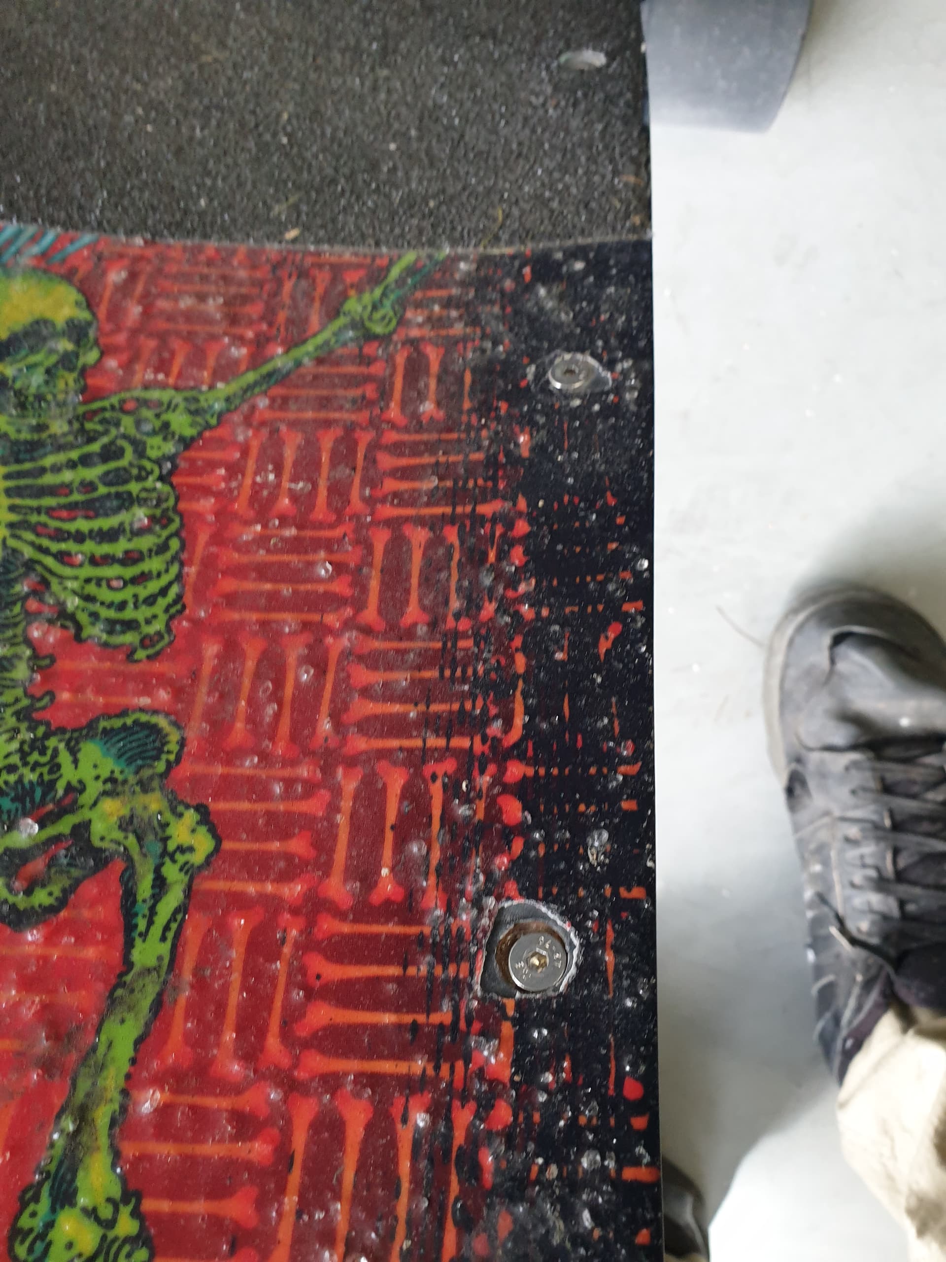

Alright, i have another question. So when I installed the inserts in my deck I installed them essentially so the screw would come out of them normal to the surface of the deck. The enclosure was not intended to accommodate that and wants the screws to simply be vertical in most places. Essentially, nearly all my fasteners cross thread when i try to install them through the enclosure.
Is there a way to fix that?
I was hoping to have this build look kinda nice, but at this point im considering just drilling out holes for flathead screws which I could put through the top of the deck.

I also had similar issues with a double stack RE enclosure. They just weren’t deep enough.
I’ve had reasonable luck molding and pouring urethane gaskets, but it is quite labour intensive and expensive to boot.
About your inserts… that sucks
easiest option is to just drill them out and bolt through. It hurts a bit, but it just works. For my own builds moving forward it’s gonna be bolt through from the start.
