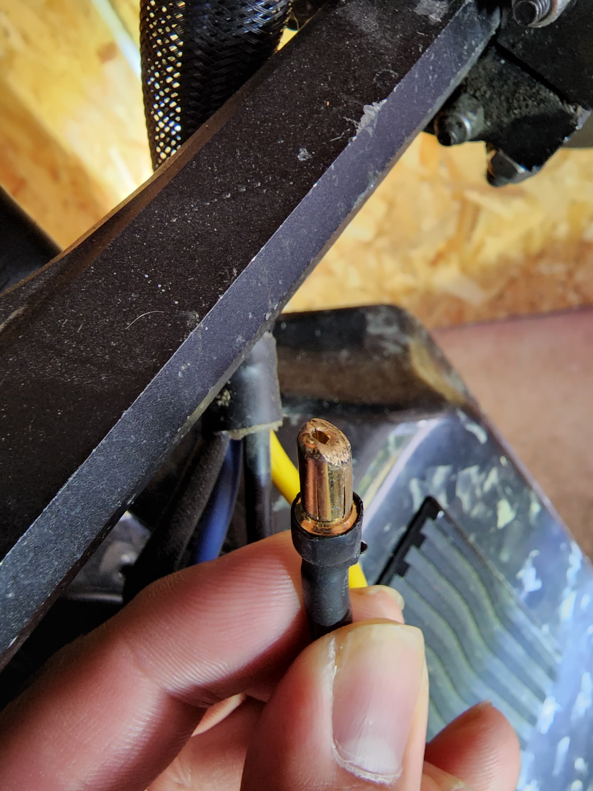

Uhhh I guess it got to hot? Only 1 out of the 6 bullet connectors seemed to have melted.
If it was a loose connection arcing could have caused the melting
That looks suspiciously like it has been dragged along a road.
I agree, that looks more like concrete grinding than melting

Copper melts at 1984°F/1085°C.
That heat shrink would have disappeared if the bullet got that hot.
This could be an arc, regardless it needs to be replaced
