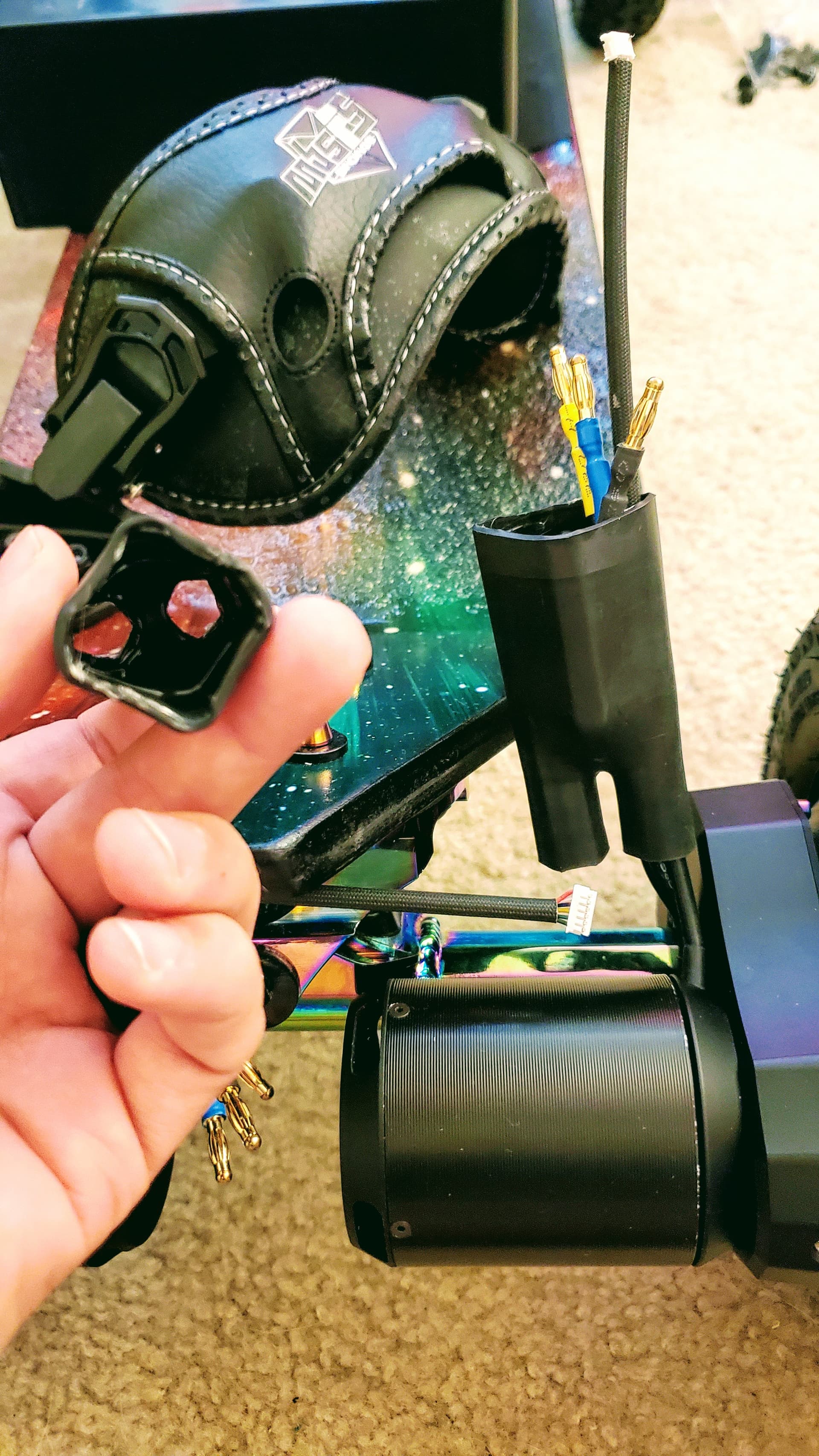

1/2" is perfect for 3 phase and sensors.
3/4" is tight but works fine for 6 phase and 2 sensors.
I even used a cute little pants shaped heat shrink to make the transition from 2 to 1.

A fancy shmancy online heat shrink shop that I can’t find the name of.
Search terms are “cable pants” or “cable breakout boot” though.
:eyes:
I don’t think those are shrinkable. But look at this
:eyes:
its says Insulated Heat shrinkable Tube Shrink Ratio2:1 in the product name :man_shrugging:t2:
It looks like non-shrinkable PVC that comes with additional heatshrink tubing
