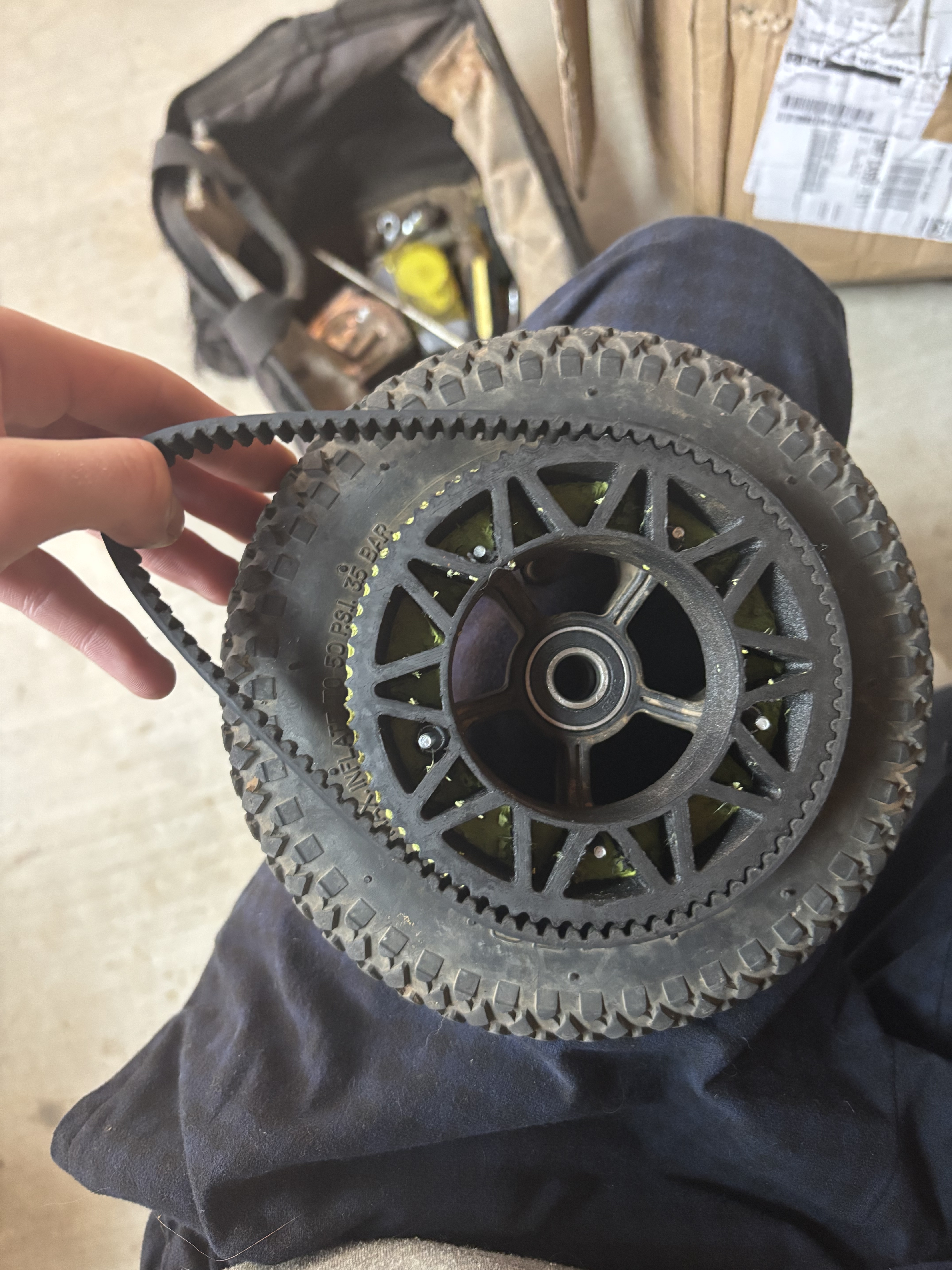

The problems just keep coming. I printed a new glass reinforced nylon pulley, now when I ride, there’s this weird bump sound/things that the pulley makes with the belt, I don’t know if I can get it to set in right, or if it’s more of a motor pulley problem.
Did you postprocess the pulley? Is it dimensionally accurate?
It’s the exact same design, except some extra support within. Just different filament.
Did you measure your final result to confirm? Made sure you’re not getting dimensional inaccuracies from artifacting, warping or layer lines?
Your left (right) belt isn’t aligned btw.
Please post pictures showing the sides of your pulley with the belt on. I want to see how much the belt is engaging with the pulley.
Like this but with no hands, just as it is installed.

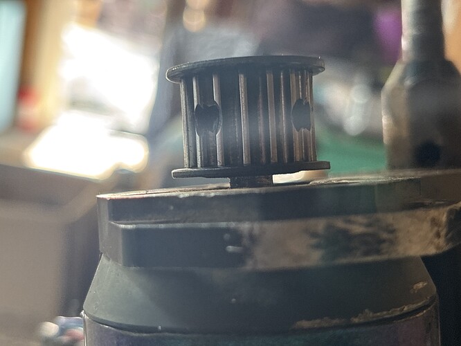

I know, I just haven’t been able to get the blue loctite out, i think I put too much in the motor mounts set screws, any advice on that? I will send a picture when I get home.

The model of your printed pulley
It’s a 3dp glass reinforced nylon, it’s 72t, 15mm wide,
It’s a custom design that me and my dad made.
Do you mind posting the model? Was the previous pulley also glass nylon? What happened with the old one?
The last one was PLA, as well as the other pulley, I only reprinted in Nylon bc I thought it would be stronger, and the previous pla one broke. Model as In file?
Blue loctite doesn’t generally need much to get free but heat helps free up loctite in general. Just be careful of surrounding parts when heating with a torch/heatgun

Are you missing a nut on the bottom in that picture? That might let the pulley be loose enough to knock back and forth
I don’t think so.
