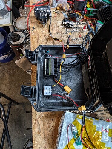

Please sanity check my lighting setup before I plug anything in to test/explode:
1: does anything look wildly off here? Is this gonna explode?
2: if the voltage supplied is within spec; am I correct in believing that current doesn’t necessarily have to be regulated for stuff like lights or a voltage meter? I could technically connect my 12v automotive lights directly to a 1000+CCA car battery’s terminals and they’d only draw the 1.5a they’re supposed to. Right?
3: this Buck converter I’m using comes with a fuse holder and a fuse, I have no idea what the fuse is rated for or if it’s even likely to blow anywhere near that rating. Power is already coming through the BMS which I consider somewhat protected, as well as all the things powered off the converter being pretty inconsequential for safety in a failure. How important is it that I replace that (probably untrustworthy) fuse?
3.5: if I do replace that fuse, how much headroom should be left for inefficiency? (Assuming that I did the math right, which is bold to assume) Math says it should draw about 1.25a at 48v to convert to 5a at 12v. Would a 58v 2a fuse leave an acceptable amount of headroom for inefficiency while still cutting off power before severe damage?

Looks good but I can’t see if the polarity on all the connectors is good, if that is correct then the layout seems good
The lighs and other 12v devices down stream of the buck will draw their full load so as long as they all add up to less than 5a you should be good. No need for anything else to limit the load. If you wanted to fuse the load of the buck you could to protect it but with the line fuse it should be good. If you want to size that fuse the buck is 60w output, do 60w/36v will be the highest amps on the line side of the buck so 1.7a rounding. A 2a fuse will probably do ya and protect from a short or buck failure. Sizing fuses (in this instance) is about finding the amperage that the circuit requires and then going to the next higher standard size.
You said it was feed from the load side of the bms? This is good to prevent any parasitic drain running down the battery.
First off I really appreciate the confirmation of things.
I think they’re all good, I was pretty meticulous but that’s definitely gonna be added to the list of things to check.
I hadn’t even considered the higher current draw as the battery voltage drops, worth keeping in mind for future reference. Good tip.
I’m about 99.9% sure yeah.

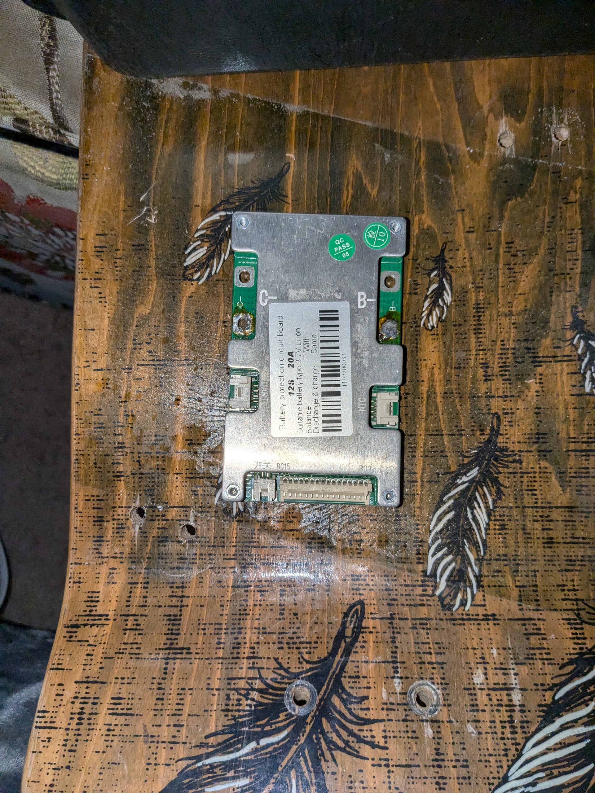

This BMS has 2 contacts on either side that seem to be interchangeable for charge/discharge according to:
Both of them know better than I do and I’m pretty sure “common port BMS” just means that either contact can do charge or discharge.
Yup, charge&discharge on that bms are the same port. Same as most of the jbd bms i use. Looks great man, can’t wait for the rain to stop for a full day. I tried to do snr yesterday and froze my ass off and bailed, the damp just shot through my gear. Gotta remember i cant hang at 40f at night. During the day it was fine. Gonna get a heated vest and better gloves :grin:

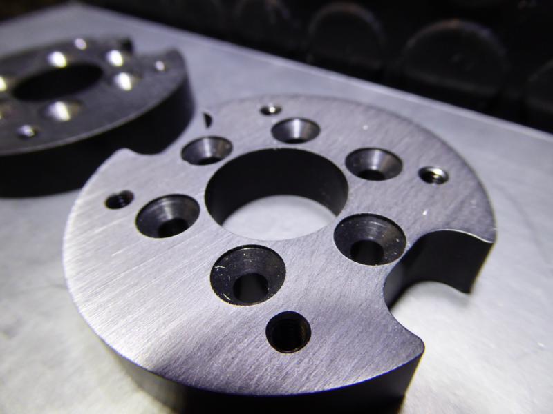

this adapter goes the wrong way. he needs a 44mm mount to 30mm motor adapter
I wonder why the adapter doesn’t have a countersink on the opposite side to make it fit both ways…. Threads - the threads can’t be put on both sets of holes. Took me a second but im gonna post it anyway
