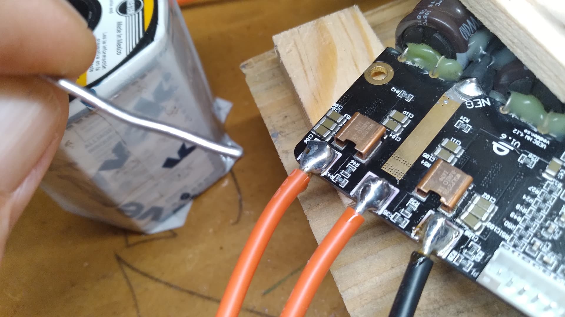

I was just soldering new 14 awg wire to my focbox phase outputs, and on last wire got a terrific electrucal shock when i was touching solder
Did i fry the focboxes?

Did i send 124vac through the focbox, it iz not like it was grounded.
I was barefoot, feet on concrete.
It’s a 40 watt weller with a 2 prong non polarized non grounded plug

was it plugged in?
if not, wild guessing. it probably a capacitive discharge, and if i all you did was shock yourself… it’s probably fine. ( very much guessing. )

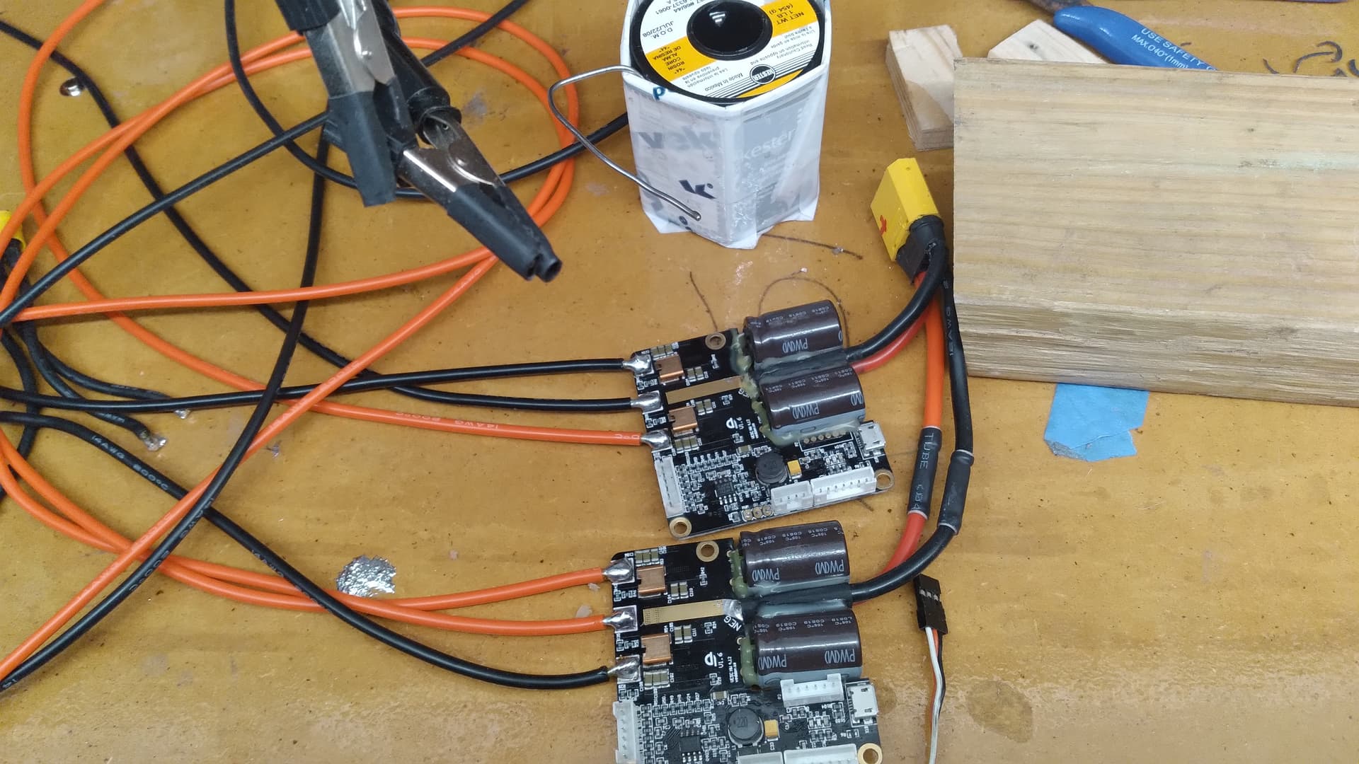

The 2 OG focboxes share one XT90.
The XT90 was not plugged into battery.
I was soldering on new 14 awg phase wires. I grabbed solder in fingers to add more solder to iron’s tip, and got a 124vAC shock.
Id already soldered the 5 other phase leads, without having touched the solder with my fingers, then just finished the 6th.
where was the solder touching? would would have been the path of the connection?
also check that weller figure out how you did that?
I had the kester solder inside the cardboard hexagonal container it came in, on a painted wood surface.
I only noticed the shock when I grabbed the solder in my fingers to add more to the tip, but the 5 previous completed joints the tip was live with 124vac.
The focboxes were not on a grounded surface.
I assume the current path went from 124vac 0utlet through soldering iron, through soldering tip, to solder to fingers through my body to my bare feet on the concrete garage floor when I got shocked the one time i grabbed the solder in my fingers to pull more from box to add to tip.
Ive not tried connecting the focboxes to a battery or motors or a usb cable yet.

tip shouldn’t be live with any voltage. just heat.
and that sounds like a likely path.
bug would be the soldering iron having voltage on the tip. that’s faulty.

I hope I didnt fry the focboxes with 124vac at the tip.
Not sure best way to test them.
There are no connectors on phase cables, and my other soldering iron is a high wattage beast with a huge chisel tip.
probably not… unless it had a path to go through the electronics. the path through you was more probable while you were soldering.
