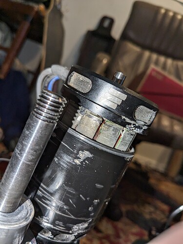

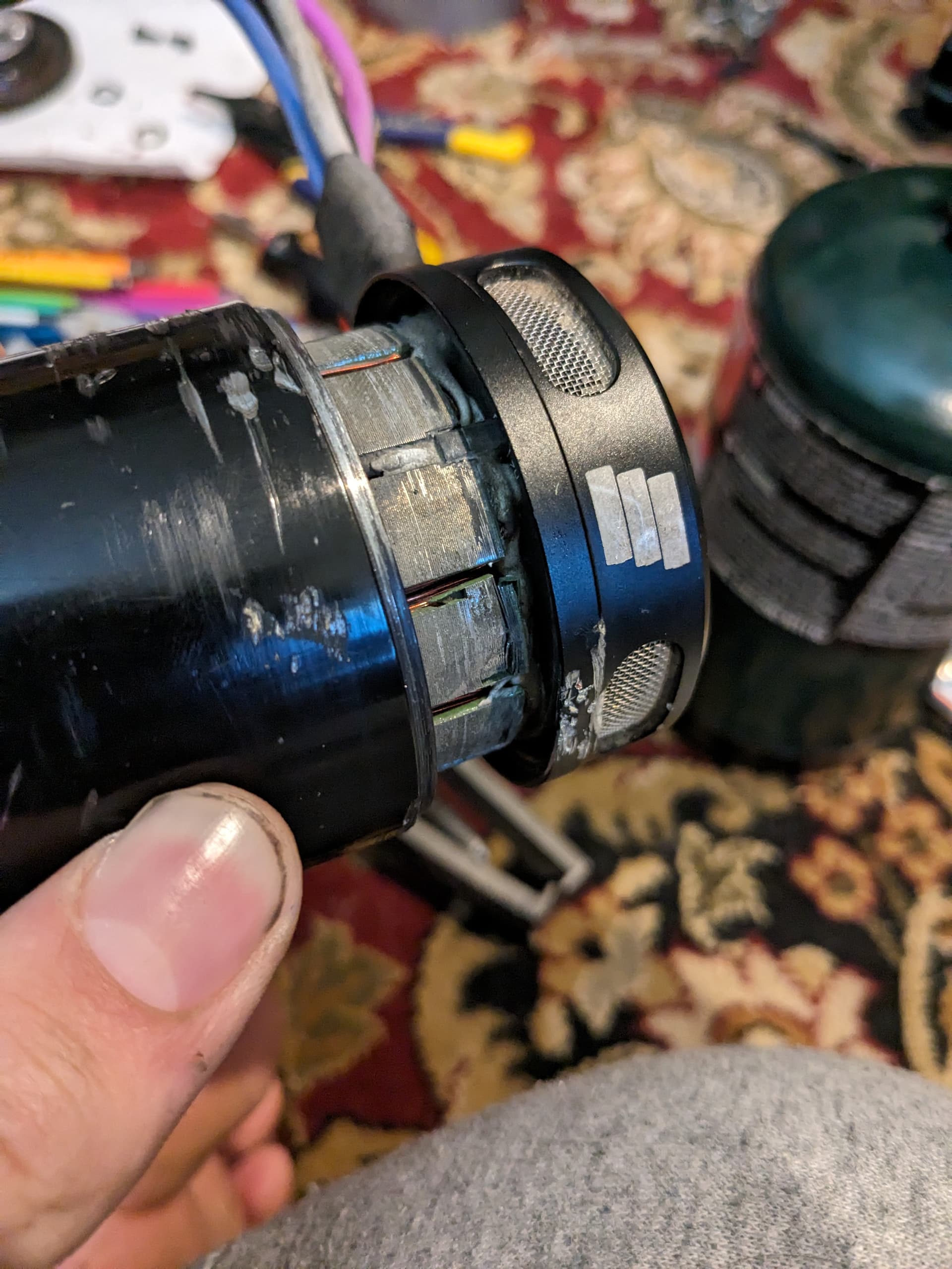

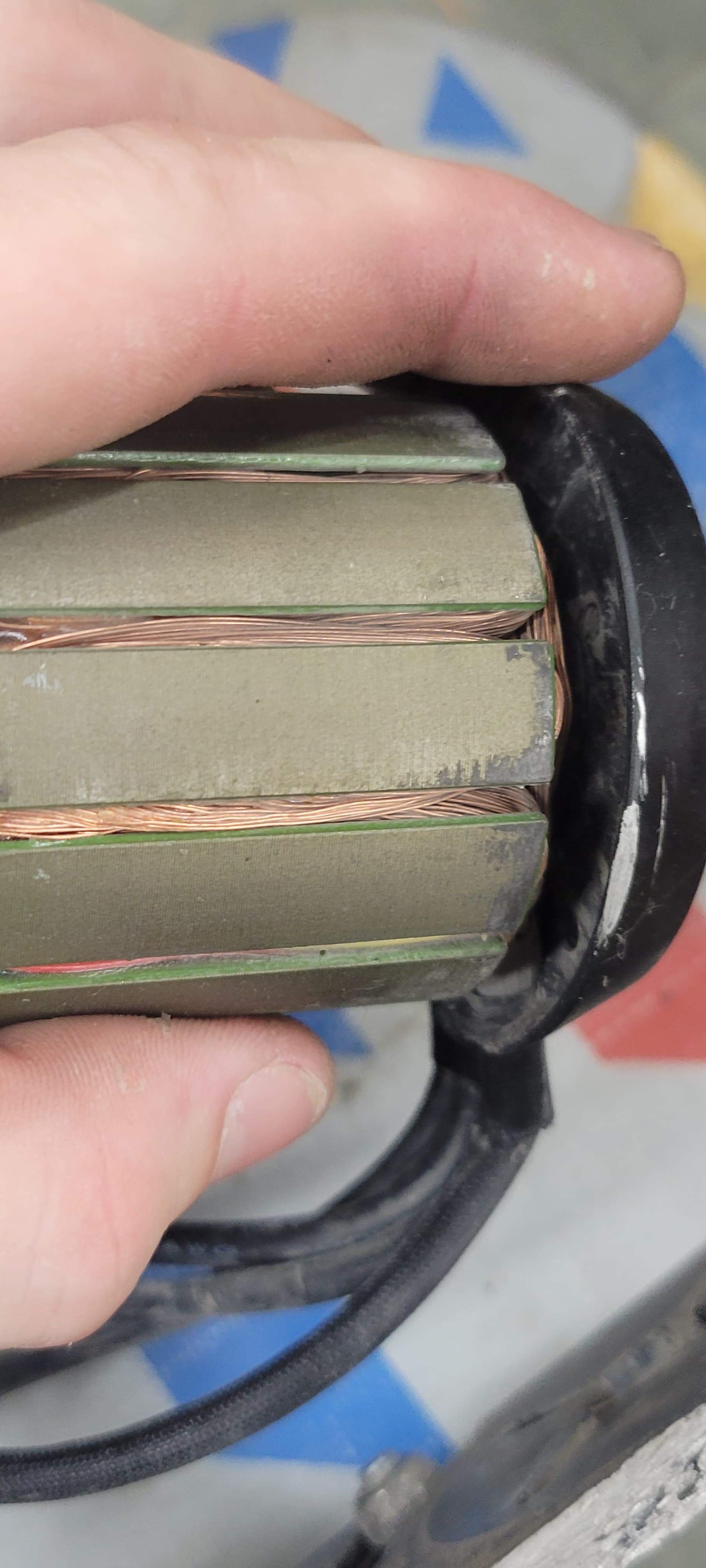

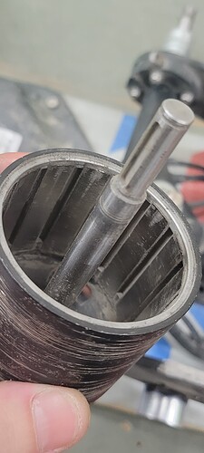

It looks like the problem is more than just the case of the motor, I seem to have cracked a magnet inside.
Is it new motor time or is this salvageable? I can’t seem to get the motor entirely apart either which tells me this might not be the only crack.
That looks bad. Cut your losses and bench that motor. A sacrifice to skaten for your bone pile. Dont try to use it and have it short and claim the vesc also.
