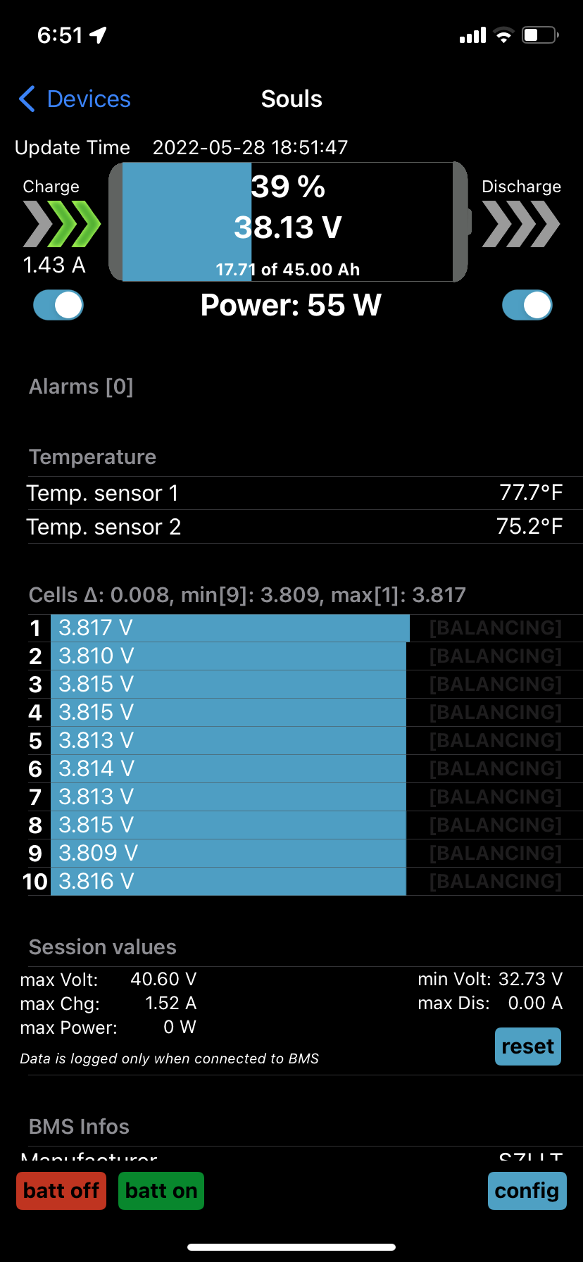

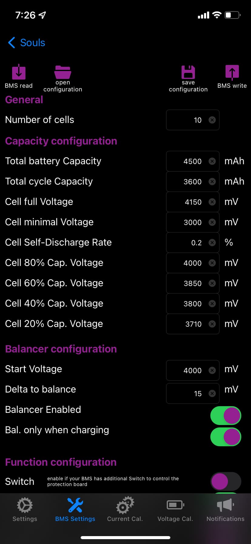

So I went out for a ride and i felt the board slowing down, I looked and saw the batteries were at 96% and at 37.89V, so I changed the total battery capacity to 45000mAh but on the battery it says 4500mAh, not sure if this is wrong but could someone check
Put the battery total capacity back to 4500mah, that’s not the problem.
Because you’re not discharging through the BMS (at least I hope you aren’t), it has no way to measure how much current has been drawn. The BMS is designed to do coulomb counting, which requires measurement of both input current and output current, and since the output current isn’t going through the BMS, it can’t measure that.
tldr, the battery percentage gauge is never gonna read right in the app no matter what you do when the BMS is bypassed. Just guess based on voltage, or use vesc telemetry instead.
No I’m not using it for discharge, charge only. Would a Bluetooth module be more accurate for battery life? Or that wouldn’t matter cuz since I have battery cap settings on the BMS once it hits that voltage it starts taking the power away when it’s at 90% or whatever, that’s something I don’t understand
Oh wait I think from resetting the values it fixed the gauge cuz now it’s reading more accurately
If you mean a bluetooth module for vesc telemetry, then that should be more accurate, yes.
If you mean a module for BMS telemetry, then no, it’ll be just the same.
