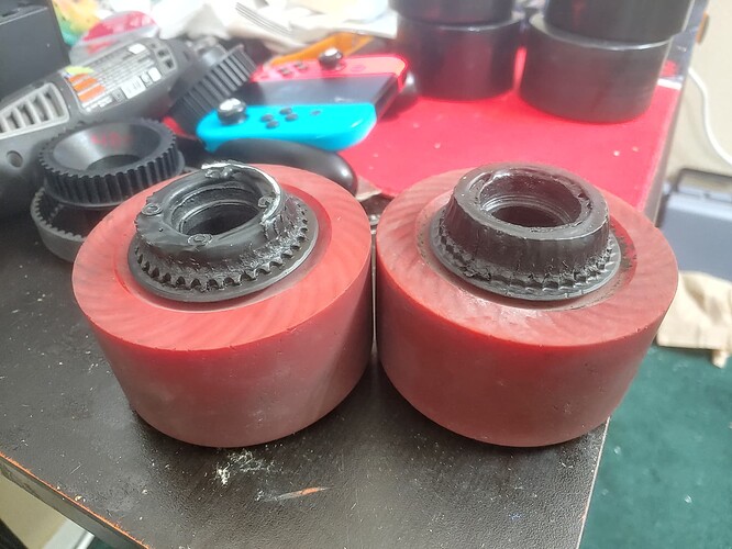

Why does no one ever mention that plastic wheel pulleys can just fucking melt when using them??
These looked completely normal and had minimal wear on them this morning. Went to the grocery store and came back and they were still fine. Few hours later I went to go drop of package and on the way back I started having issues. Couldn’t stop to try and fix it as I didn’t want to shit myself. Got back and the pulleys looked like this. I was less than 3 miles away from home when the belts started skipping on me and my acceleration felt slow.
common sense
And yet no one ever mentions it when people bring up the topic of metal vs plastic wheel pulleys
your board didn’t catch on fire by chance?
knowing you, you don’t have a ride logger?
Surely you must have heard them skipping before they turned into an infinite reduction ratio?
Were they pom?
