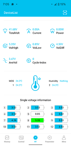

Hmm my next issue is this board doesn’t charge…
When I connect to the BMS I see this:
I’m thinking this might point to a disconnected balance wire?
I don’t see any issue with the wires going into the BMS:
I’m thinking of pulling off the fish paper from the top of this battery so I can check the wires.
I think we found the culprit.
I think this board got knocked a bit in shipping.
Now we’re talkin.
