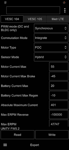

My unity apparently is running hybrid. Not sure why :man_shrugging:t2:
Feels just like normal sensored to me.

What we call sensored is usually actually hybrid mode.
Ah yes, the next post. This is hybrid mode you’ve described.
