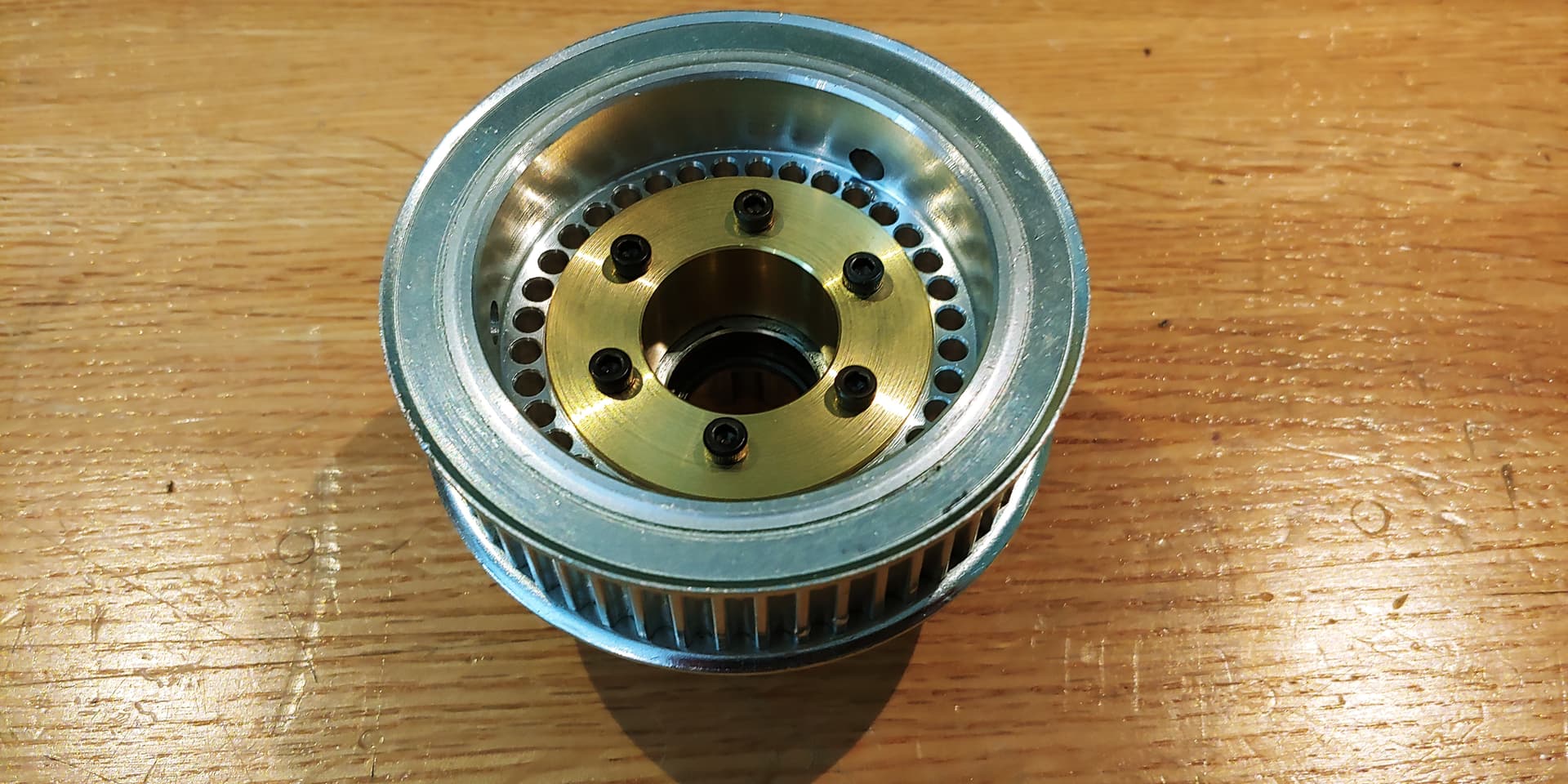

I recently made a custom pulley that, if bought or outsourced, would have been just as much…
the pulley
Only 52 tooth 20mm wide abec press fit pulley in the world (that I know of)
That’s pretty sweet.
Any reason for the double flange? I imagine that might make belt changes a bit tricky
This is still part of a machine that’s a work in progress. I’m not sure if that will survive or not.
Indeed it is, for a good cause tho. I needed a custom pulley for my clouds since I trust the metal ones and the cloud ones are plastic and have a bearing in the back which wouldn’t work on my truck since the axle doesn’t have enough room, so getting this made I can put it on without the bearing and still have it a good quality since the clouds won’t work on regular Abec pressfit pulleys
Wouldn’t a truck or hanger with a longer axle be cheaper? Better? That way you could run a pulley with a bearing
