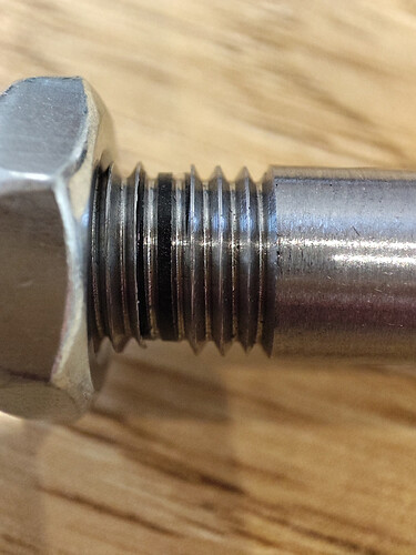

Ok potentially silly question: is this thread gap intentional? It’s on all 4 axles and seems deliberately marked by the black but it’s also got a fairly rough cusp (I think but not sure that that’s the correct machine term) and I can’t think of a reason for it
For @bearlyrecognized this is all correct but one thing to add: the motor won’t be consuming power by regen braking, but it will still be getting hot. There is a possibility that you’d overheat the motor if you hit a downhill at speed and have to continuously brake. VESC has a fun feature where the thermal limit is more generous in braking than accelerating for this specific reason. Stopping is more important than unhappy motors
No, but probably not deadly. I would run a die down it to clean up any smushed threads and just be cautious when tightening. Only the first few threads to the work, rest are there just to provide moral support.
I have never in all my existence seen a thread gap like that be intentional. Were those new?
Yeah straight out of the BN box this morning, I haven’t loctited them down yet and now I’m glad
@Boardnamics have you encountered this before? I’m a bit worried to attach wheels to them
They’re made from shoulder bolts. Latest batch had the relief deeper than usual so thread isn’t fully present there. I tested them and they held together just fine, so long as one doesn’t go crazy with the preload, which isn’t necessary anyways.
The threads are cut after the fact, so they’re already clean. It is because they were cut with an absence of material in the original “stock”

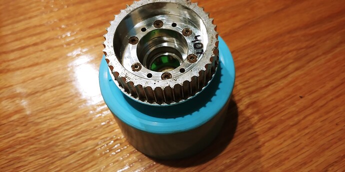

Is 36T the max size pulley suitable for Caguamas? Might try printing a guard and coating in epoxy or something if I try a 40 but I’m trying to gear down as much as possible
I think you can probably definitely use a 40T on those. I can check when I get home if you want.
40T works great on Caguamas and I’d recommend it over 36T
