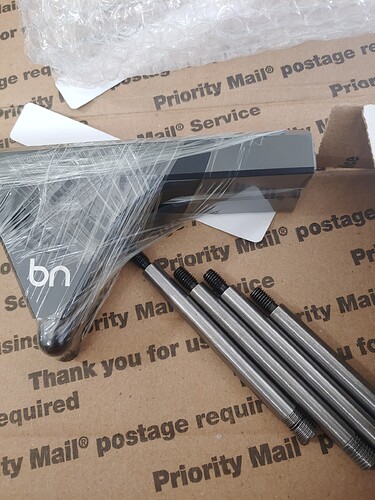

While you are summoned here, I just got in some trucks from you. box came in an hour ago so I haven’t tried anything yet. Just don’t want to have to undo any mistakes I might make I have no idea if there is any recommend method to the assembly, so what is the ideal way to get everything in place and to have it stuck in place.
Oh and thanks for adding in a ton of half size spacers since I actually needed some and was going to waste time cutting full length ones in half since they don’t sell the shorter ones locally.
A small amount of red loctite is fine. The manufacturer did a good job cleaning the holes out this time.

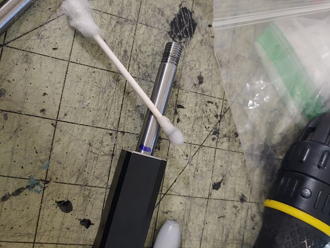

I’ve been using epoxy for years on Boardnamics axles and never been disappointed. Clean the holes out really well with cotton swabs and isopropanol, wipe the axles with isopropanol, and put TINY dabs of epoxy on the smaller threads and screw them all the way in. Wipe any extra epoxy off with paper towels. Don’t get any epoxy on the bigger threads.
Of course you can also use <missing number> Loctite if you want to :crazy_face:
I just went out and bought some 271 loctite. I have plans to strip these hangers and paint them in the future and it would be nice to be able to remove the axles to make soaking them in acetone easier, so epoxy would not work well.
I do like having the axles on during spray painting though since I can use plastic trays to prop up the hanger so I can paint both sides at the same time. They get tapped off during the painting
The new hangers are already very clean btw :ok_hand:
Even if they got all the chips cleaned out, there still could be coolant or lubricant residue.
But if you’re using Loctite 271, I don’t think that matters as much as if you used epoxy.
This is how dirty a q top got after cleaning all three of the remaining axle holes. I’d say it would have been fine to put some epoxy in there without cleaning it first tbh.
I didn’t clean the first one and it is already set in place but it should be fine :person_shrugging:
