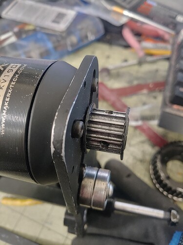

Is there any reason to use a pulley key if the pulley also uses set screws? The ones I have now have two holes for set screws and I already bought more so that way both the holes would be in use (only came with one set screw per pulley). Do I need to also figure out what size key to use and install them or can I go without them?
Currently, the pulleys will not budge at all with both set screws installed. Hell, even with one set screw I couldn’t get them to move at all. I just added more to be safe.
Also I have to use a clamp in order to fully push the pulley onto the motor shaft and need to pry it off using the back of a hammer since it is on there so tight even without the set screws. Not sure if that matters or not when determining whether to use a key.
Photos for reference if needed:

the key is what’s transferring the torque from motor shaft to pulley, then to ur wheel, a set screw isn’t gonna hold that force for long befor backing out or just getting disintegrated
u need a way to lock the pulley to the motor shaft securely that can withstand the force u putting through it, a set screw CAN work, but for how long
why can’t u just use a motor key?
Because I don’t have any and have no clue what size I’d need. Hence me asking if I need to try to figure out the size so I can (buy and) install them. Although if there is any sort of standard size knowing that would be helpful as a starting point
Also do I just shove it into the hole after the pulley is on, or do I need that hole to line up to the little grove in the motor shaft?
motor key is usually 3mm x 3mm, and length depends on how long the groove is on ur motor. usually i would try to get a close enough length one to fit the slot, but u technically don’t have to.
yes, that’s how the motor and pulley are mechnically lock along single axle, i would also suggest u dab a little green loctite on the groove before hammering the key in, so it won’t rattle or somehow destroy itself during operation

Install the key with retaining compound in the motor axle keyway, then squeeze the key in with a mallet or pliers. The set screws should just keep it from sliding off the shaft.
Remove the pulley by heating it with a lighter or torch, and using a pry bar between the motor face and the pulley.

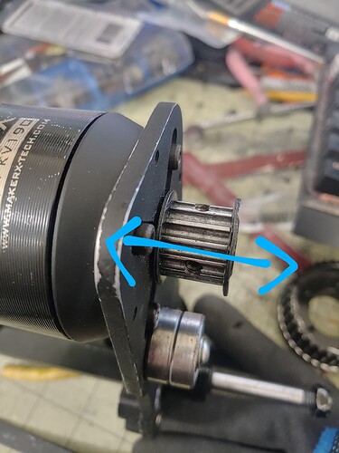

Yeah fair question, but once you see one installed it gets a bit clearer. The key fits snugly but with almost zero force into the keyway in the axle, and a bit less precisely into the pulley. There’s basically no extra friction along the blue axis, it’s not really tightly rubbing against the inside of the pulley
It has very little play in the green rotation axis though. As frame said, the axle pushes on the key and the key pushes on the pulley. For the pulley to slip past, it would have to shear the hardened steel. In the case where it’s just set screws, you don’t have to shear anything you just have to overcome the friction between the stainless steel and the axle, that’s much easier to do and will grind it away quite easily. I’ve managed to smush through m6 set screws, never mind the little m2 or 1.5 or whatever these are

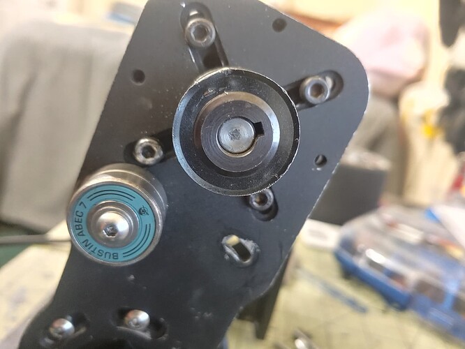

My biggest issue is that the motor shaft does not have that grove reach the end of the shaft. There is like a mm or so at the end which is why it looks round at the end and you can’t see the little indent. Probably would be better to take a photo of the shaft but the pulleys are hard for me to get off.

Yup so the mm or so at the end is part of the design. At the start it looks like this, and you drop/seat the key in the purple axis, then it can’t move anywhere except the way it came in and it looks like pic 2.
After that you slide the pulley on as normal, and it shouldn’t add much if any friction. Now the key can’t go anywhere, the pulley turns with the axle with very little play, and the only way anything can move is the pulley along the blue axis of the axle. There’s very little force in that direction, and that’s what the set screws are for. They stop the pulley sliding off the axle. Obviously that doesn’t seem likely in your case if you have to force them on and off, but they can’t migrate over time or do anything weird under vibration
OOHHH I thought you would put the pulley on and then hammer the key into the little hole on it. Which is why I was confused as to how you’d get it out again :person_facepalming: I figured you could just keep hitting it with a pick and hammer to push it far enough in for it to drop into that groove.

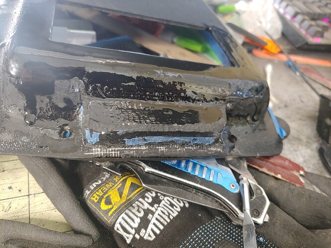

The kit I bought has the 3mm x 3mm as the smallest option available, so if they have too much give I could just grind down the next biggest size to fit it more snug. Or I could just add a thin layer of epoxy to the 3mm ones since that works well. I did the same to the bottom of the motor mount clamp to remove the slight wobble and it worked super well. I may need to eventually redo it in a few months or years if it wears down too fast though.

I need to add in holes for the phase wires and sensor wires and fit in the water proof wire pass through things still on top of needing to carve away extra material on the under side so I don’t have to fit them through an inch of fiber glass and epoxy and like 2mm of abs
