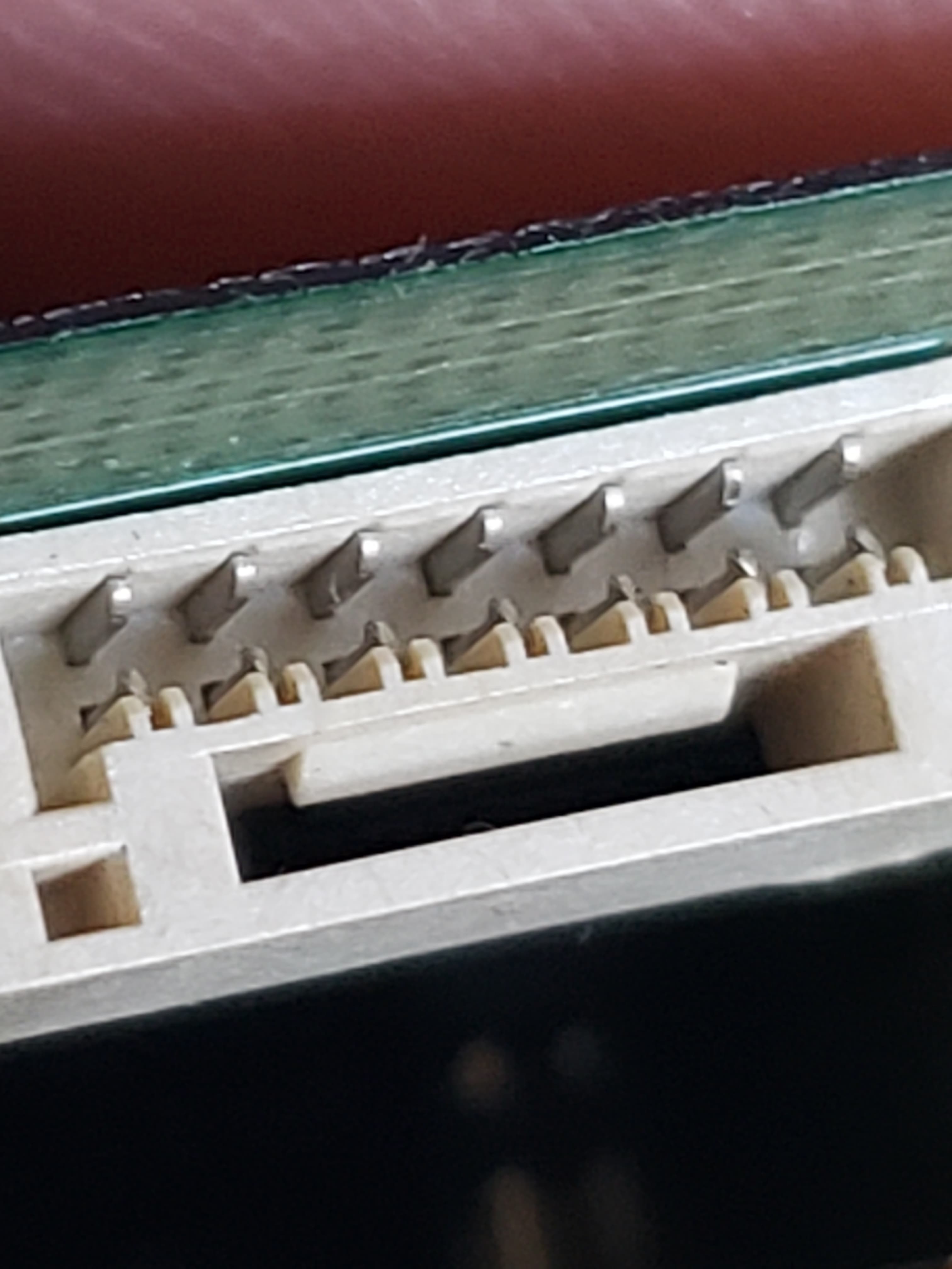

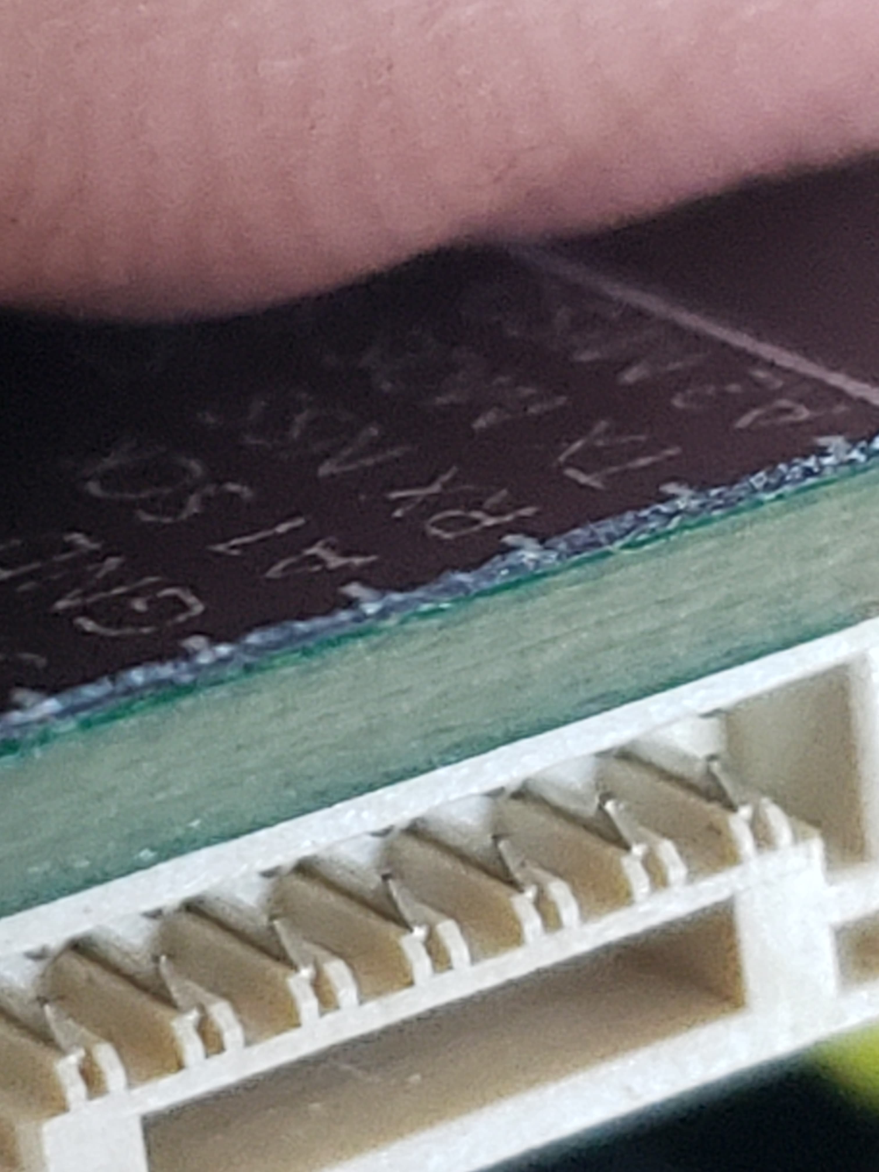

Thanks dood! Problem is, it doesnt seem have to have actual pins, looks like little blades coming from both top n bottom. Got it from @frame maybe you could inform me what kinda piece i need in here? Or point me in the right direction on which vendor i could harass about this cheeky lil guy?
Yeah, that’s 1.25mm. Give the JST GH a try.
its jst gh with blade pin, that’s what the version with secure clip is design for
the top pin and bottom pin are paralleled to ensure even if the connector flex, there is still contact on either side
Oh lala! Thank you both! Then this one here should be a uhh zh, or 1.5mm right?

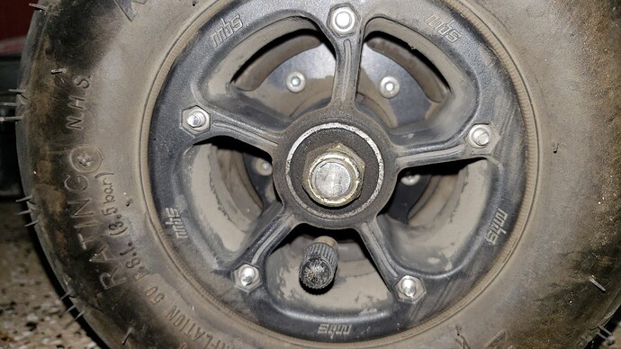

Does anyone have tips for getting the wheel off these 3dservisas gear drives? I can’t undo these bolts by hand and there is no way to fit a drill in there, I am bending my hex set trying to get these loosened. I didn’t install these so If I’m missing something let me know but it should just be those 5 bolts in the back right?
Can you take the axle nut off first and take the whole wheel off?
In the future, the wheel hub should be assembled so that the 5 wheel nuts are on the inside of the hub :upside_down_face:
Nope, It’s just as stuck with the nut on or off. @Skyart did the install
Oooof, there is no thread locker as far as I remember not sure why they so tight
So there’s no way to get the hub out of the way so that you can get closer to the bolts?
Yeah might have been an oversight on my part, havnt really had issues getting those off tho :dizzy_face:
