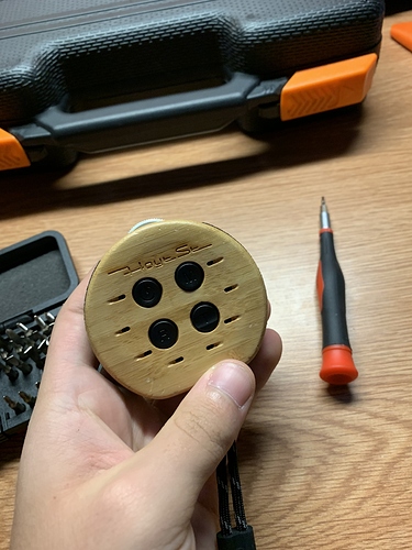

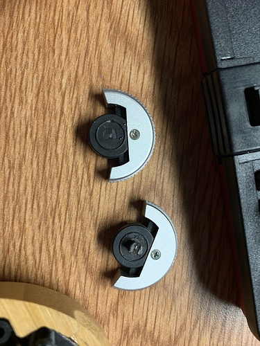

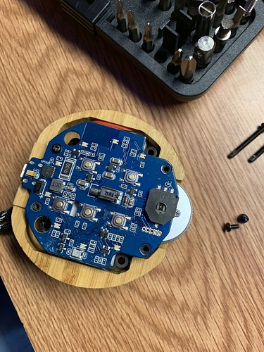

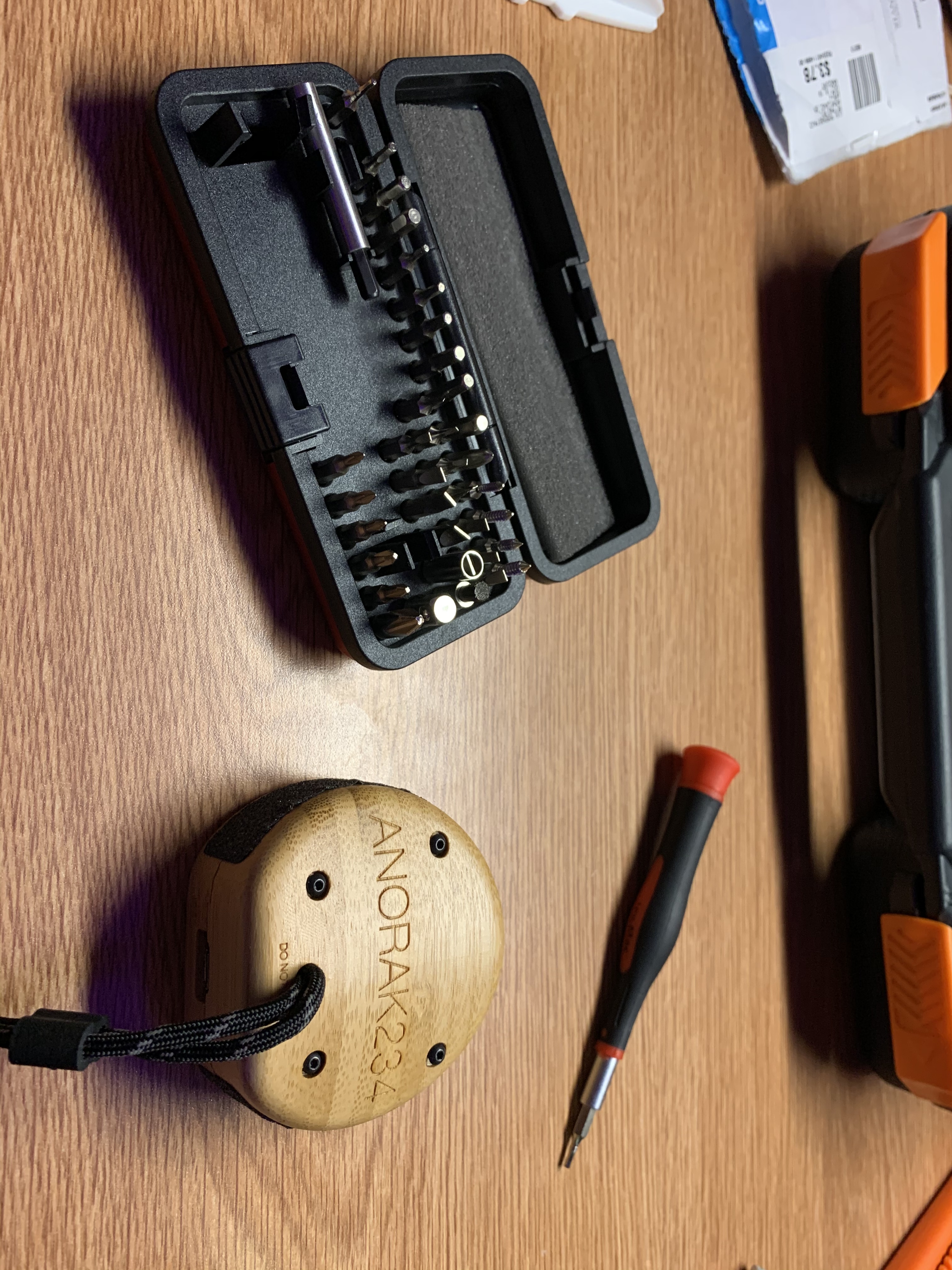

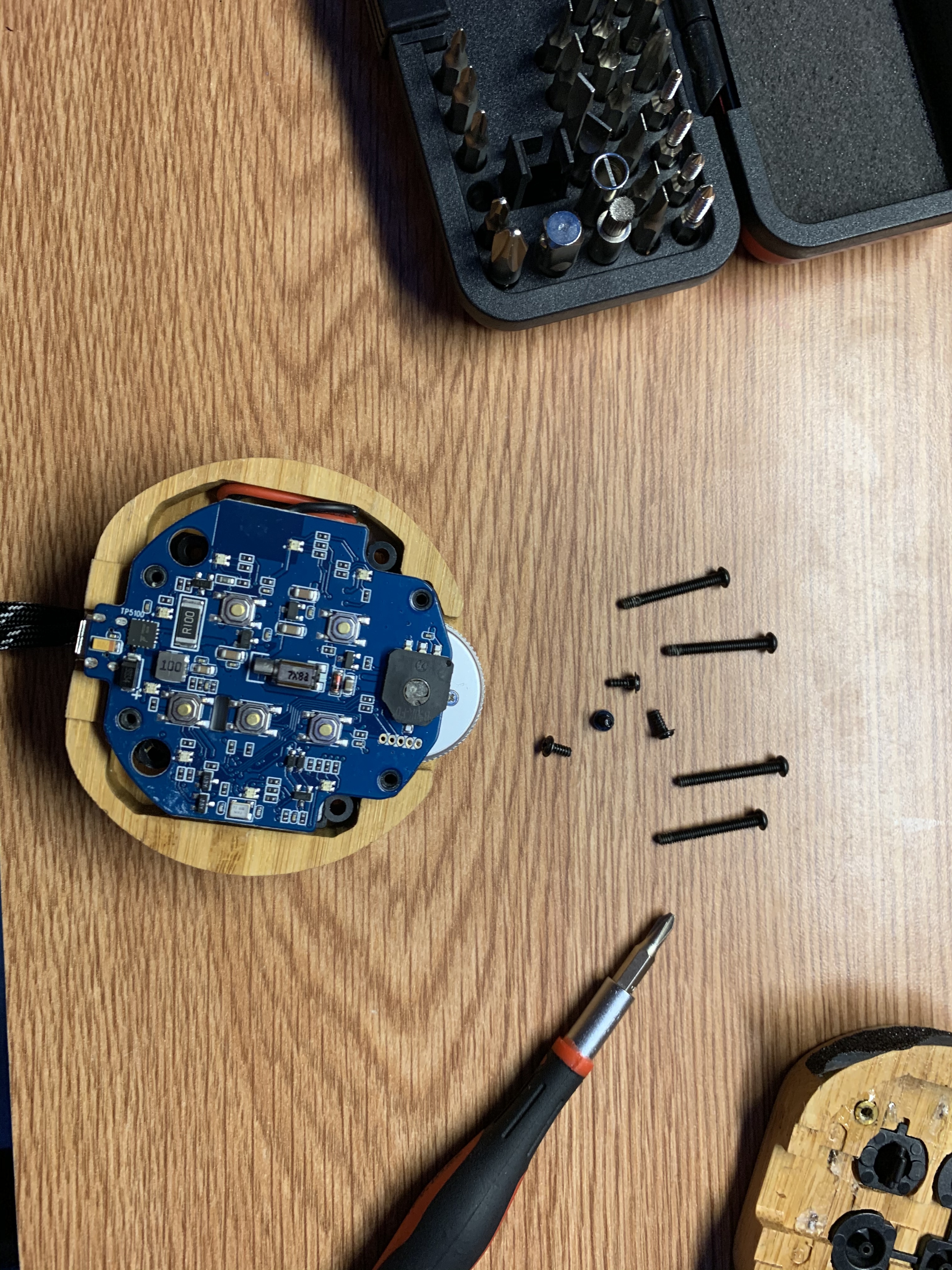

So I fixed the remote:
But then the remote started having connection issues of all things. So I’ll be sending out another email to Hoyt. They were very kind and responsive with the thumb roller though.

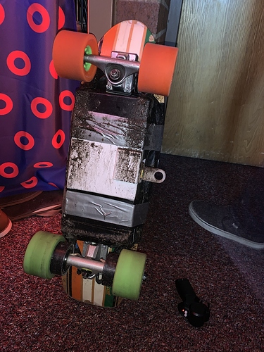

Anyways I got a mini remote from @Argent and also duct taped the board bc I got tired of dealing with bolts every time I opened it up.

Great build but the only things that bums me out is that it’s premium stuff, Hoyt remote, carvon motor, 2 focboxes but the battery is only a 10S2P in 30Q
It’s dragging the whole board behind : you should get VTC6 or switch to 21700 cells to get more discharge ! Or a bigger pack but it would kill the small board vibe
I would love to upgrade this board and get a new sleek enclosure that isn’t half duct tape. Unfortunately covid forced me to leave it behind in Colorado. If school opens back up I’ll be able to use it and upgrade it again.
