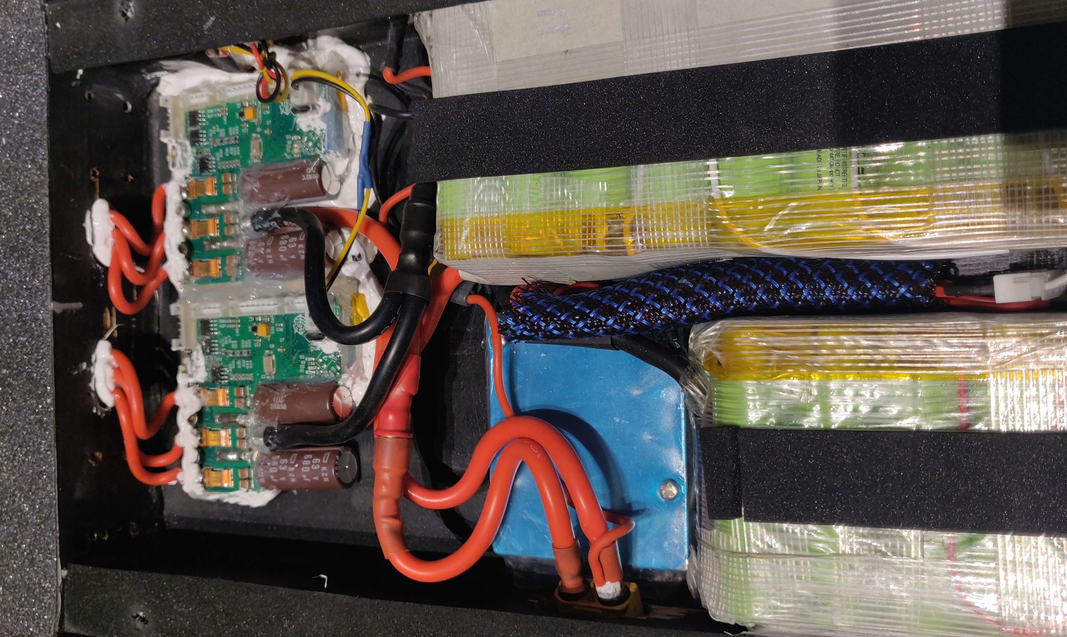

Nice, but your motor wires seem way too long haha, but that’s just aesthetics.
kinda yes, kinda no, it looks like they’re too long, but it’s needed for slack when turning
also, I didn’t want to open them up to run silicone from inside the can so I shortened the original phase leads and added silicone, i left the minimum possible of the original leads without it causing kinking issues.

No worry with the motor phase leads snagging?

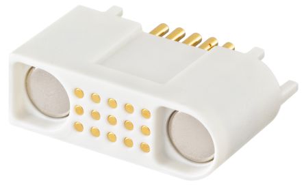

These mag connectors are on ali for a fraction of the price, I got one similiar to the two pole one you linked and it held what was promised.:slight_smile:
Edit: Okay the multipole ones are still purdy expensive

Still trying to decide whether to skin or paint the lid, I will redo the deck as well to match
went for a few rides already, waiting on some longer bolts to accommodate increased height, still need to pretty up the lid
motor wiring finalized

loopkey mounted
I like what you did here! You used bullet connectors instead of MR60/90 - makes the build so much cleaner! I’ll do that next time too. Where do you actually get your cables and shrink?
