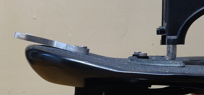

rear XThing converted to bumper/stand
rear binding added, mouted through truck
I would say your deck could get damage if that was ever hit off anything + feel it looks wrong with obvious bolt holes sitting in the void.
A 3D printed part maybes? Or car door seal per the norm would be better with the x-thing on all 4
Ps: Anyone with ocd will hit you
lol getting a normal bumper around dat phat azz is a struggle, I’m gonna insert round rubber bumper thingies through the exposed XThing holes, so it won’t be hitting aluminum, also because of the rear tail curve an XThing doesn’t sit flat on the deck normally and that bothered me more cause that felt like I was damaging the deck
also the XThing allows me to maintain a perpendicular bolt angle, I dig into the xthing
Completely understand the x-amajigs are jewels. Bend it in a vice Max, a manly man’s vice not a desk vice. If you do it a little at a time it will work fiiiine.

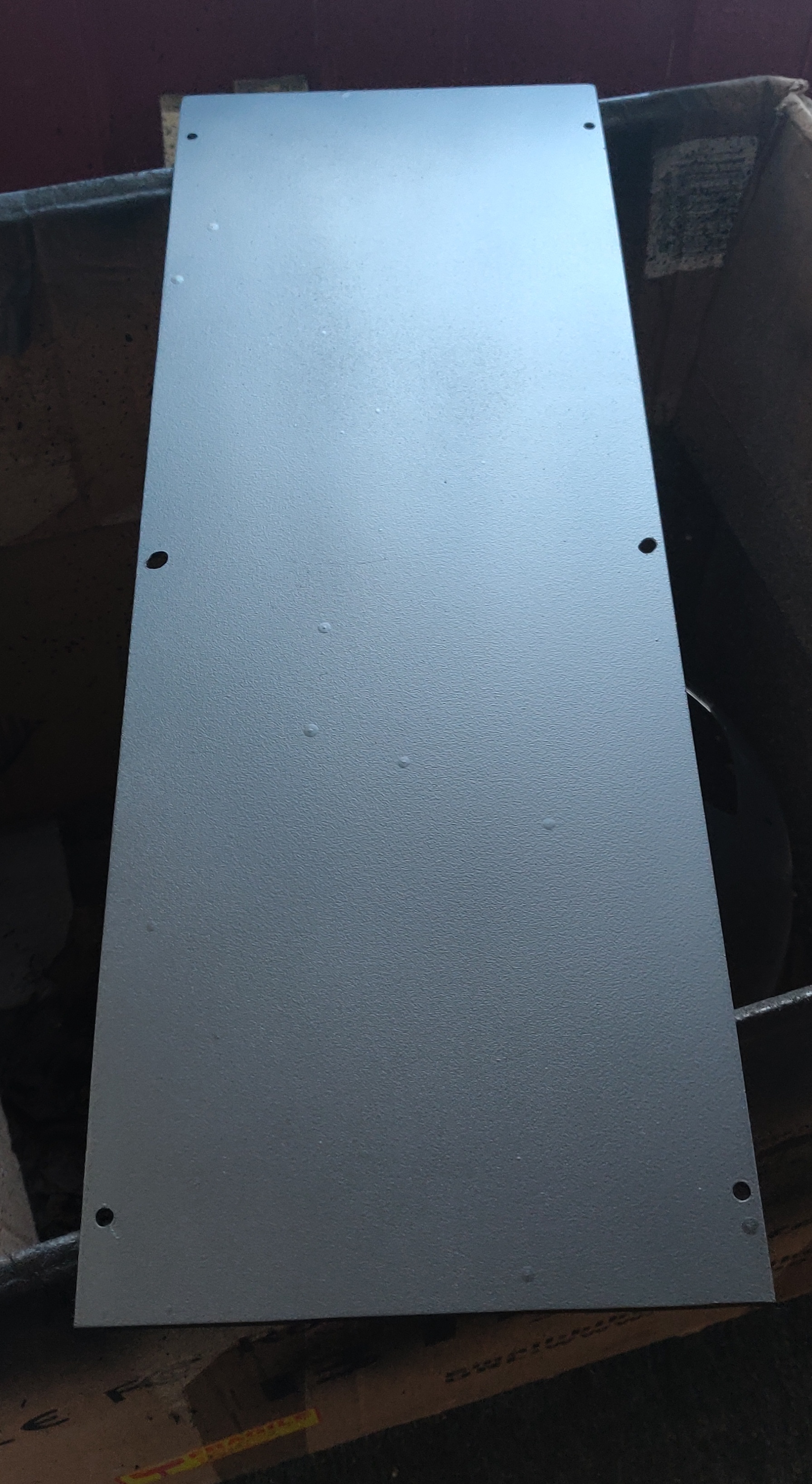

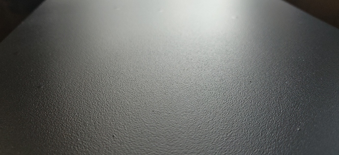

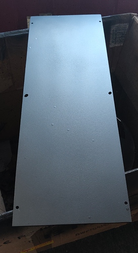

Lid finally painted, I’m gonna do the whole deck with the same spray
https://www.brownells.com/gunsmith-tools-supplies/metal-prep-coloring/paint-finishes/air-cure-aerosol-paints/aluma-hyde-ii-prod1117.aspx

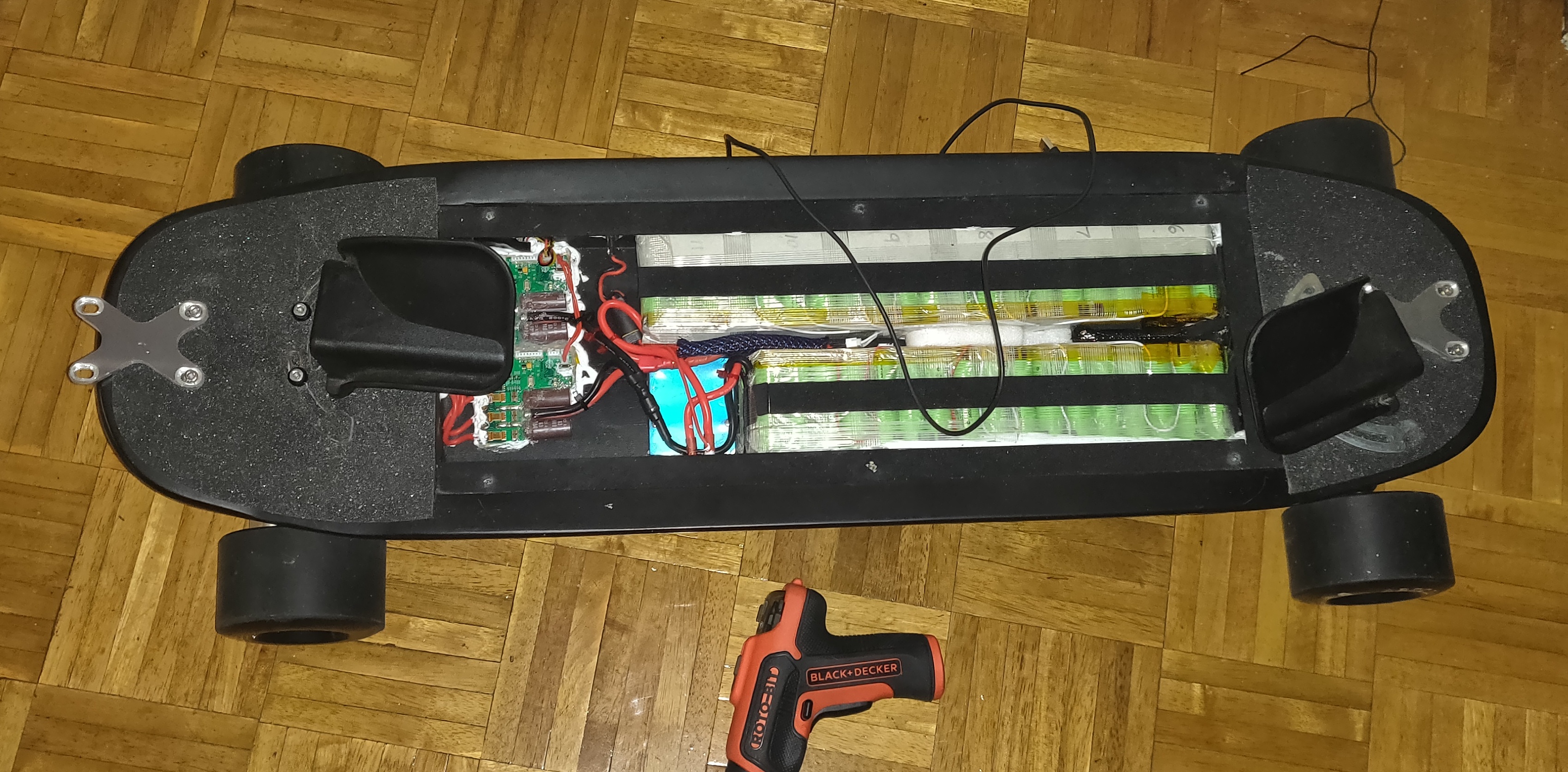

Decided to go 12S, will be 12S4P 30Q inside the deck and a 12S3P 40T top mount, making 24Ah total.
Gonna be fun :grin:
ok plans changed a bit, gonna be a 12s8p 30q with a hump in the lid to accommodate the extra 12s4p
Oh no :open_mouth:
Man, are you sure you want the uglybox on top? LoL.z
It won’t be a box, just a raised portion in the lid
Raised portion will be about 40mm high
