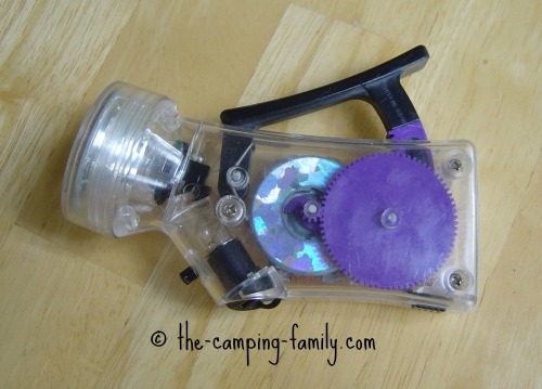

I assume there will be little bits of magnet stuck in the stator? Will you just use a bigger magnet to get them out?
squeezehandleflashlight
Shit sounds like one of these
Nope. It was all epoxied up…
Ahh you did the stator too :+1:
