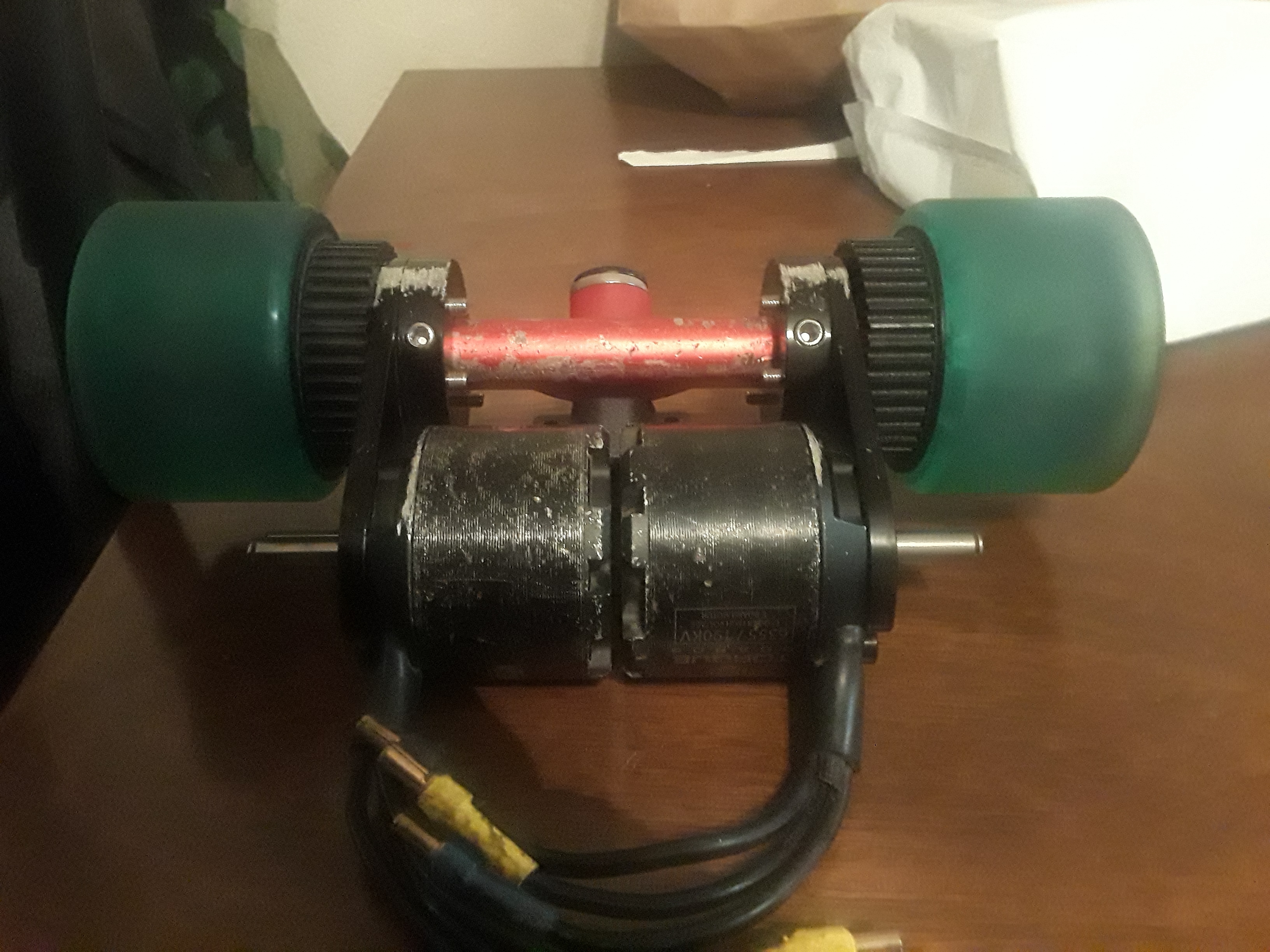

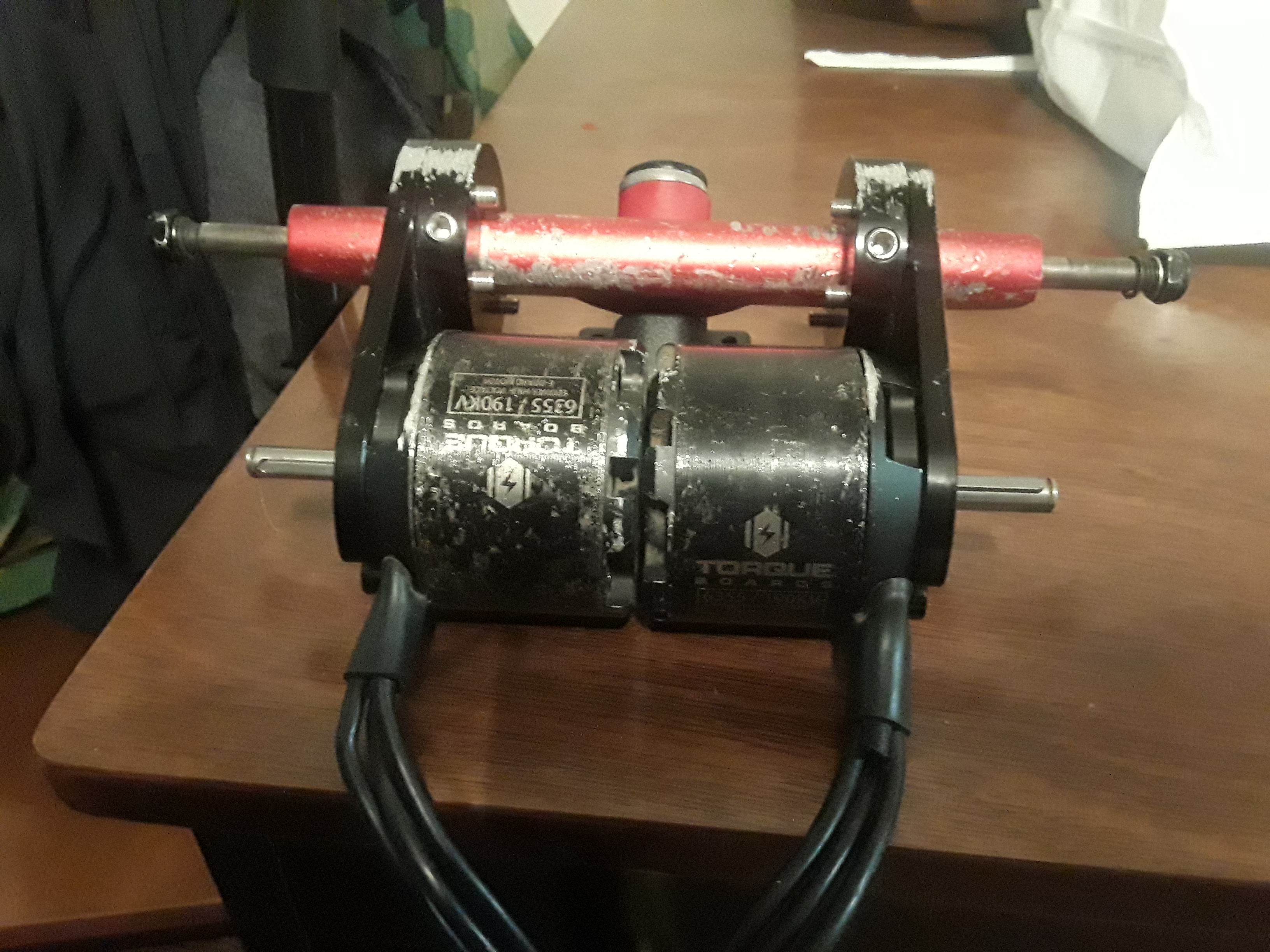

I’ve got some motors from esk8 Jesus himself with a lot of miles. They still run but I think they deserve a makeover.
I guess? What I think I’d do is use really thin epoxy (possibly on a warmed-up motor to further thin it out) spinning to sling it out under the magnets, and then once that’s cured, then smoosh some thicker epoxy into the gaps for added vibration resistance.
