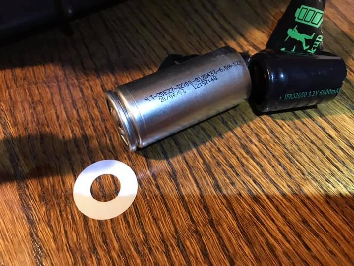

if you really want just the cases that bad I’ll order 2 right now, though I don’t know if it’ll get destroyed to get the cells out
lol just pour some iso in?
maybe something stronger idk what breaks down silicone

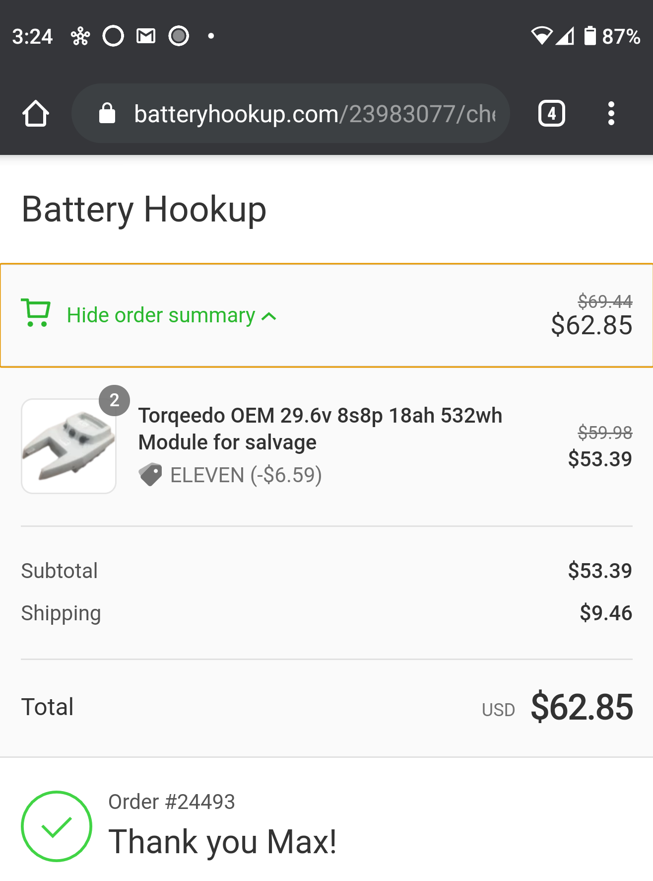

Sure if you just want the box from them
Any coupons I should be aware of?
eleven
hmm we should prob start using eachother’s codes then use the money to get more batteriez
There’s a mail in rebate for beer?
Oh you mean him haha

For the price that it’d be shipping private party (can’t get a good gauge of the size/weight) vs just buying the whole pack from BHU, it might not be far off to say that you’re buying the case and bms shipped, and getting the cells free.

Crap, I think I’ve talked myself into buying a pair…

haven’t seen molicel on BHU much
Yeah weird they pulled a molicel on us, the density is good for lithium iron anyway. I have 2 12s4p’s going into a hummie and a killshot.
Uhm wrong cells…
These cells are used in laptop batteries, I’ve salvaged 100s for my powerwall, not suitable for high amp at all
Damn why they put low discharge cells into a freaking boat motor
