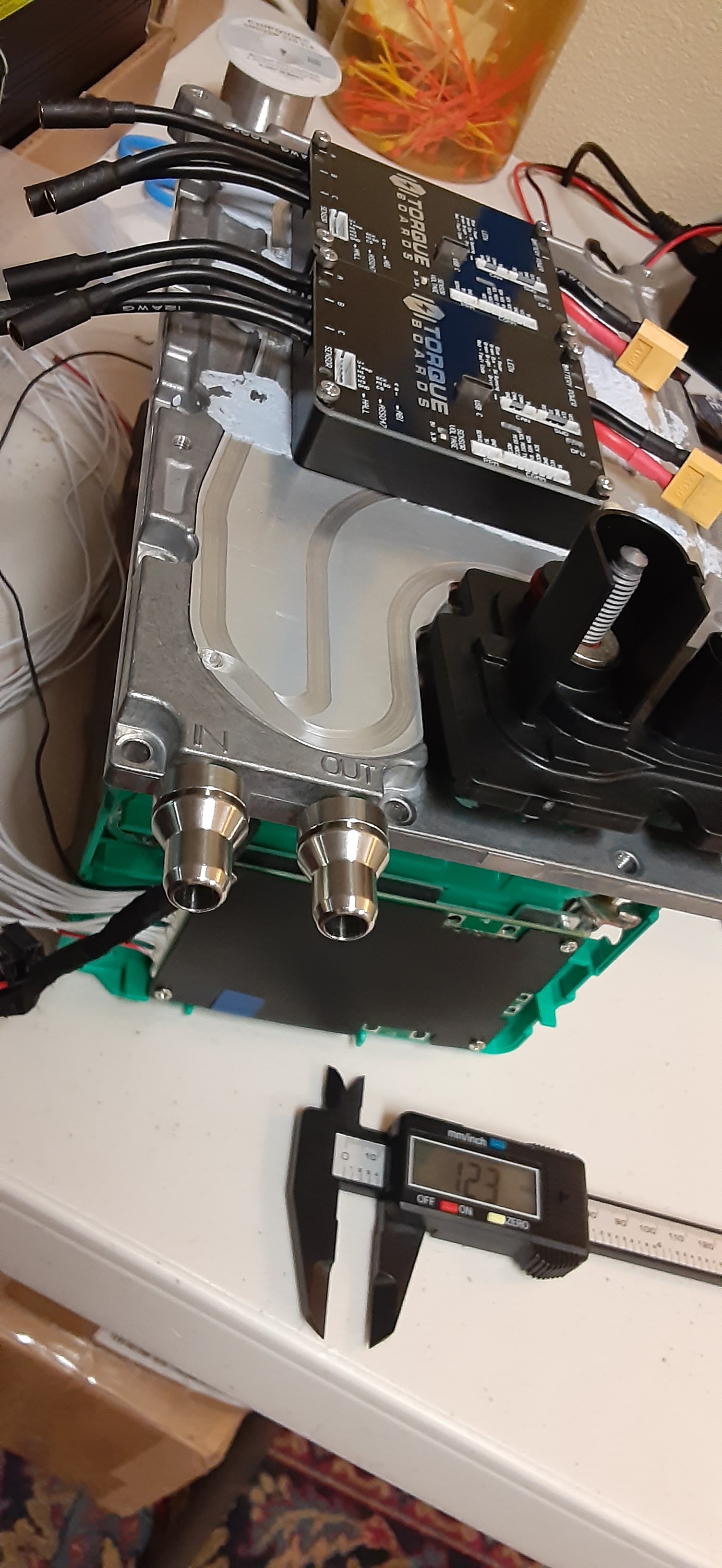

I would rather invest my time into trying to make the world’s first water-cooled Esk8.
ha. to cool the motor? gunna have to be a tiny motor to be worth it. but i have a hole in motors i make with that possibility. with the hotter hubs. one day we should figure it. one day i get tires, wheels, and hangers finally here
nah the battery and ESC. The alu case has a “water cooling”(some liquid) loop in the top and the cells all have heatsinks that touch against it on one side. The esc’s just touching the alu case would technically be watercooled.
Motors too would be sweet but unless I get one of the E-foil motors “they”(China) don’t have anything usable or affordable.
I think their LIFEP04 32650 cells are a bargain… Perfect for top mount batteries.
I’ve been thinking of the same thing. Reason being is: there isn’t any perfect options to cool a bottom mount ESC. Sure, you can have a heatsink protruding through the bottom, but this is less than ideal because it won’t be as strong, and is more susceptible to being pushed in from the bottom. If you run them hard enough, all internally mounted ESC’s without ventilation will overheat, and water would easily solve the problem. You wouldn’t even need that much- the smallest PC radiators, maybe only 4" across, would be more than adequate to cool our ESC’s.
I’m going to eventually explore Flipskys water cooled options.
Golden Motor is a cool company that has water cooled PMSM’s, but none small enough for esk8.
cant you just add a big strip of copper sheeting to the esc while it sits in the box and let some airflow in? seems a lot easier and safer than going with water. could even be really thin or whatever shape to match the space available. can just cut it with scissors. i dont know the best way to attach it but surely worth trying before going all the way to a water-cooling set-up.
The water would be just for the meme, this alu box is probably more than effective enough with no water.
Exactly what I looked at.
This is how I’m planning on doing it for now. BMS inside the case and ESCs directly on the water-cooling loop. The phase wires would go out where those fittings are so if I wanted to add water cooled motors it would be set up for it.

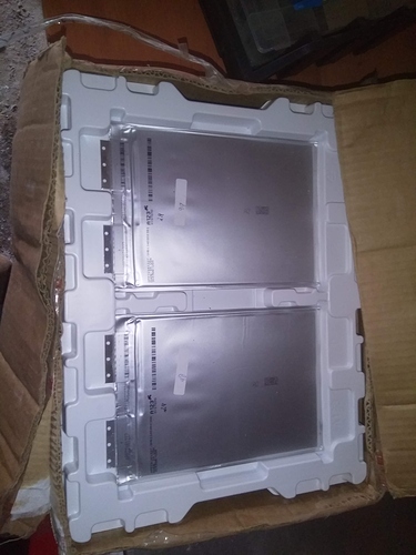

These A123 pouches look pretty good actually.
