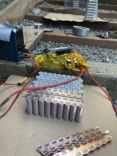

This is my reference chart. In the past I have built quite a lot of 21700 power tool battery’s. All with 15mmx0,2mm on positive and negative terminal.
Should be sufficient for 30A continues.
In my experience the do not get hot at that load.
Yup. They make building high power battery much easier/faster

if the slot in the pcb is to narrow for my liking i double it up with another sheet of nickle from the outside. Not as Clean but it works. if you only pull 30A you might get away with a singel layer of 10mmx0.2mm
