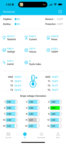

Take, for instance, my most recent attempt. I built the battery, started charging it, checked back when it was about 50% charged and found that p-groups 1-10 were charging, but 11-15 hadn’t budged. Somehow I managed to get electrons to flow from high to low potential while skipping 5 p-groups. Isn’t that literally fucking impossible? Can anyone tender an explanation or did I break physics?

Does the multimeter agree with the BMS?
If the answer is yes to both questions, some groups must have a different capacity than other groups.
Definitely check manually with a meter, it’s more likely that the BMS is bugging out.
Yes to both questions.
I would have had to accidentally aligned all of the cells with a different capacity into p-groups 11-15 in order to get this result if differing capacity is the issue.
On JBD BMSs, if the balance wires are connected before the B- wire, it gives low readings for some random number of the p-groups, could that be it?
I checked the p-groups. They match the bms reading.
Do you charge through the BMS? Maybe it´s balancing is faulty and keeps P11-15 from charging correctly.
I am, but I don’t think that’s possible. If I understand correctly the BMS just checks to see if any of the groups reaches 4.2v and then turns off the charger. It can’t actually delegate the charge. If a current is passing through the entire deck, then all of the p-groups should charge until one hits the upper limit.

Do both your charge and discharge connectors measure the same 55.7 V as the BMS is showing for the total voltage?
I’d just be worried you somehow created two separate circuits for part of the pack, and you’re charging one while measuring the other. In that case, you could end up overcharging the circuit you’re not measuring.
Also, what voltage were the cells initially at? I’m assuming they were around 3.5, so 1-10 charged ~0.3 V, and 11-15 didn’t move. That really seems impossible. If you didn’t say the multimeter confirmed, I’d bet almost anything it was the BMS pins being in the wrong spot or something.
