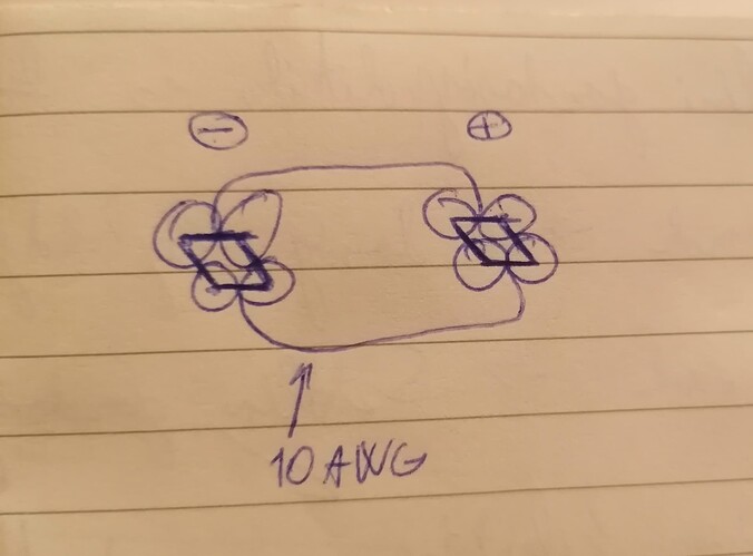

My plan is to build a 12s4p p42a pack.
Im going to use 0.15mm thick nickel (link for reference: 1 meter nickel battery soldering strip 26.2mm*0.15mm - for 21700 - Battery solder strip - Accupackaccessoires - Battery accessories | NKON)
Im going to connect the P packs in series with two pieces of 10AWG wire.
Will this be sufficient for the high current?
I’ll attach pictures of the layout, don’t judge my drawing skills
If there is space for improvements please let me know
I’m not sure about over seas, but last time I paid that little for nickel strip, it was fake as a $3 bill. Other than that, I see no issues in the diagrams.
What kind of spot welder are you using?
2 12awg connections is more than enough. 10awg is too bulky.

Is it safe to solder the cable onto the nickel after it has been welded to the cells?
Pre glob on the nickel where the series connections will be. Spot weld the groups. Then go back and apply the series connections. Either way you’re putting heat to a cell. But with this way, you don’t have to put as much heat as you would with soldering everything after you weld.
