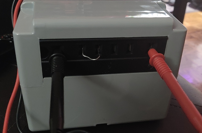

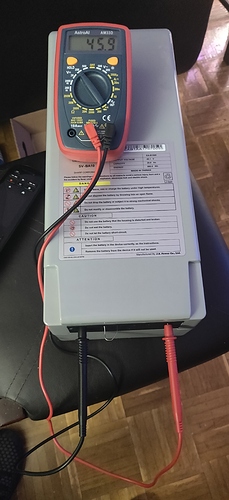

here’s how to enable discharge
it also enables the charge port
just short the first 2 pins from negative
