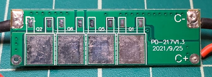

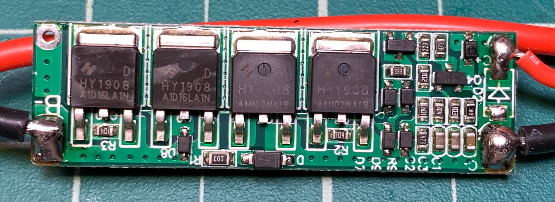

Looks like two pairs of MOSFETs in a back to back common-drain configuration with the battery to charger ground direction bypassed by a 10k resistor and diode. The diode path is probably meant to tie their sources together so all 4 gates can be driven on the charger side.
It’s a really shitty lowside loadswitch probably meant to protect the pack from overvoltage or undervoltage on the charge port. Probably also doubles as an antispark on the charge port.
I can only guess the transistors you see there are a rudimentary comparator circuit.
I don’t know if there are components on the other side.
there isn’t anything on the other side

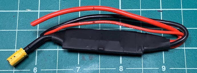

The module that @frame sacrificed for the cause arrived an hour ago and I should be able to dive into it tomorrow or the next day.
The heat looks localized to the point where the three wires connect to the module? Well, mostly localized there.

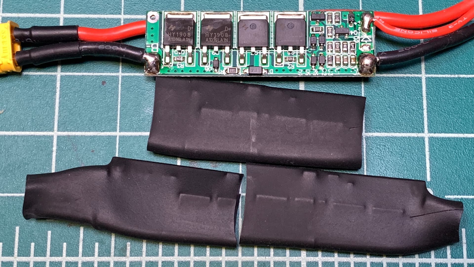

No time to start any testing yet but I wanted to post photos of the module @frame sent me. Seems they only had one length of heat shrink available. :joy: To be fair though it does provide double the thickness of protection for most of the board.
PNP and NPN transistors with lots of diodes and odd-valued resistors leads me to the same conclusions as @Gamer43, comparators for under- or over-voltage protection.
I don’t know if it provides any anti-spark function but if it does it uses a slow turn-on of the FETs to slow the inrush of current. It does not have a power resistor to do that job via a secondary channel for the current.
The third (red) connector pin/wire just provides power to the module so if using just a standard 2-wire charger the board will not power up and you will be prevented from charging.
