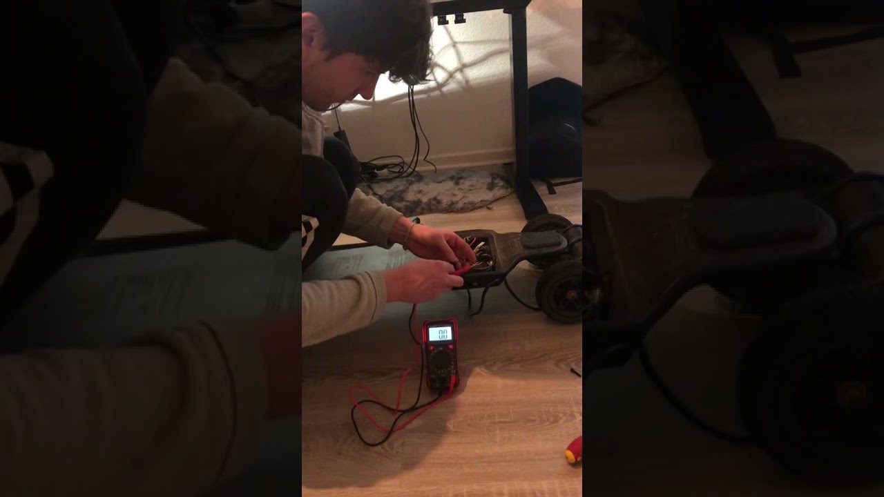

50.3 is still perfectly acceptable for a 12s pack, probably just the pcb is acting up
Yeah I’m pretty sure it’s the pcb. The voltage seems kinda low, idk if it’s safe to say with the voltage or if 49 is perfectly fine.
The thin I’m sure about is that it sparked pretty hard when I plugged in the charger on the day it broke.
That’s the inrush due to huge voltage difference, how low was ur battery when u plug it in?
On the last Bar of the Board Battery on the Remote. But when I measured it today, it was on 40 when measuring with the multimeter.
Hmm it should still be ok, but I will let battery expert chime in
Could that be what this board is supposed to do?
It’s possible. I reached out to my friend who is close to meepo, but it’s like the middle of the night there
It’s the charge port antispark. Ypu can bypass it but probably shouldn’t
