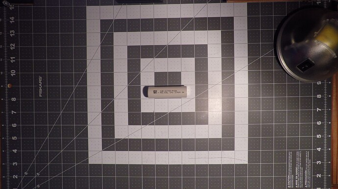

Any videos of someone building a battery for a single stack eboosted enclosure? Just wanna see how other people designed their packs as im going into this mostly blind
What config? I don’t have a video but I can help.
This angle ain’t that bad right??? I printed a 200mm mount that sticks to my wall…
it does need some lighting though.
Also what settings would you recommend?
  • 1080p 60fps
  • 1440p 48fps
  • 2.7k 30fps
Don’t know the specific layout, but I’m maxing out my 40" evo SS enclosure with 12s4p p42a.
This might help if you haven’t seen it already, it’s from the product page:
I have seen the picture, I just wanted to know what to expect from actually doing it
