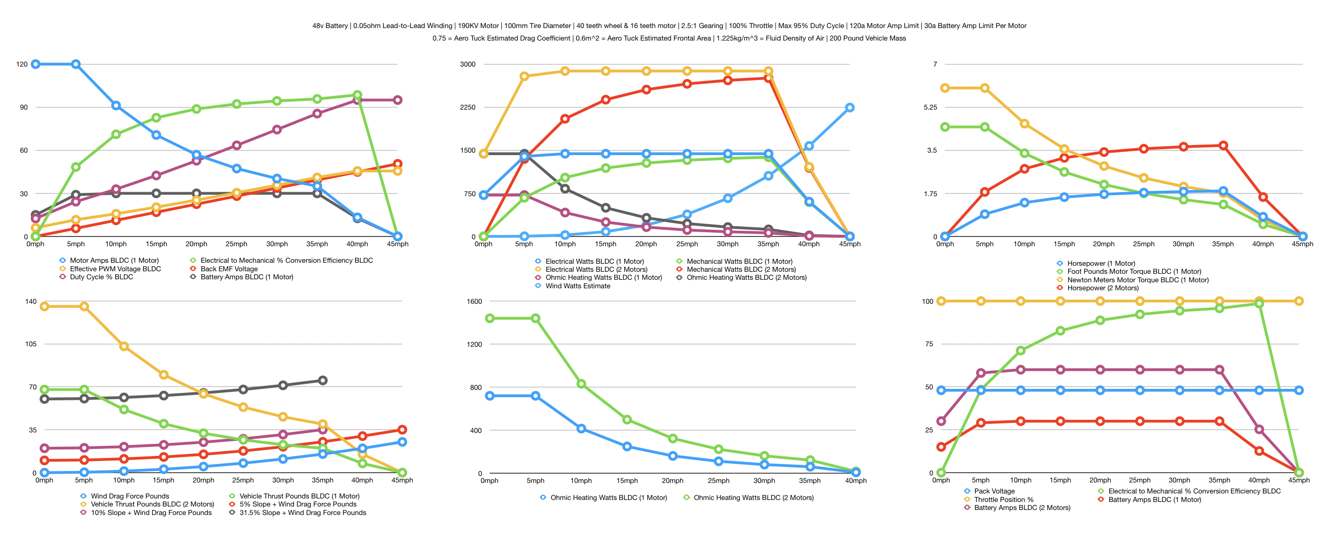

this chart shows 48v, 30a bat limit setting per motor, 120a motor current limit setting per motor, 190kv, 100mm, 2.5:1 gearing, 2 motors:
^you can see from the bottom left chart this board will do about 40mph on flat ground and about 35mph on a 10% slope, and about 20mph a 31.5% slope.
blue and black lines top left chart show the motor current (blue) and battery current (black)
the downward slope of the motor current (blue line top left chart) during acceleration is caused by hitting the 30a battery current limit at low rpms.
the drop in battery current at the right side of the chart is caused by hitting 95% duty cycle and then continuing to accelerate (the bemf voltage prevents drawing significant amperage)
edit: i updated the chart because i originally had the wrong vehicle mass inputted.

In the case above, the rider wouldn’t be able to draw above 60a motor while above 20mph, even if they set it higher, because of the 30a battery limit setting.

Where did you pull this value from? I mentioned no battery limit setting in my case.
Merely to illustrate how a battery current limit affects the motor current limit.
If there was no battery current limit, the motor current will be a straight line across and the battery current will be a flat ramp that almost meets up with the motor current line at 95% duty cycle.
Another interesting part of the graph is where the red line crosses above the yellow line in the top left chart. Thats no load speed where the back emf voltage produced by the motor starts to exceed the max effective voltage at 95% duty cycle. The motor can’t go any faster than this rpm under its own power.
