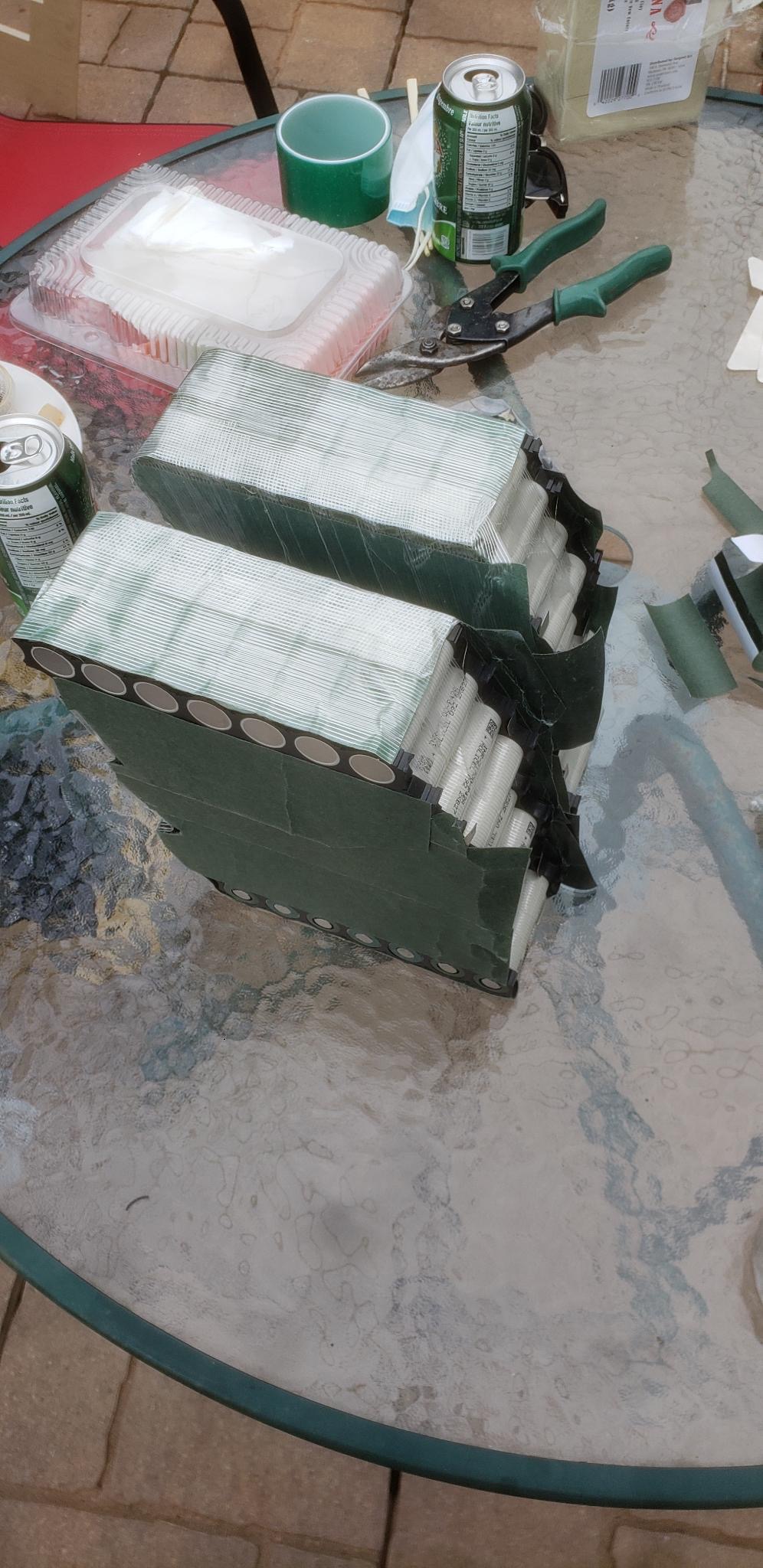

I ended up building a P42A 20S7P for this thing with the bms bypassed. The pack is triple wired with 12 gauge xt-90s, the 2 halves are jumped at the bottom with 2 8 gauge pieces which haven’t gotten warm despite the engine and controller. Also did the mid-tier crimps and triple wired the controller. Width wise the battery barely fit. None of the wires get warm which is an improvement from before, the pull is drastic. I’ll try and get a good acceleration stat, whenever I’ve been riding it just been busy crapping my pants.
