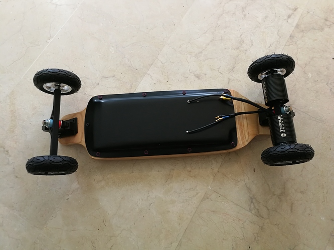

Working on it probably finished next week :wink:
Looks pretty and slick/clean to me! Thanks for the update and keep up the nice work!
Thank you! I’ll post updates here once the build is finished.

Some more pictures:
Next steps:
  1. Find a sorter kingping that fits well on the @mikenyc adjustable baseplates
  2. Make a mini-kydex sealed enclousure for the connections
  3. Put some glass frit
  4. Route the deck to insert the Unity power botton and charger port in this plates (the ones with the holes) that @3DServisas is making for me. Same as @rey8801 original ChooChoo deck postion.
  1. Find a 44T Kegel adaptar that fits on my Evolve GTR and also fits on this @Janux-esk8 hubs, so I can swap wheels between this board and the Evolve without changing anything else but the wheels on both boards. This is the Evolve one.
Working on it!
