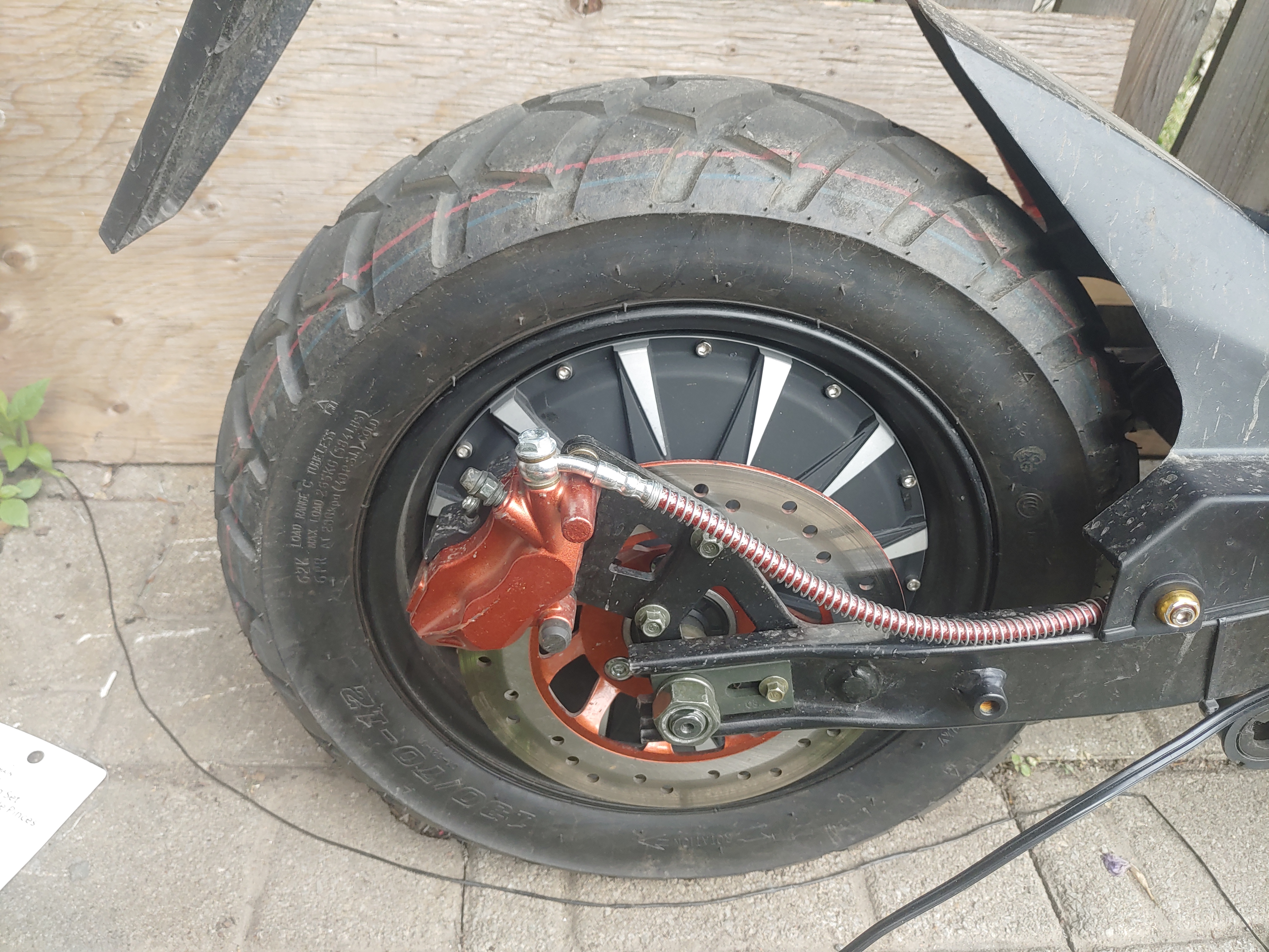

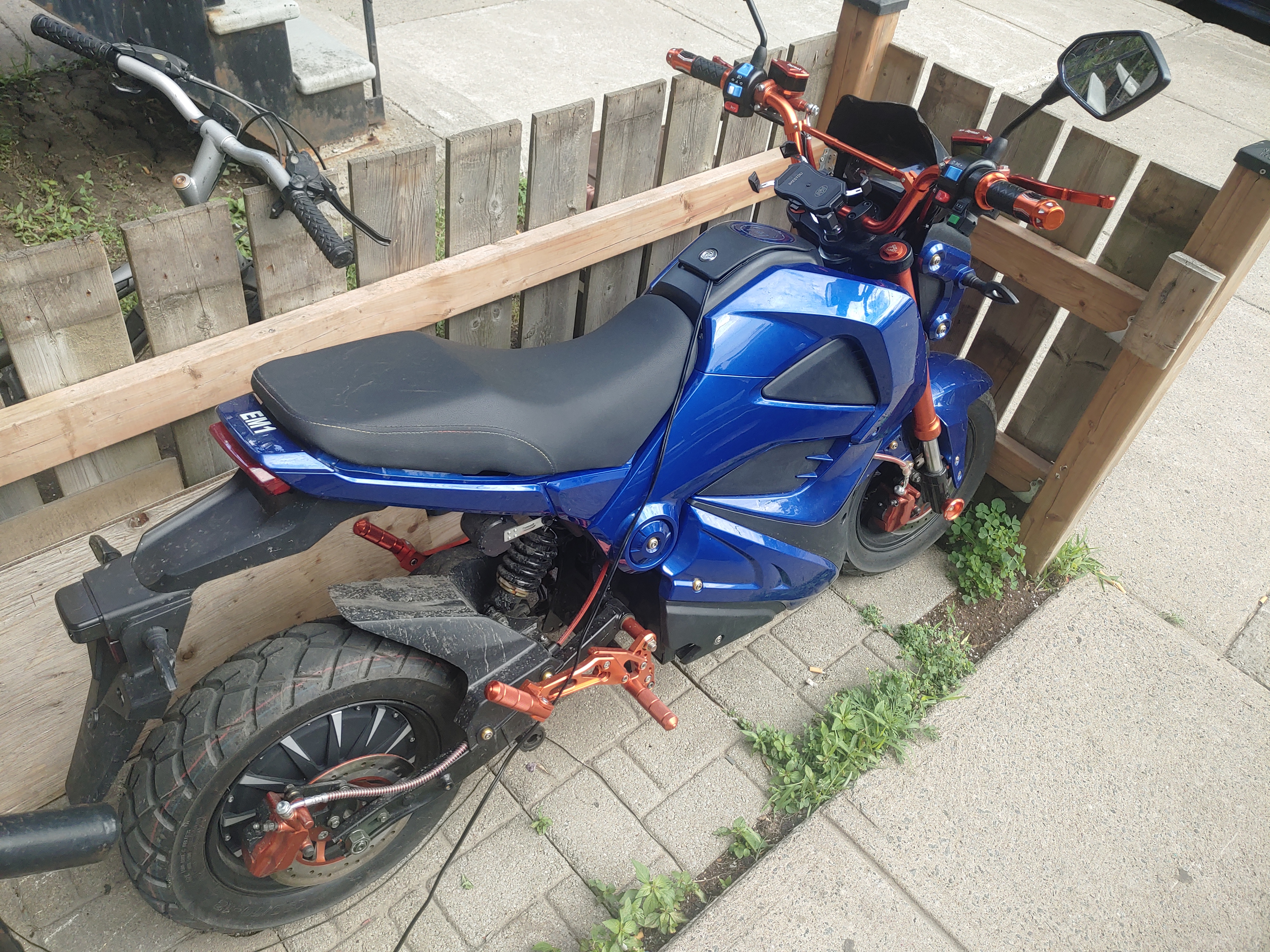

Here’s mine. Just changed the stock 500w motor.
New 3000w is a freaking beast. But it was a real bitch to install. Had the push out the frame to fit the axle. Had a lot of grinding to do to make it fit perfectly and realign the disk brake
Oh and when I say it’s a beast…well I mean it’s a real motherfucking beast :joy:
:hushed: What voltage are you running on that?

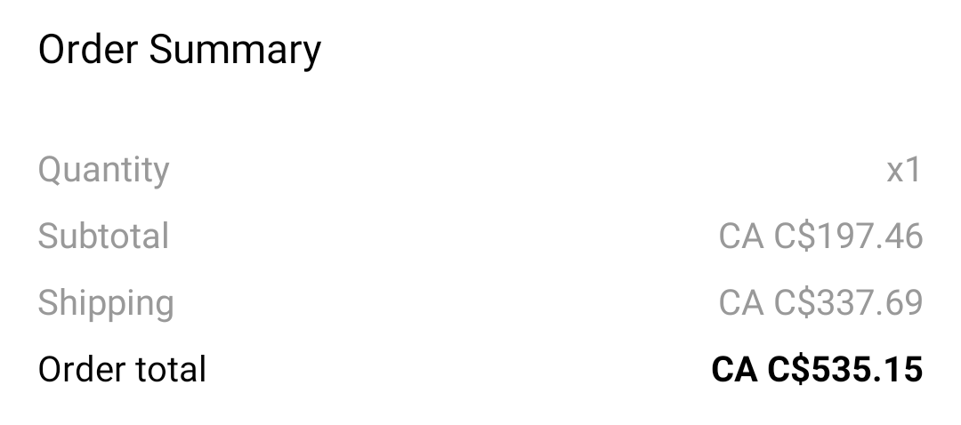

Where did you buy the hub? is there anywhere cheap to get those?
I feel like shipping any hub from PRC cost the price of the hub or more.
@DEEIF running 72v

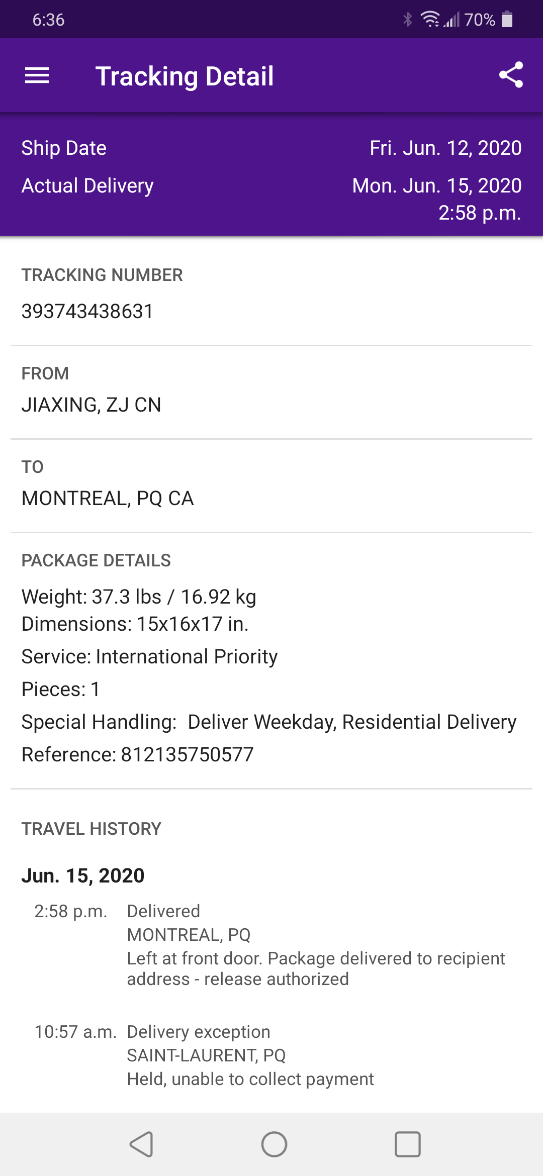

@Fosterqc bought it on AliExpress. And yes shipping was expensive as hell
But on the bright side I bought both my hub and controller from this seller in 2 different instances and they shipped em through FedEx. Got them in 2 and 3 days

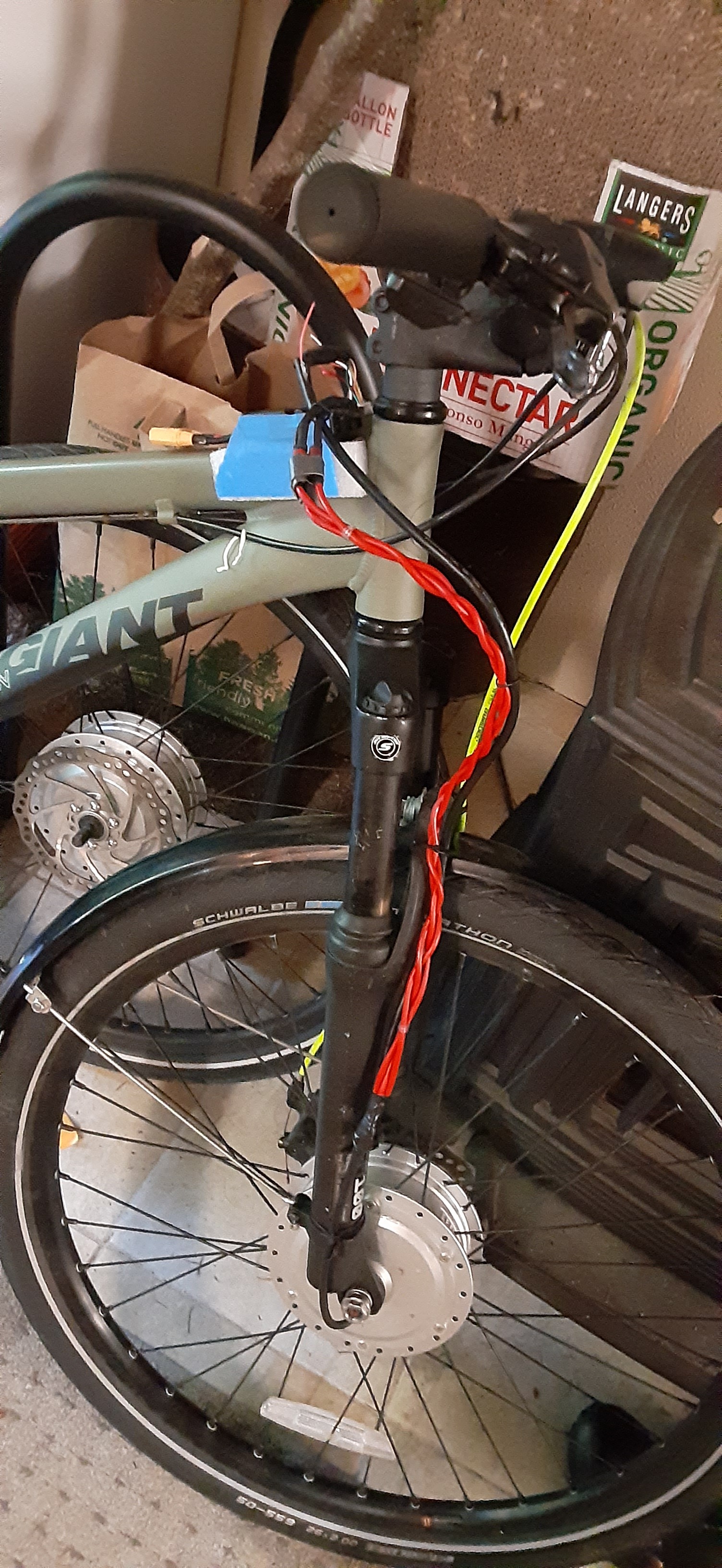

It is somewhat ready to program and test!
I don’t have a bike bag so I’ll need to make a battery box mount of some kid.

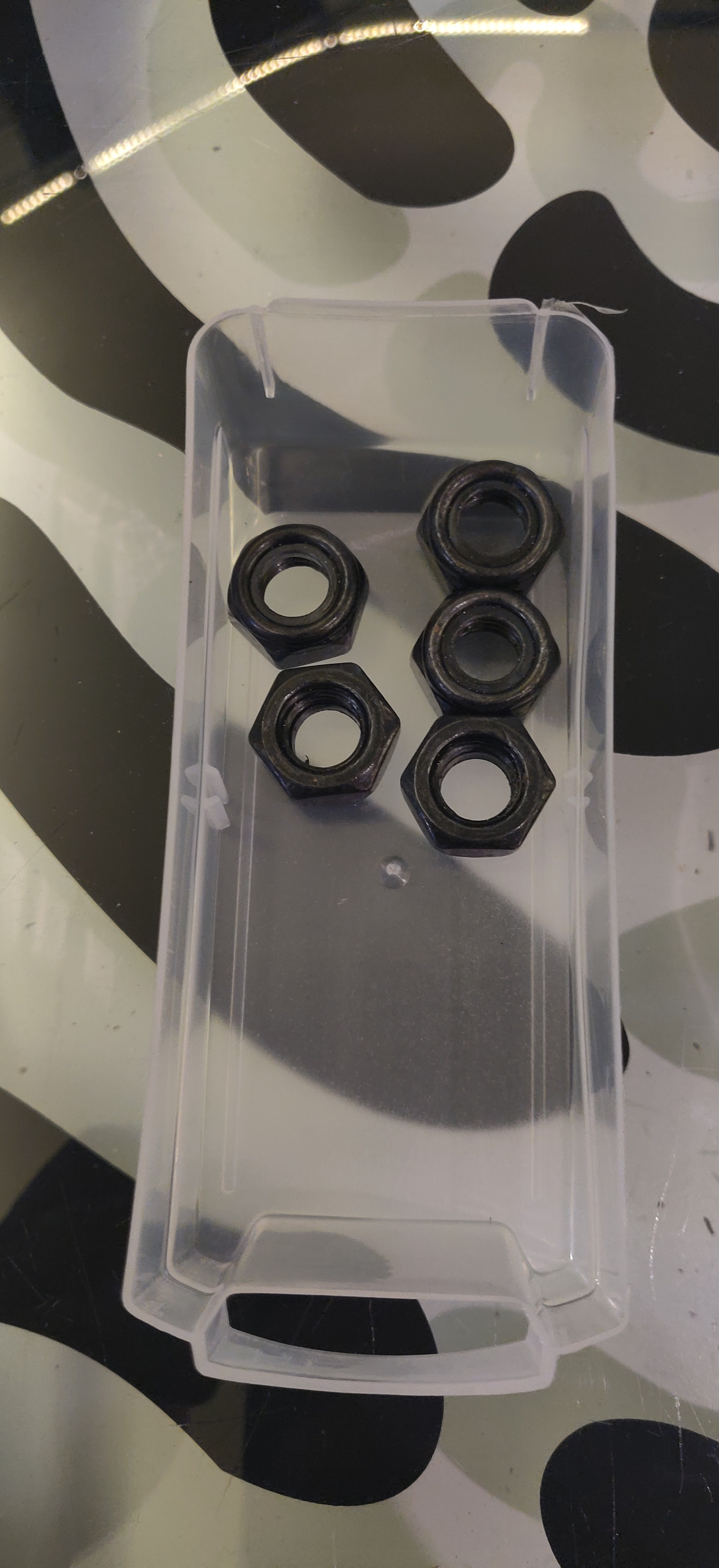

Did those lock nuts fit / thread on properly? I thought they were M12 x 1.75 versus the M12 x 1.25 that the Bafang specs linked previously said it needed.
Great3
that I don’t know… haven’t tried em yet, just got the torque arm will be playing with it later and check

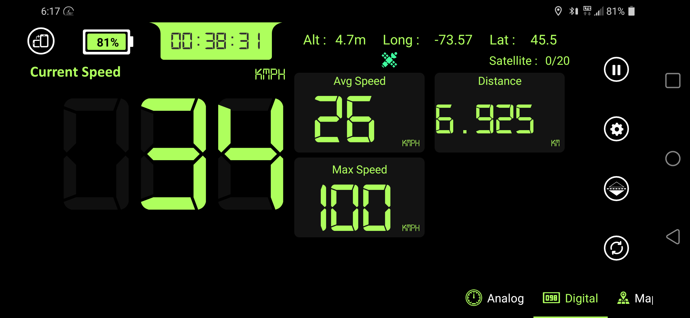

That’s gorgeous affff. I don’t understand why not just get a ninja or something for way cheaper if you want a sporty little rocket like this, that’ll go way faster and still looks badass. Just isn’t electric and quiet I guess
@whaddys cus I’m reaching highway speeds while still keeping it clean :wink:
@Scepterr is it ok if on detection it ran in reverse? or maybe is that better because no load :thinking:
or should I swap phase wires and run again?
bad hall detection :crying_cat_face:
that’s fine, you can change direction in the tool
Did’t see an option during that step in the wizard. Perhaps I should have pressed help.
not in the wizard just in the tool, don’t remember which page
or just swap phase wires
motor I changed it, so when I go into the wizard now I guess it will spin the right way
phase wires be taped
