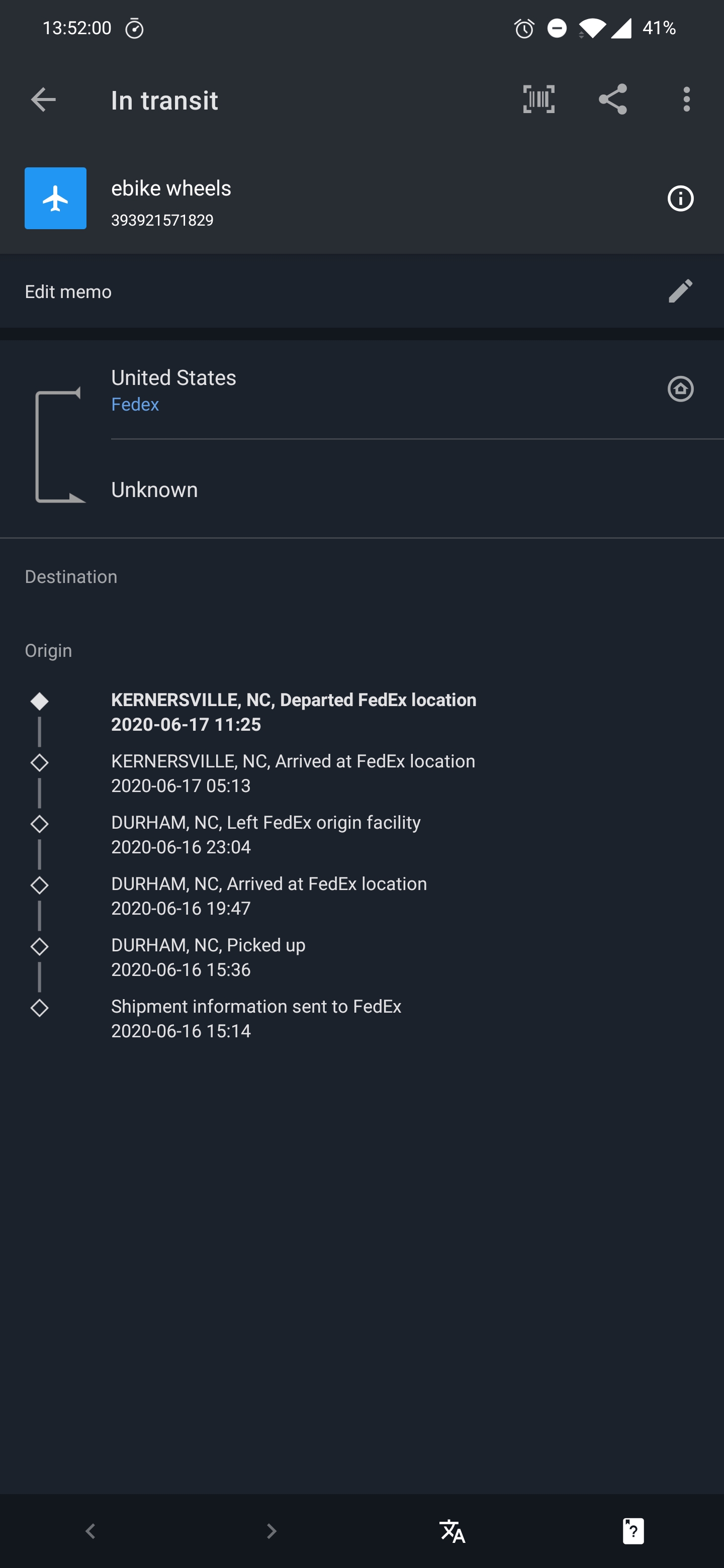

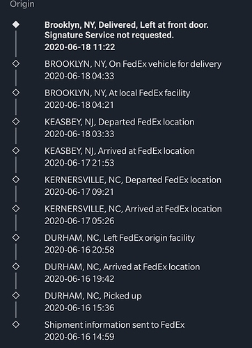

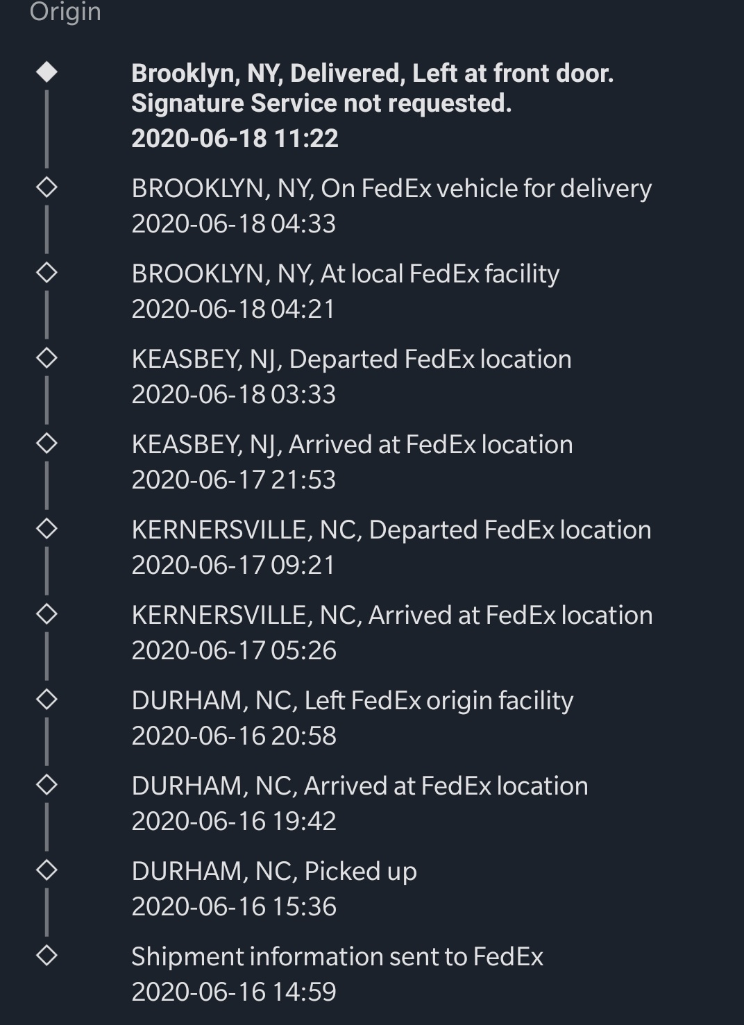

That said, I am officially at 7 days from my last tracking update on my wheels.
Anyone else’s wheels lost in transit?
Box must’ve 'sploded
yeah that’s not looking good…
mine moved quick and steady from shipout

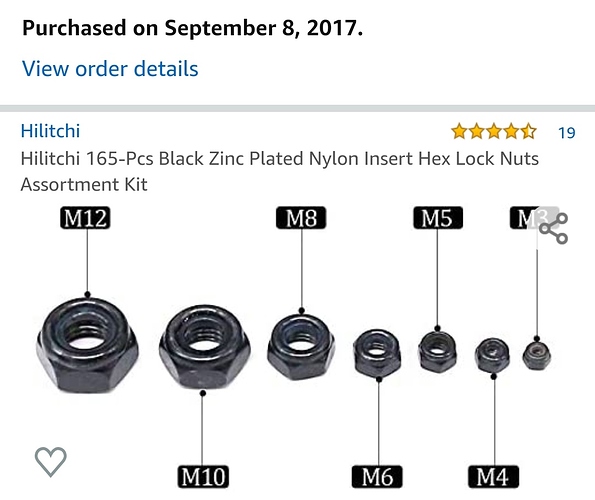

always check Amazon order history before ordering more stuffs :stuck_out_tongue_winking_eye:
Oof. 2017… you sure you still got them?
Also. Anyone one know what size nut am i going to need for these axles?
M12 1.25 on mine

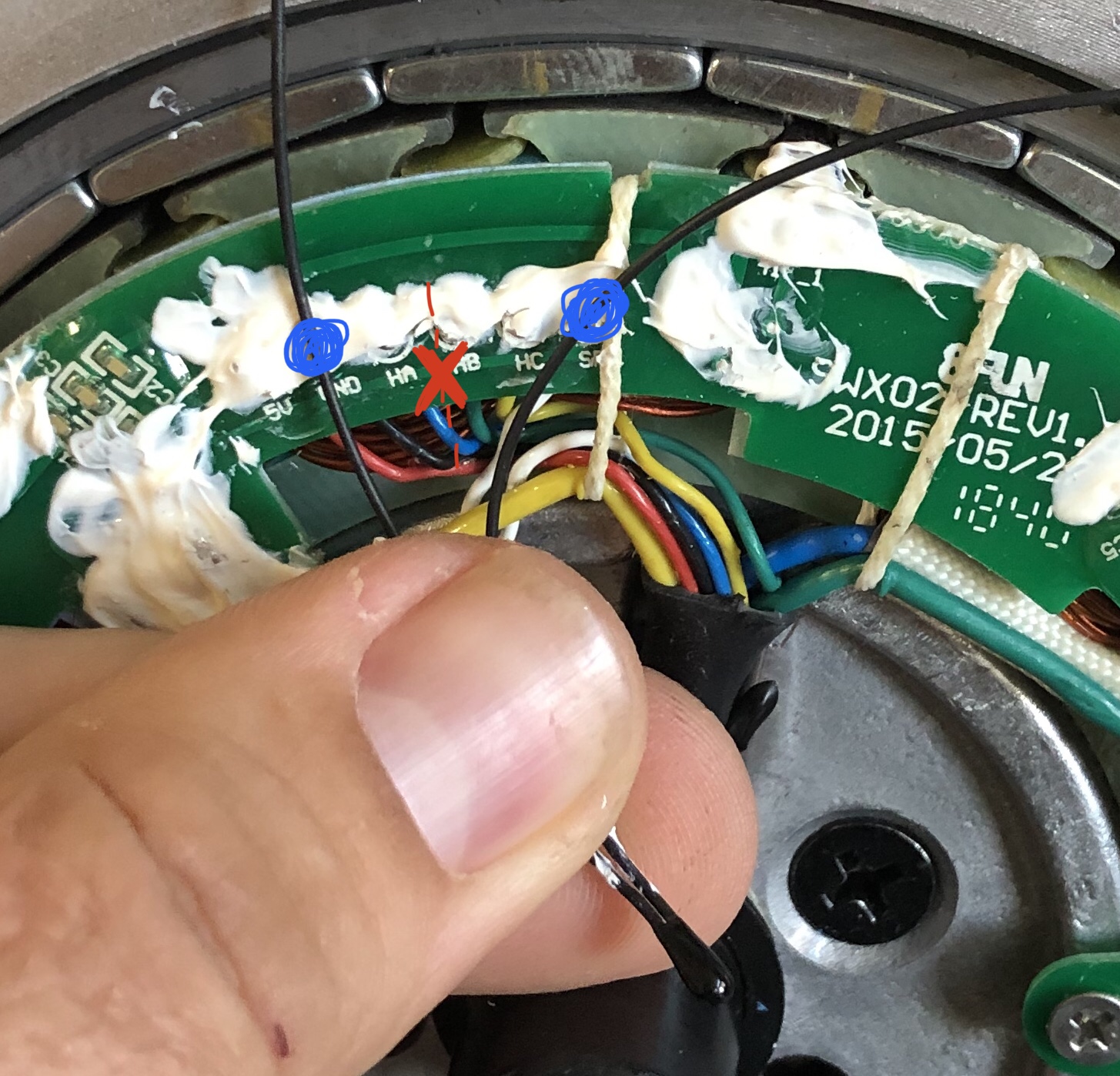

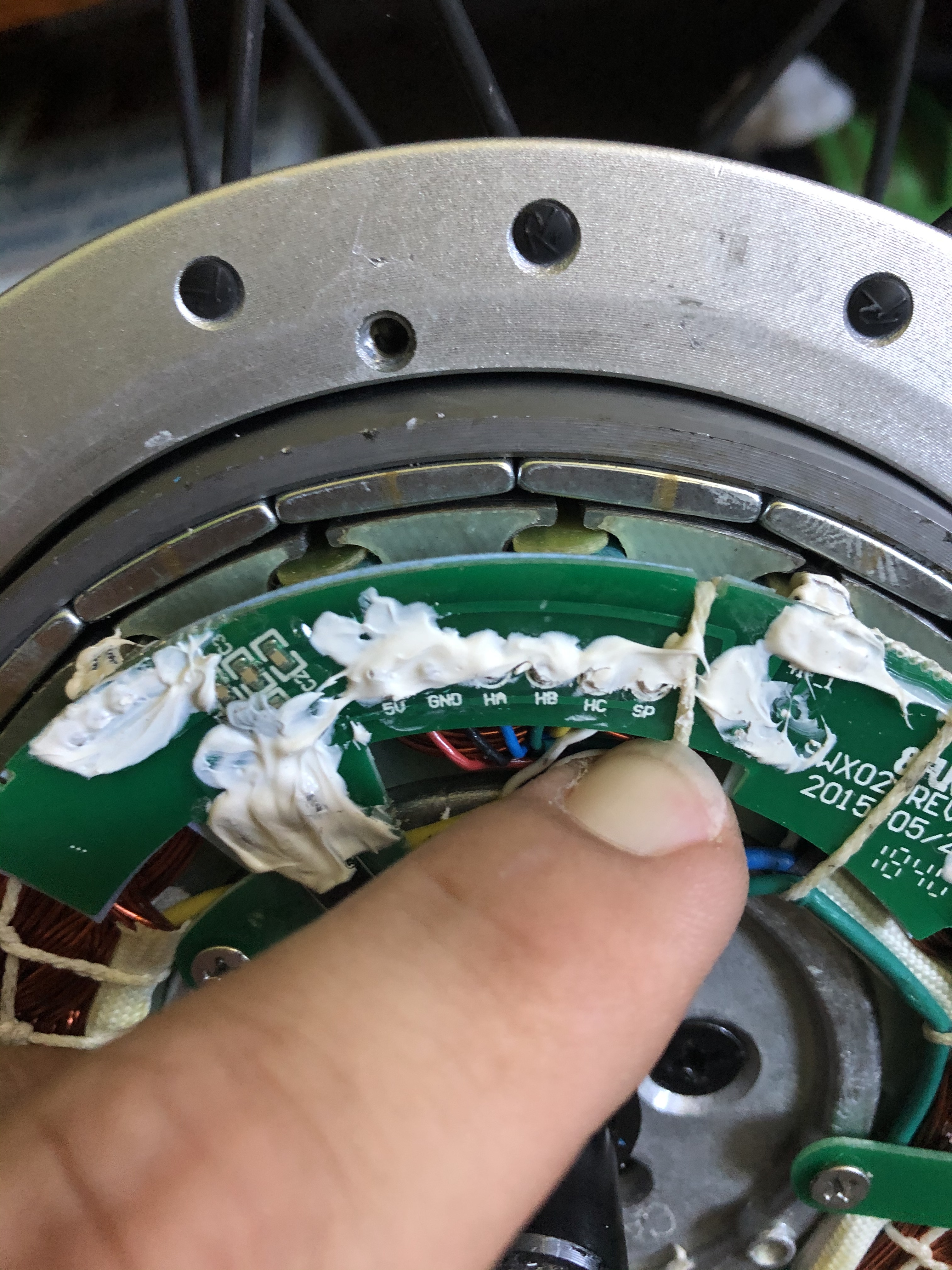

UPDATE ON THE WIRING

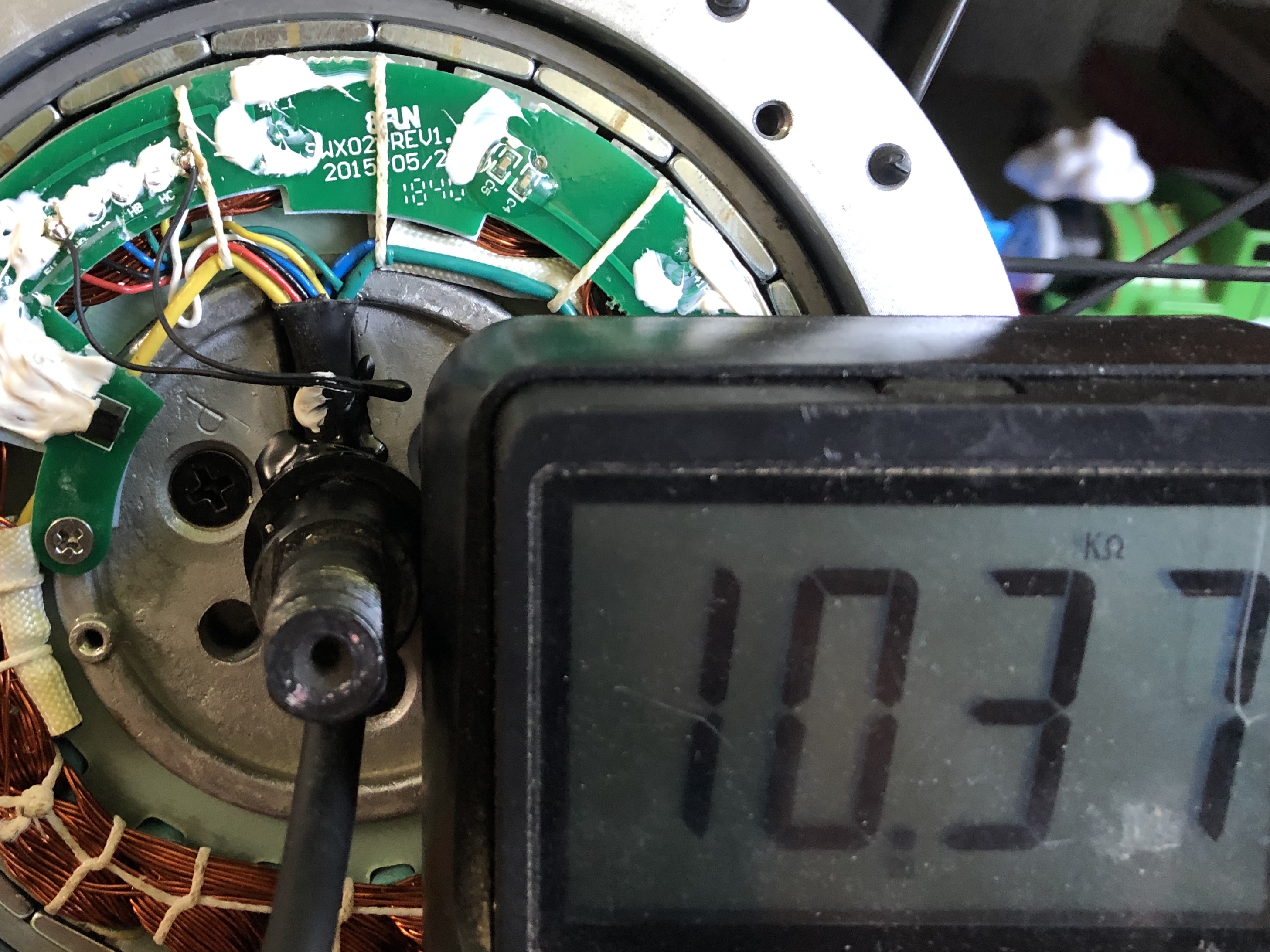

Turns out they don’t have a thermistor to monitor temp, the white wire is what’s attached to side mounted hall sensor to monitor speed. So don’t wire that into your vescs, it could cause problems. Also verified by having no thermistor output when checked with a DMM. Wouldn’t be too hard to remove this sensor and wire up a thermistor.

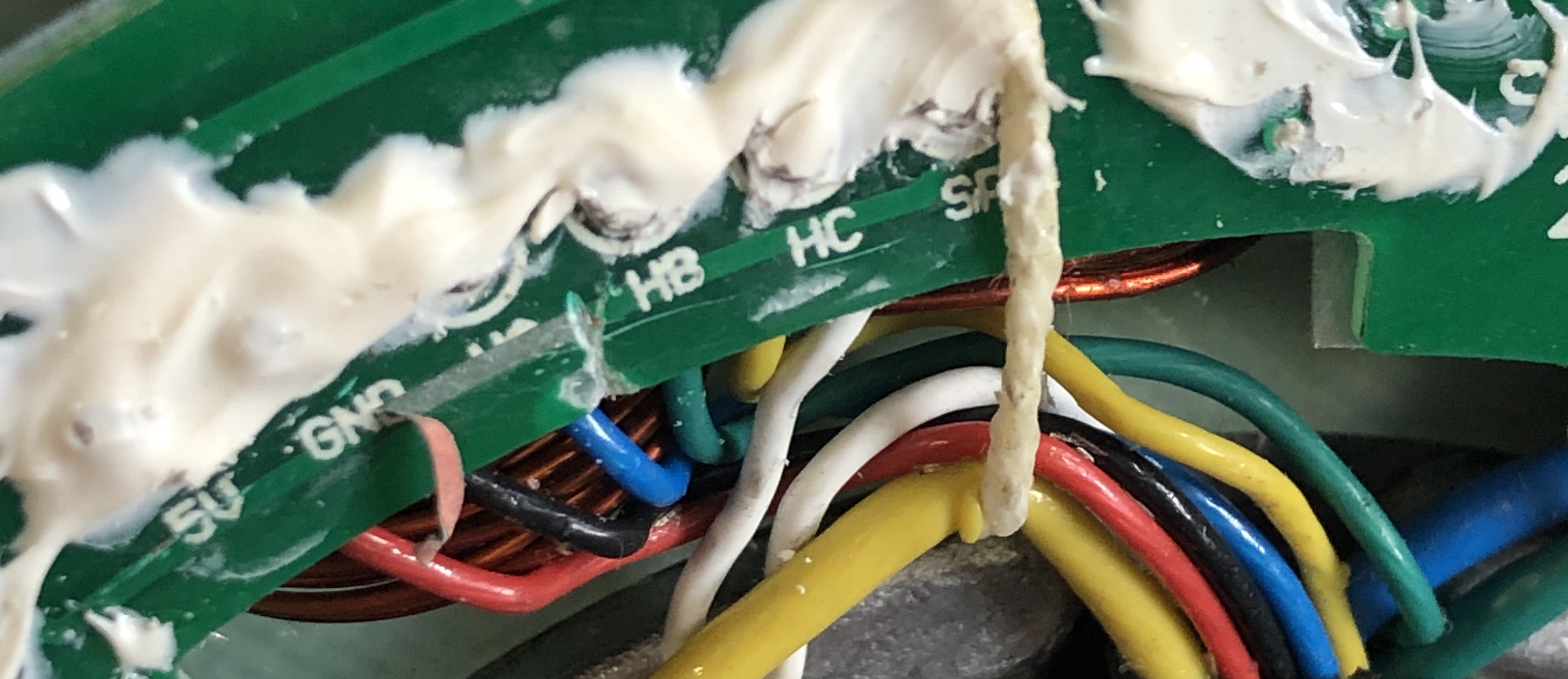

Wiring a thermistor should be very straight forward. Cut the trace that I have x’ed in red, and then solder the thermistor to GND and SP with the blue dots. Then just glue it next to the stator.
sounds sketch, guess I see how it looks when done.

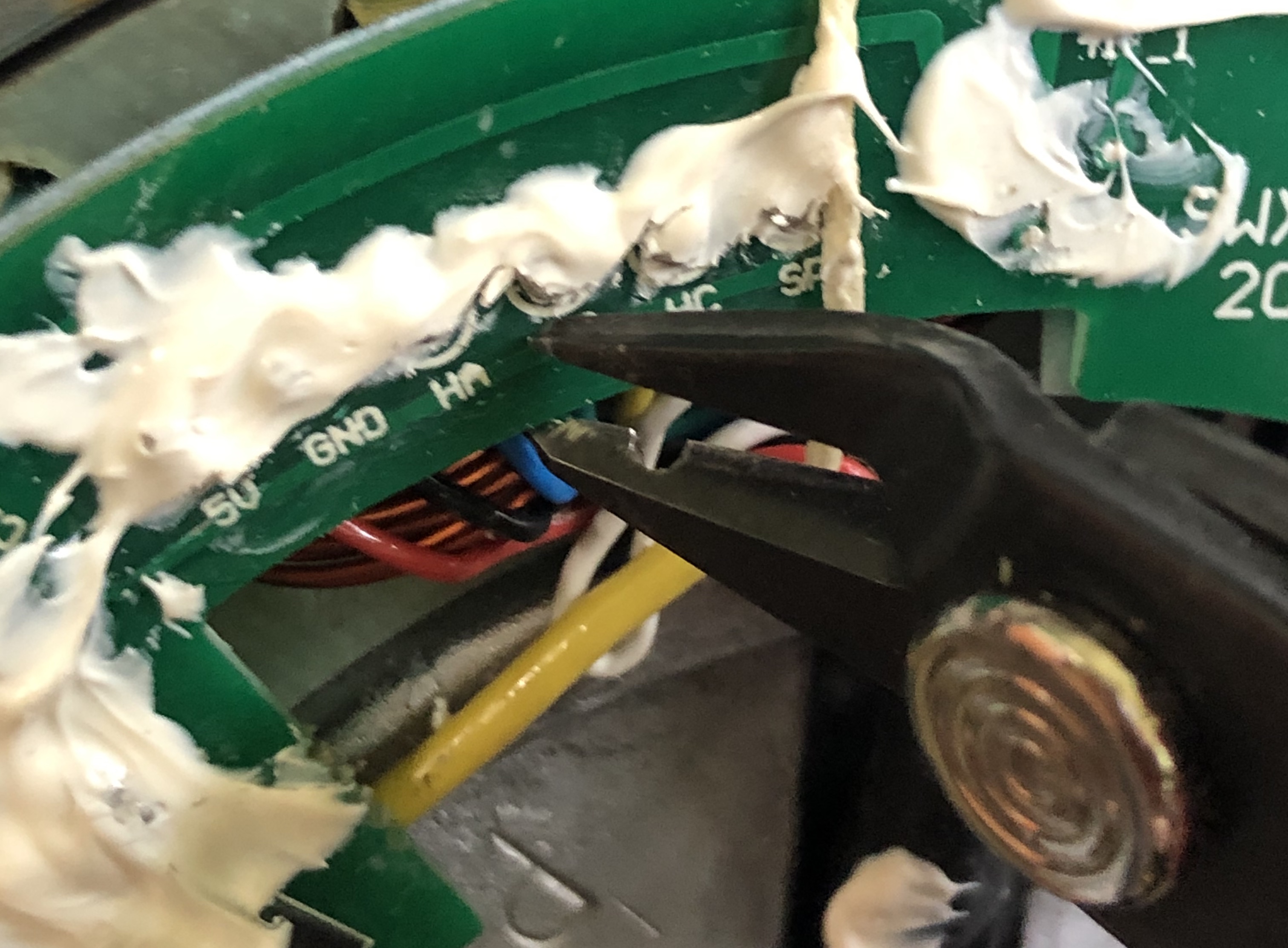

It’s not too hard in this case. It looks like it’s a single layer, double sided PCB. So as long as you don’t completely cut through the PCB it won’t affect anything else. You can cut it with a razor blade or slice through it with edge cutters like in the picture below. After I cut I was able to lift the trace up and cut it. Note: I probably cut a little deeper then needed, better to do more thin cuts then one deep one.
Here’s the finished result, I just have to conformal coat the solder joints and glue the thermistor to the stator.
