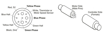

One of the guys on endless sphere is pretty sure the connector is Higo Z910.
He provided this as the standard pinout

I found this site which appears to be where he got the diagram
https://www.ebikes.ca/news/controller-motor-higo/

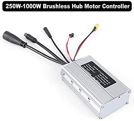

I thought this one was going to be fine but the supplier says no for some reason.
Not sure if I want to try anyway or not :sweat_smile:

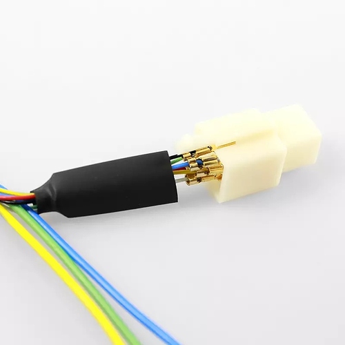

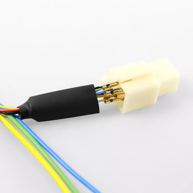

Higos aren’t easy to unpin unfortunately
Pehaps becazuse this is a geared hub and that ESC is for DD hubs
Yeah that makes sense :sweat_smile:
https://www.ebikes.ca/shop/electric-bicycle-parts/controllers/c4820-gr-higo.html#
This guy might be the winner.

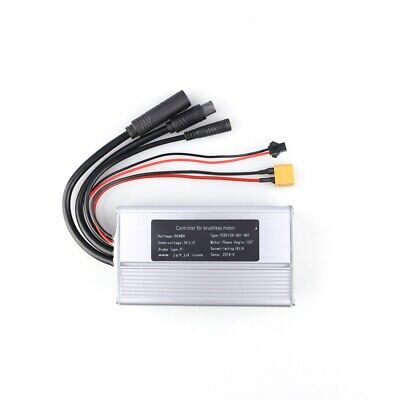

Doesn’t make sense it won’t work… According to this Amazon link:
and their 3rd picture:
, their 750watt controller have different pin-outs than their 250-500 watt controllers. Perhaps they thinking you are asking about the 750w or 1000w controllers, which have 3 big pins, while the lower watts controller are Bafang 9 pins?

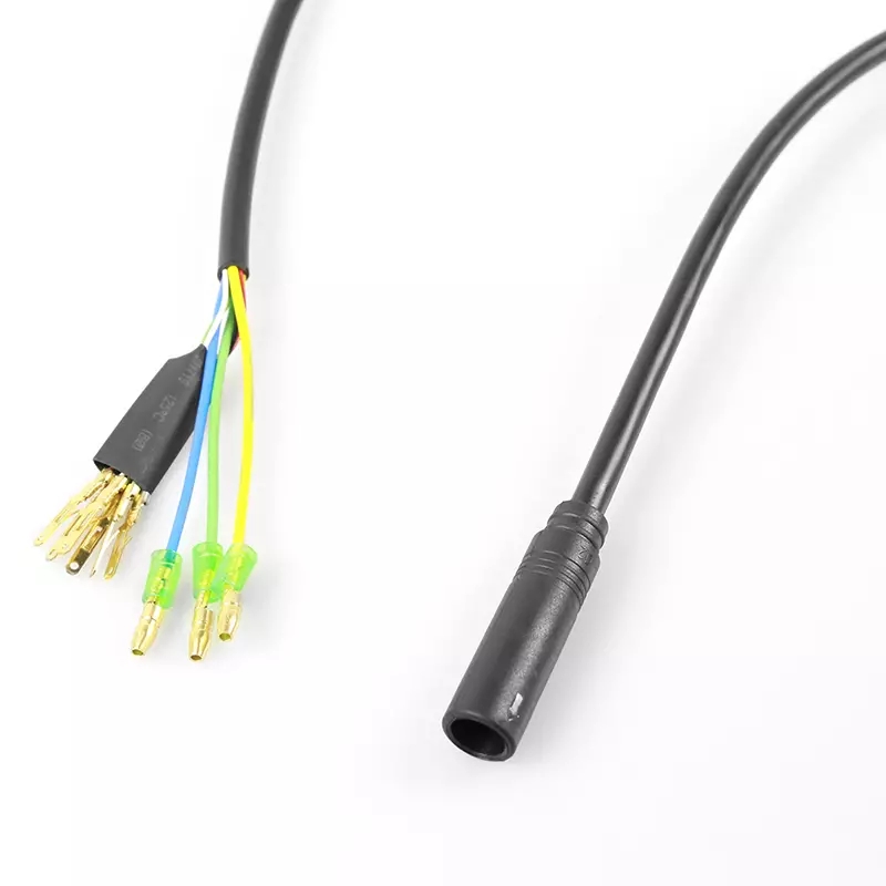

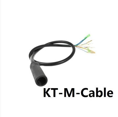

If you want to un-pin the Higo Z910, I would get this cable: http://www.pswpower.com/ven.php?cargo.2019-7h-j6qk (the KT-M-cable version),
than should be able to hookup to any non-waterproof controllers.

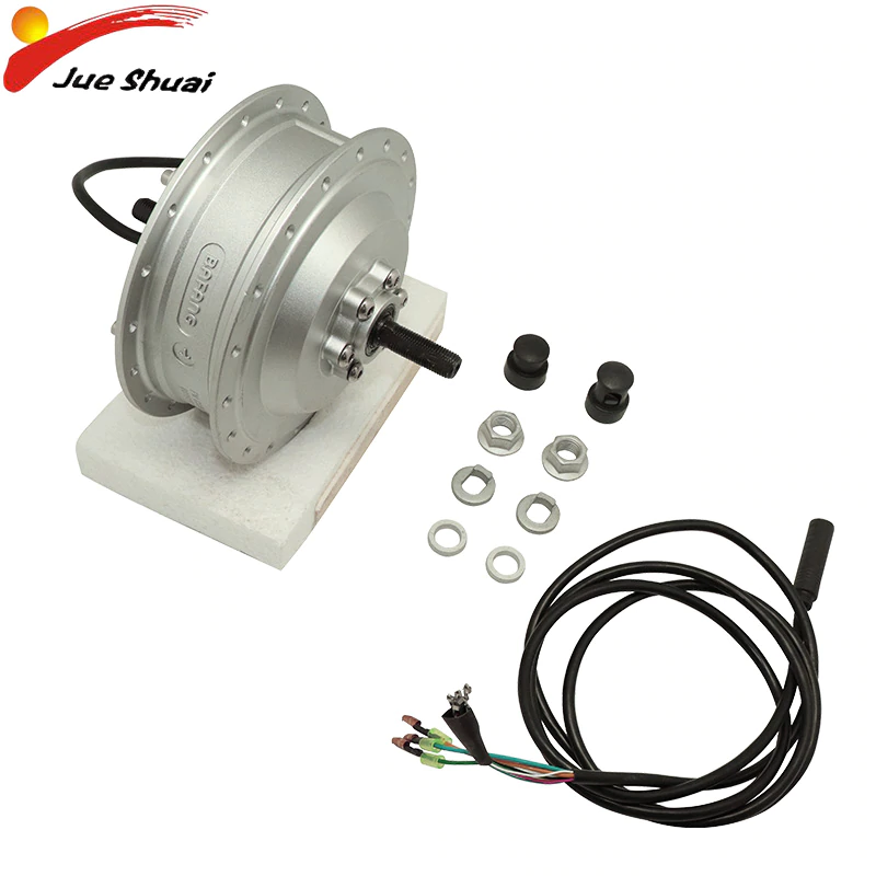

That same supplier sells the whole Bafang conversion kit (which looks to be geared hub motor to me) with the 48v 500w controller.
I believe this is their AliExpress store front:
If that same controller works with Bafang, I would think it will work with Bafang G020.350 motor. Of course, I may be wrong, since I don’t have any experience with their controller either, but consider it versus the one from PSWPower.

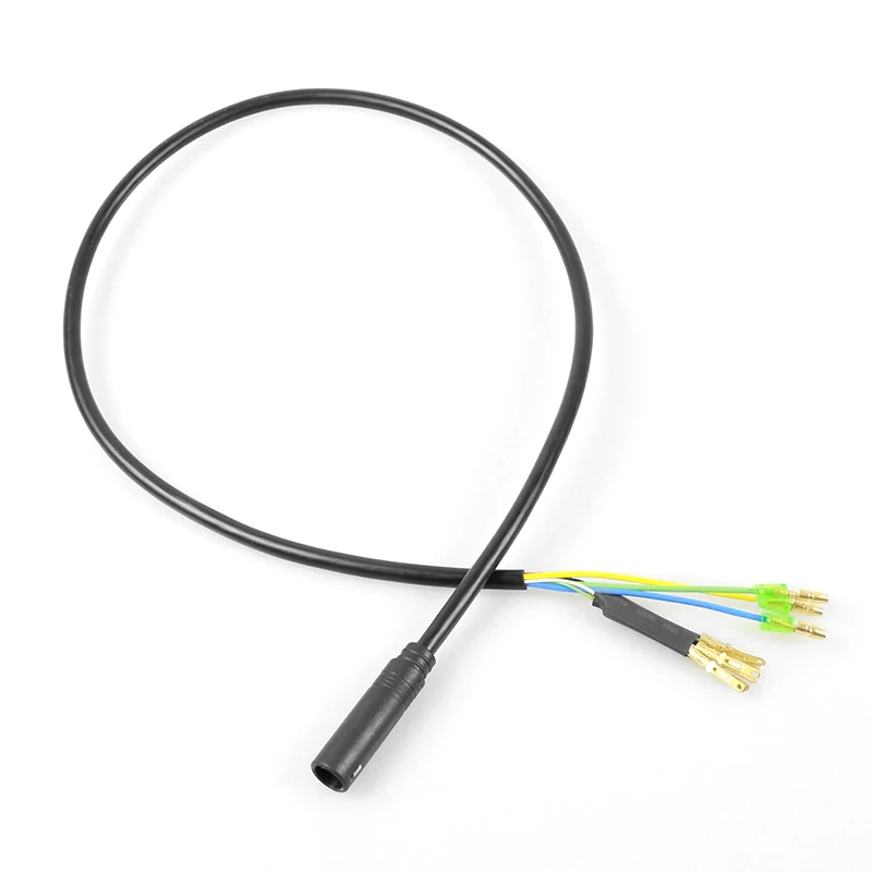

That kt-m and a kt-f (female version?) cable might just be the key to saving myself a headache, thank you again for that!
Every Vendor calls the cable something different.

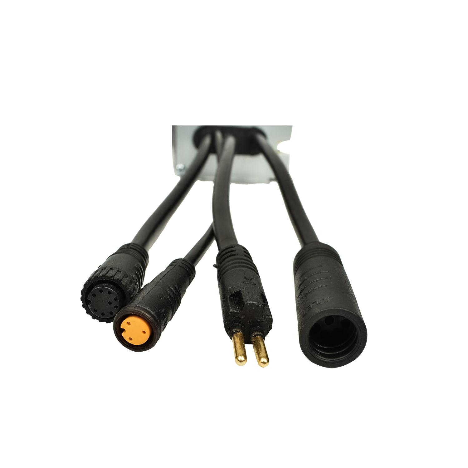

Here is another vendor using that same type of cable, since they don’t sell waterproof controllers:

Those split out higo cables look like an easy fix for incompatibility though.
I’ve seen way more escs that use those connectors that I could repin until I get the right hall sensor order. Your info is sincerely appreciated. :pray:
@Venom121212 those adaptors look like a good test, The colors match the last hub i took apart red +5v, black GND, white temp, yellow blue and green are hall output. So you could probably plug it in, test the ground and white for the thermistor and if it is it’s probably wired the same. From there could put voltage to the red wire and test for each hall output.
