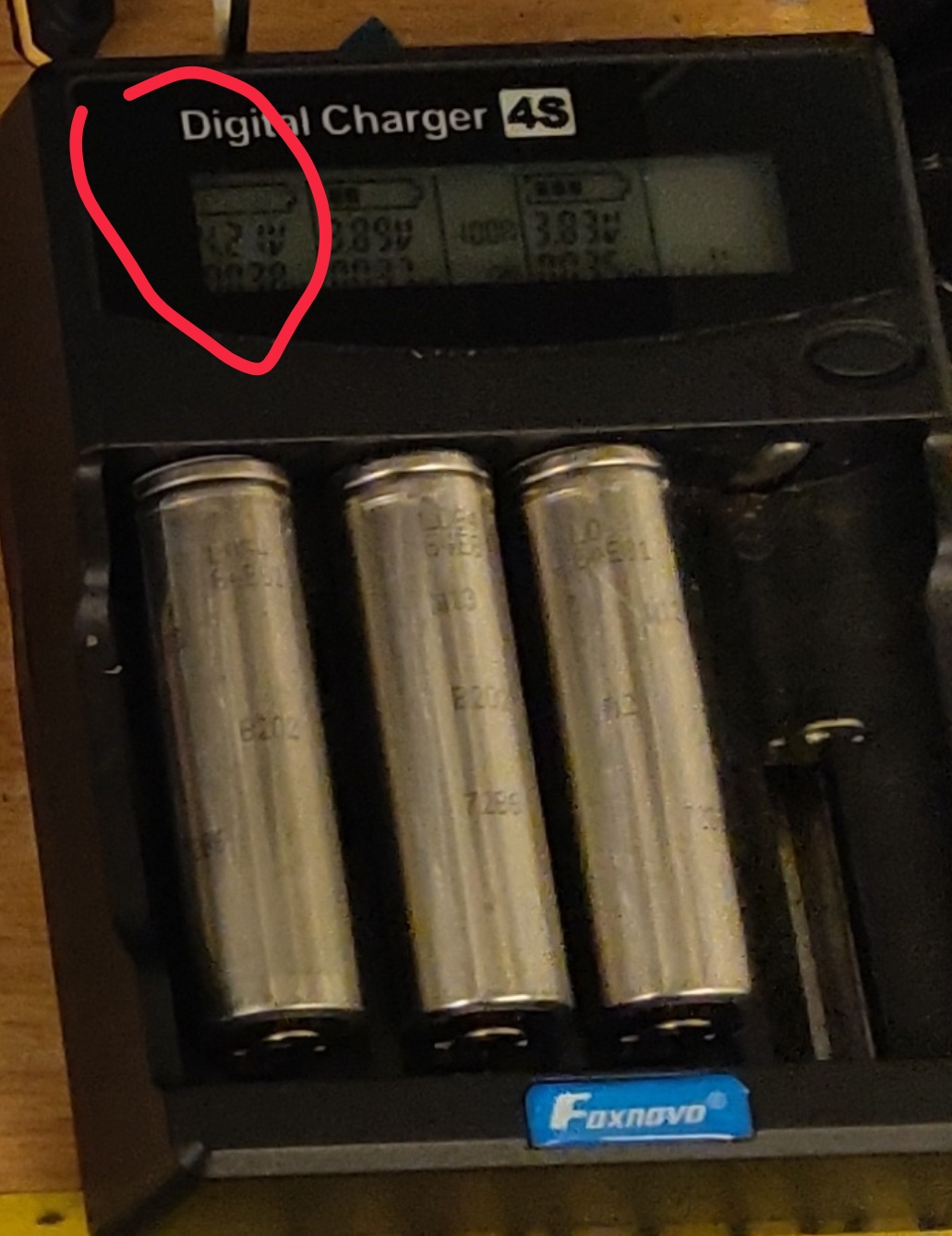

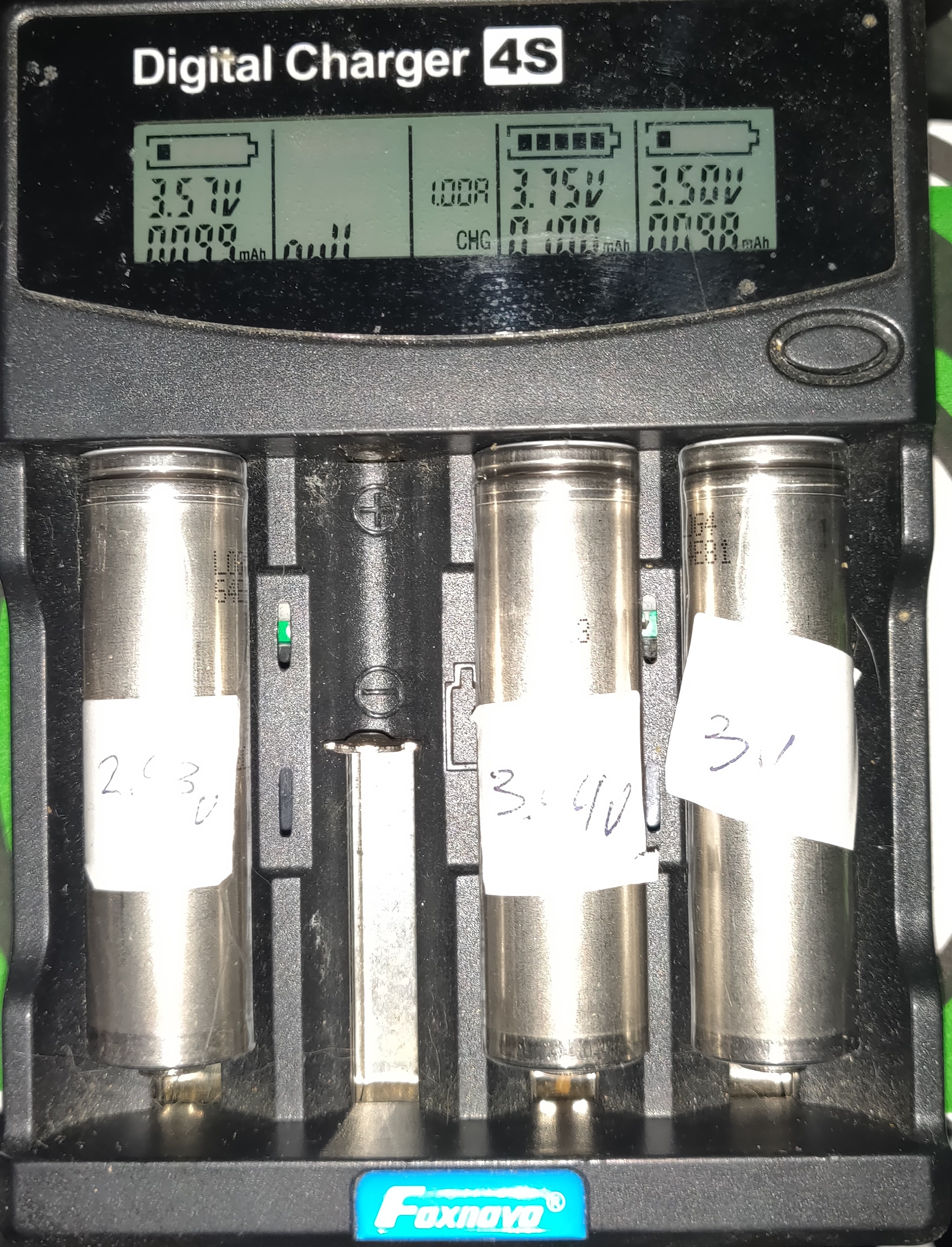

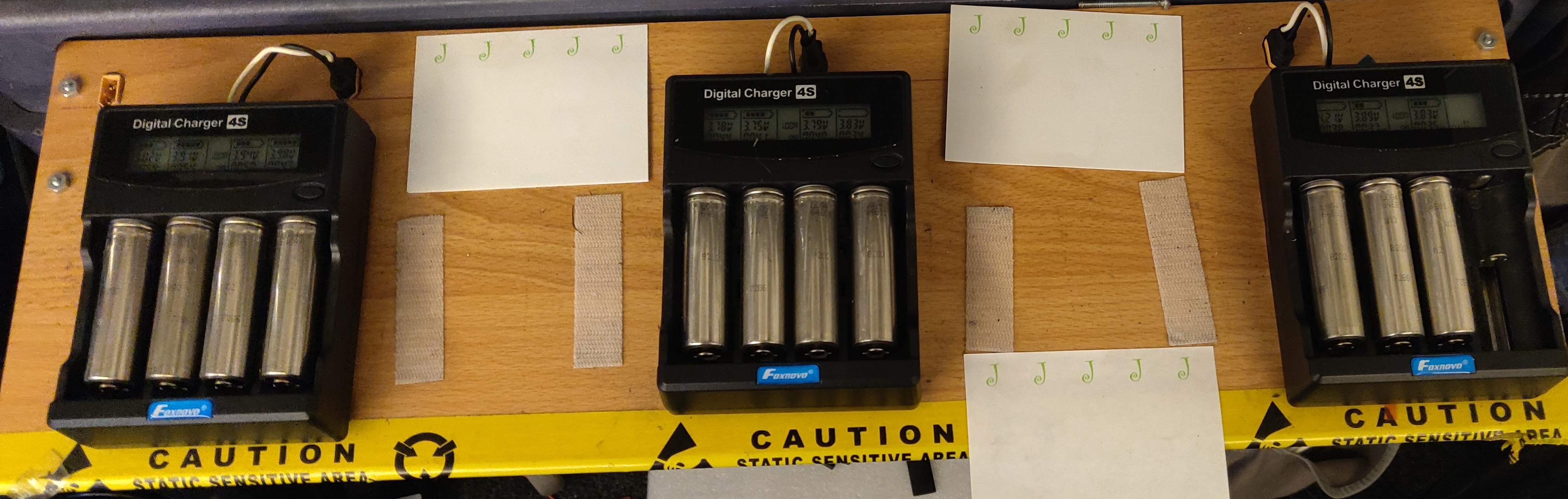

been a bit swamped, started testing the questionable cells I picked out
definitely something up with this one…
Yowza, so much waste
