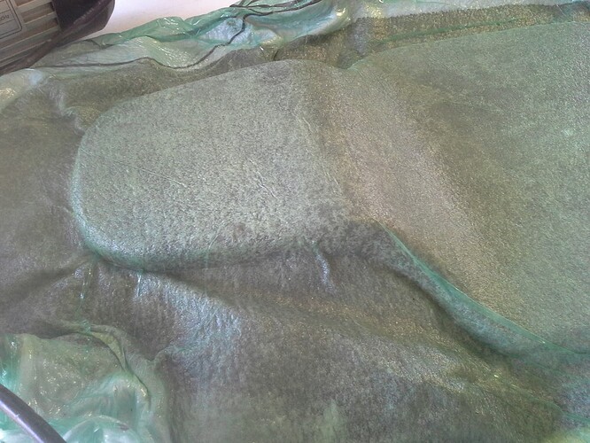

The board was given a coat of 2k hi- build primer, and a few patches of filler.

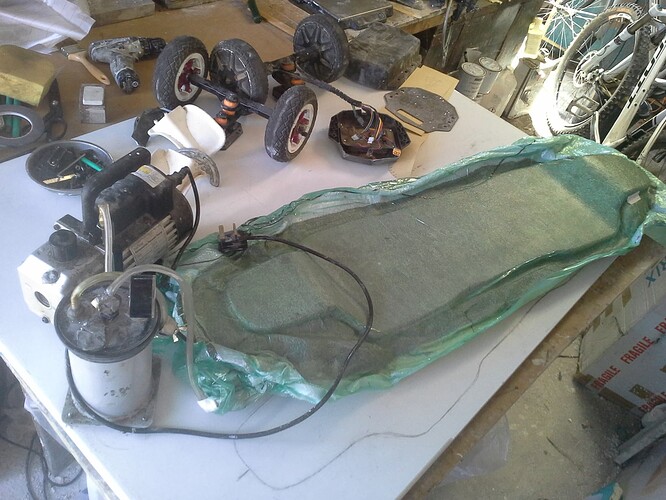

Then straight onto a huge vac bag, pre-tapped and ready to go.
This was a wet lay up, first a quick brush over with laminating epoxy resine, then build up
first one layer of 390g E-glass, then two of the 450g 12k carbon. Then peelply and breather
cloth to soak up excess resine.
Brain fart number 1.
I laminated the top first, then flipped it over to do the other side, and the first side fell off.
Somehow, as I slowly pulled the vacuum, I managed to massage it back into place and do what I
could to get the edges to line up straight. This then sat in the sun under vac to harden up.

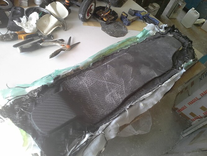

This part of the process only took a couple of days and for my birthday present on the 21 june,
I unwrapped a new skate board!
It might be called peelply but it’s more like tare the shit out of it, and try not to stab yourself in the
process. Not the most fun I’ve had on a birthday, but satisfying to see it emerge from the bag.
It’s better than expected, even the edges are pretty good.
Not exactly flexy, but there is movement, a little.

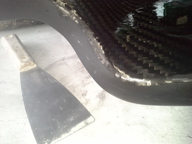

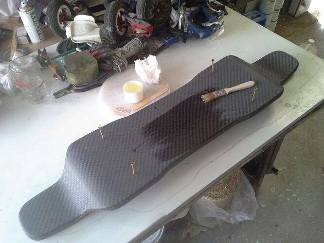

The edges were cut with a vibro saw and sanded back before giving the whole thing a wet sand down.
Then with four screws in each side to keep it up, I gave it a brush coat of the same epoxy.
Around the edges I troweled on a layer of epoxy mixed with micro glass bubbles and black pigment.
I drilled the holes and popped in the m6 threaded inserts and gave it a dry run.

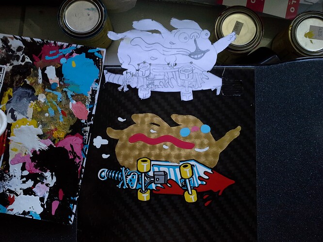

One of my favourite things about 80’s skateboards was the artwork, especially Jim Phillips at
Santa Cruz. I went with the classic slasher but with out the Beastie and a Moog in place.
For those who have never heard of the Moog go check out an episode of “Willow the wisp” for a slice
of 80’s English comic crazyness.
First gold size, it’s really just varnish, let it get tacky (have a test area along side) then apply the gold.
Catching the timing right, i.e. not 100% set, but close, give it a turn with a felt polishing pad in an
electric drill. Then a couple of coats over top to seal it in. Then on to the Oneshot paints.
Hell yes! I’m a sign guy so I have One Shot in my veins. Warms my heart to see it on a board (and gold leaf also). Great work :clap:t2:

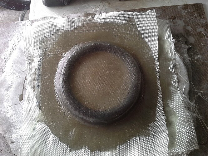

Here I have applied 7 layers of 190g E-glass, wetting out with a brush with polyester resin.
I get all my Fibreglass supplies from East coast fibreglass, in the UK, very helpful and they
always deliver next day, pretty much anything for £10. Top guys.
