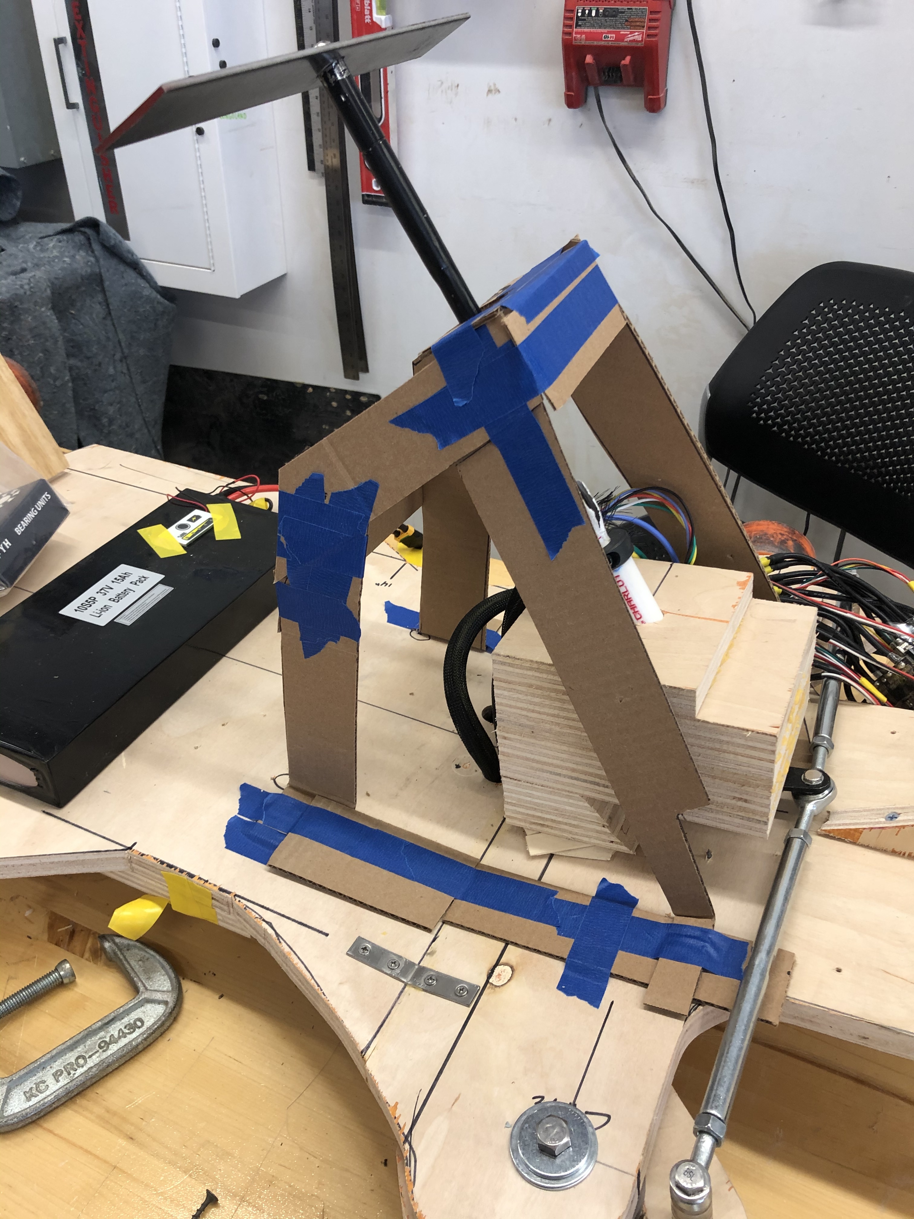

Steering column support built. It will be covered with a fiberglass enclosure on the final.

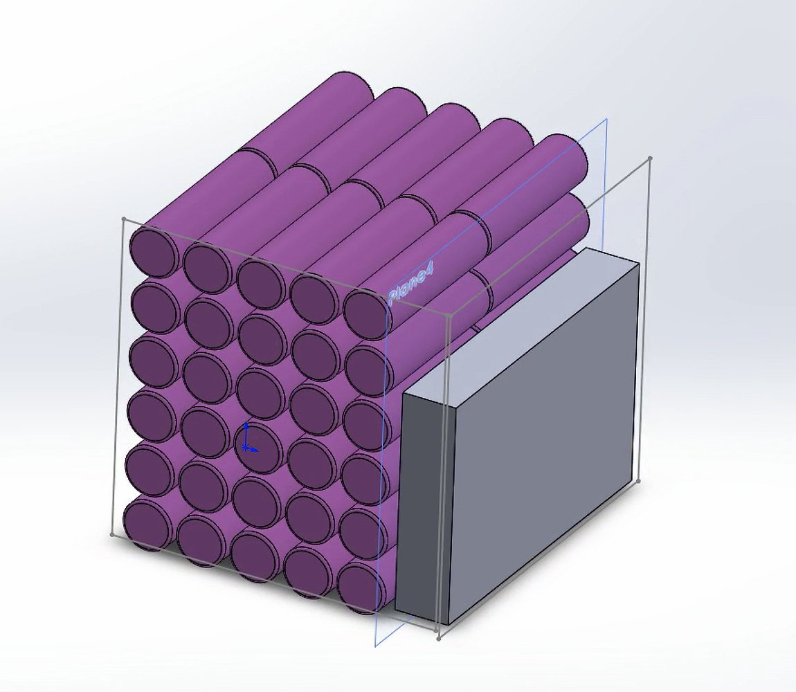

Need to find someone that can reconfigure my 10s5p to be more a brick than its current state.
:wave: Shoot me a PM if ya not looking for someone local.

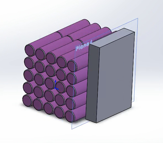

This is the ideal battery layout to fit in the enclosure space I am giving myself to work with.
roughly 120mm tall, 120mm high and 170mm wide.

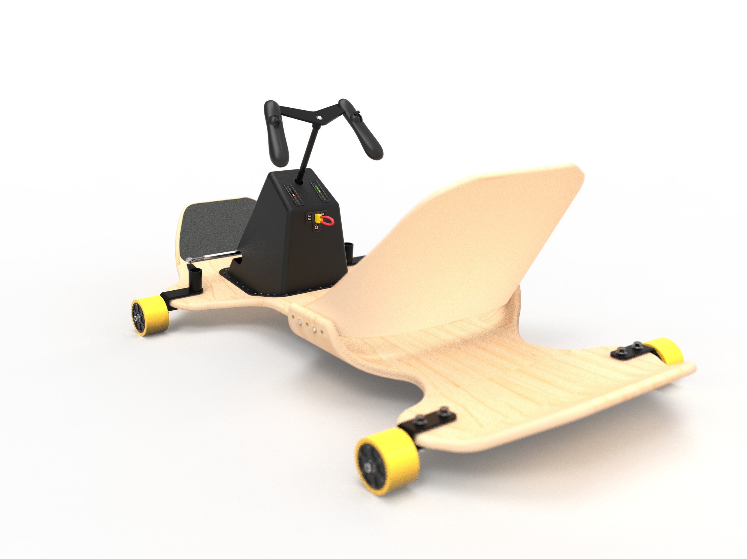

Final design has sides to keep the driver in the seat!!!

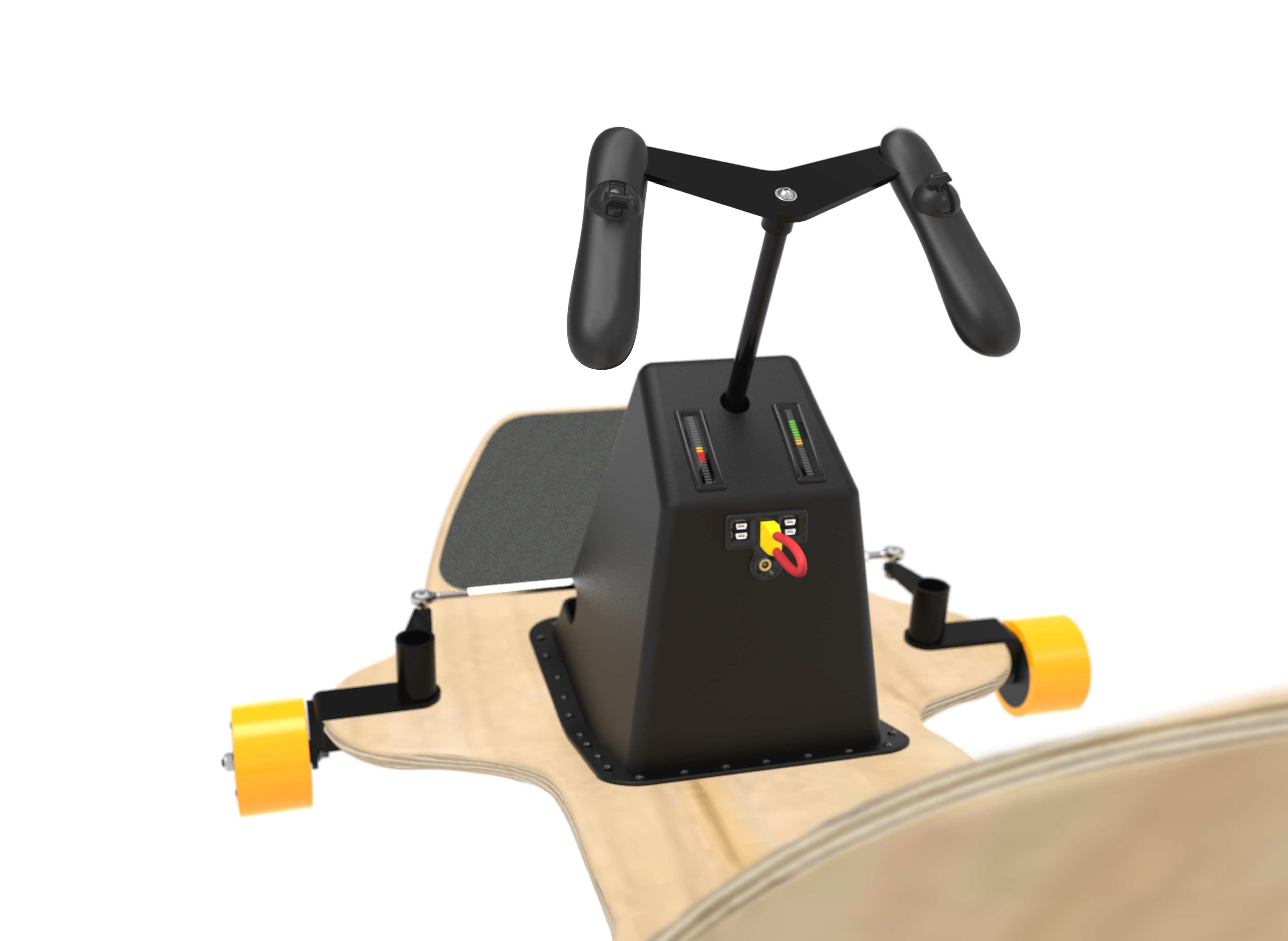

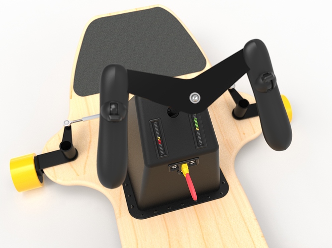

Now I need to model a steering wheel to hold the joysticks and new caps for the joysticks. (Among a million other things!)

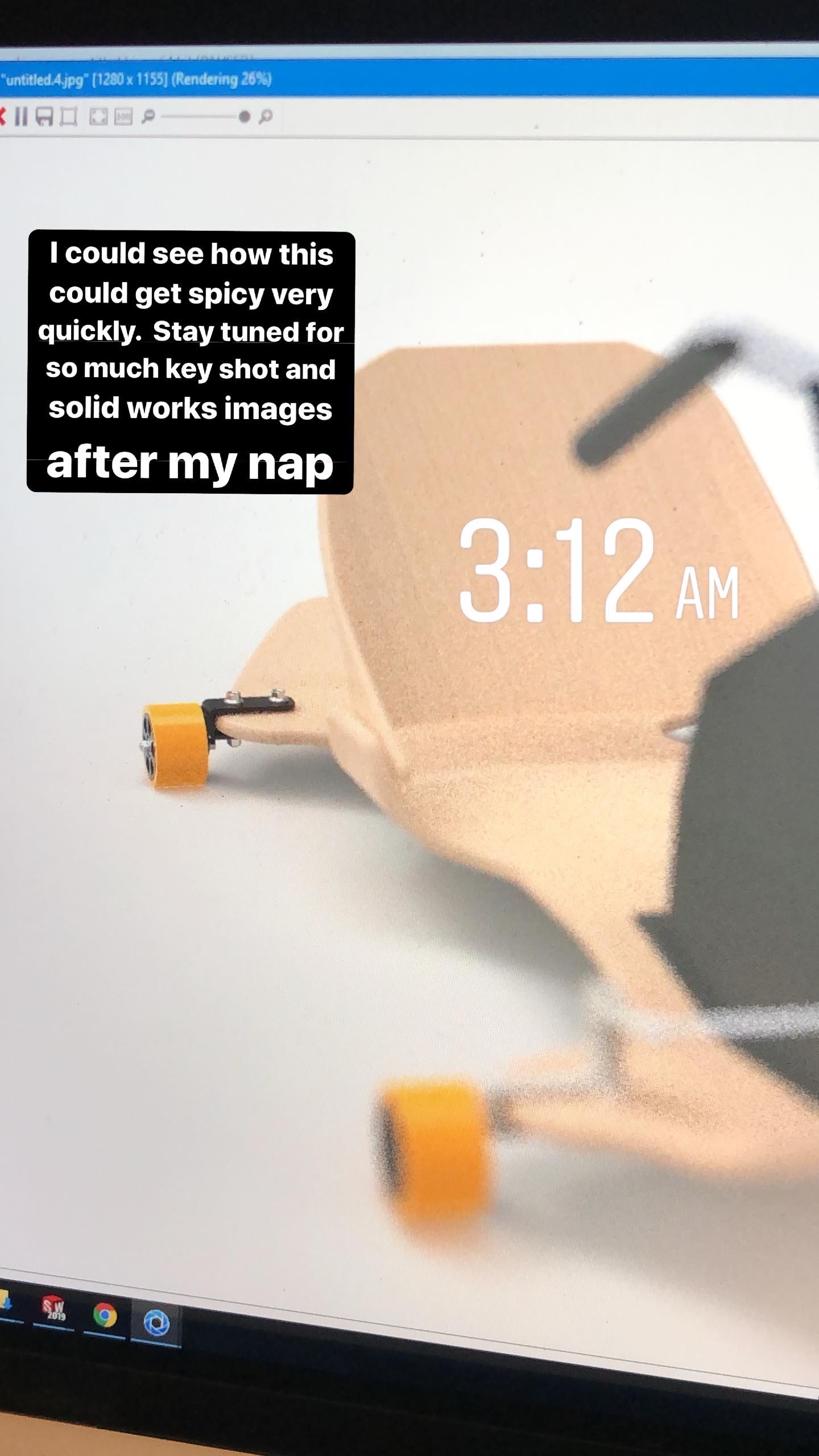

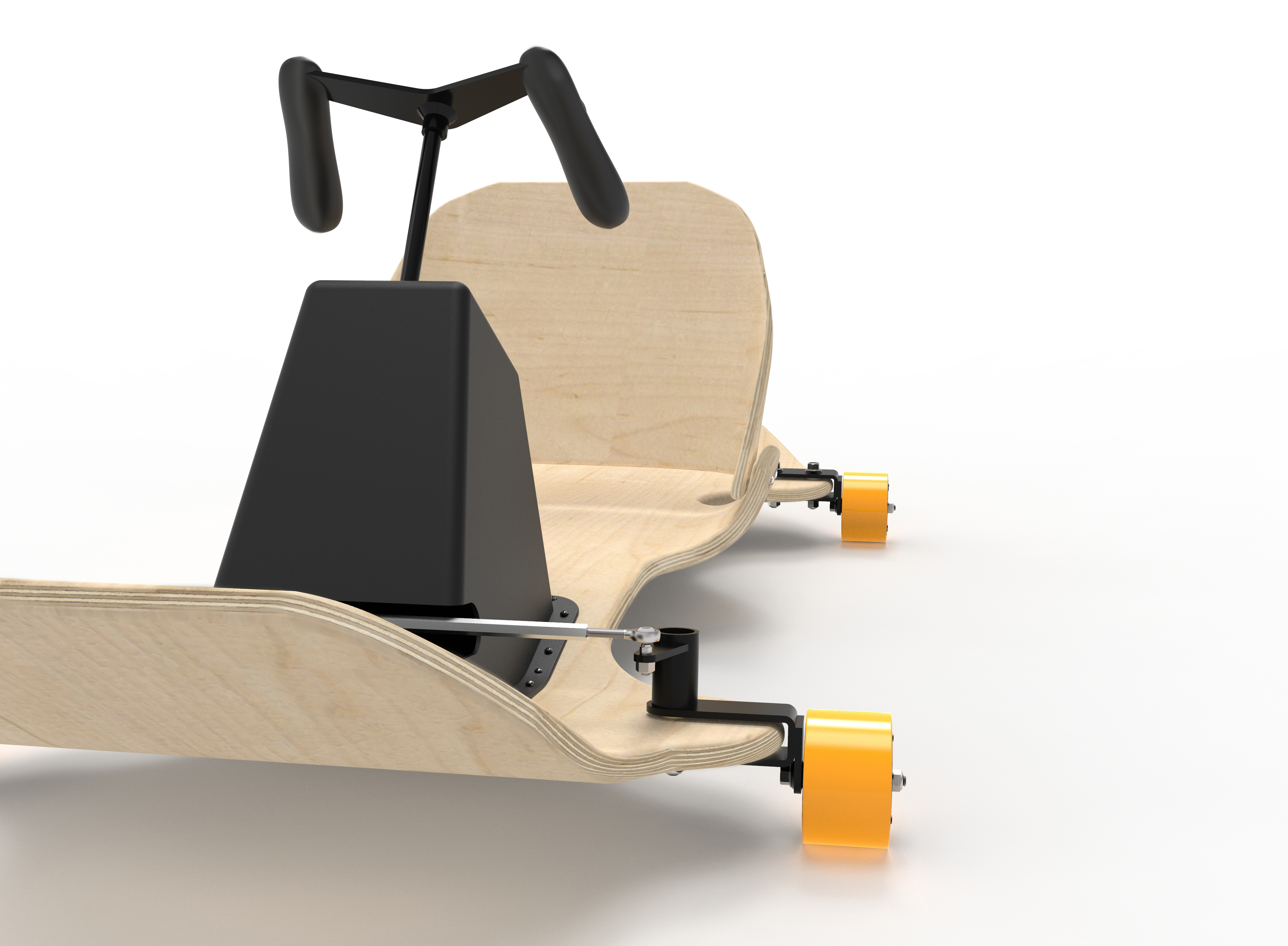

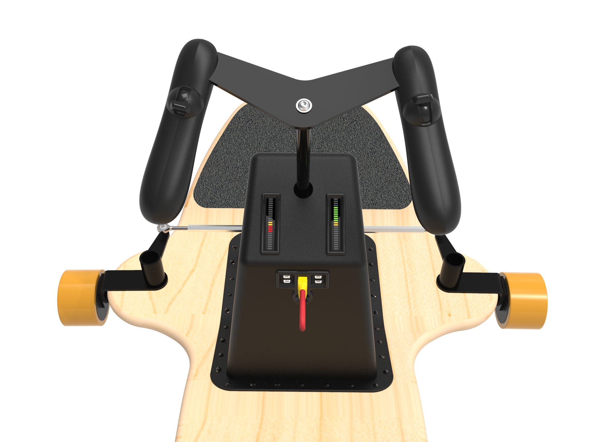

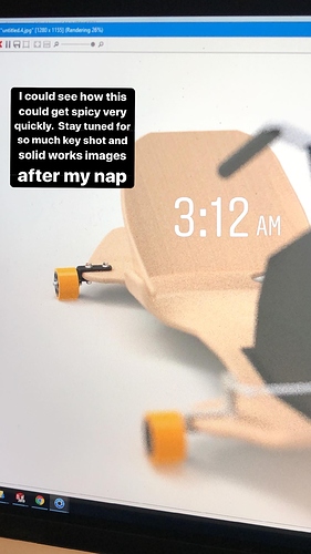

school is kind of closed, kind of switched to online classes. Tightening up my renders and they are starting to look spicy! shoutout to McMaster Carr for having their hardware available as Solidworks files on their website!

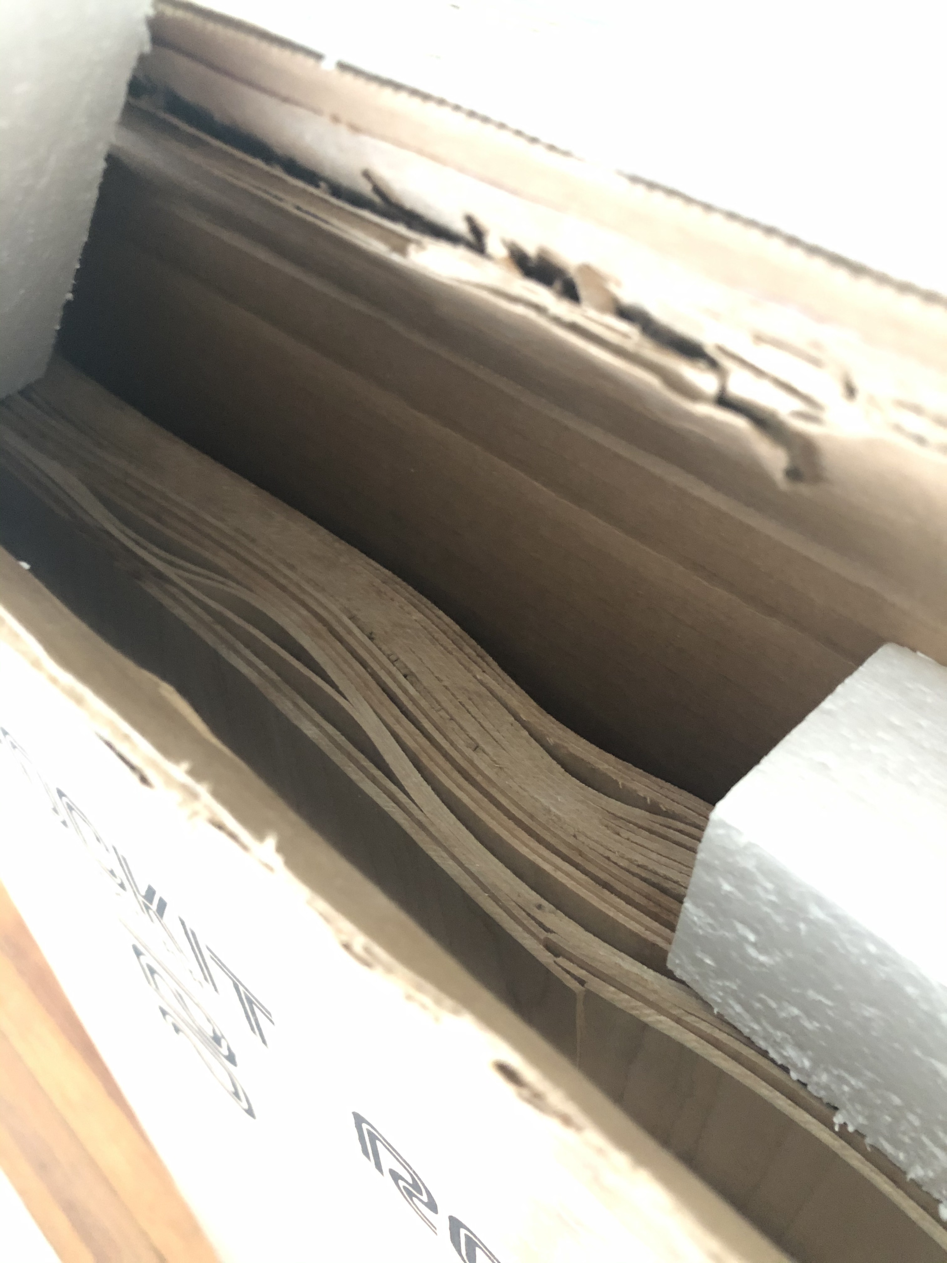

Veneer came in! Waiting on epoxy and to CNC the mold.
1/16” hard maple in 25x48” sheets.
The plan is to do 8 layers and then a top and bottom layer of cabinet veneer for a seamless top and bottom. ( 6 of the 8 plys are long grain and will be zig zag cut and butted at various spots to get the length I need but the top and bottom veneers will cover that up)
More testing, this time with the throttles working on the steering wheel. The original concept of manually controlled torque vectoring is looking like it could have the potential to be quite fun.

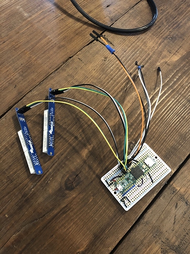

Got the code on to a Teensy 3.5 board and integrated it onto a perma proto bread board for a more compact and durable design. LED bars and Teensy are powered by the 5v from a single speed controller so there the loop key powers it all on

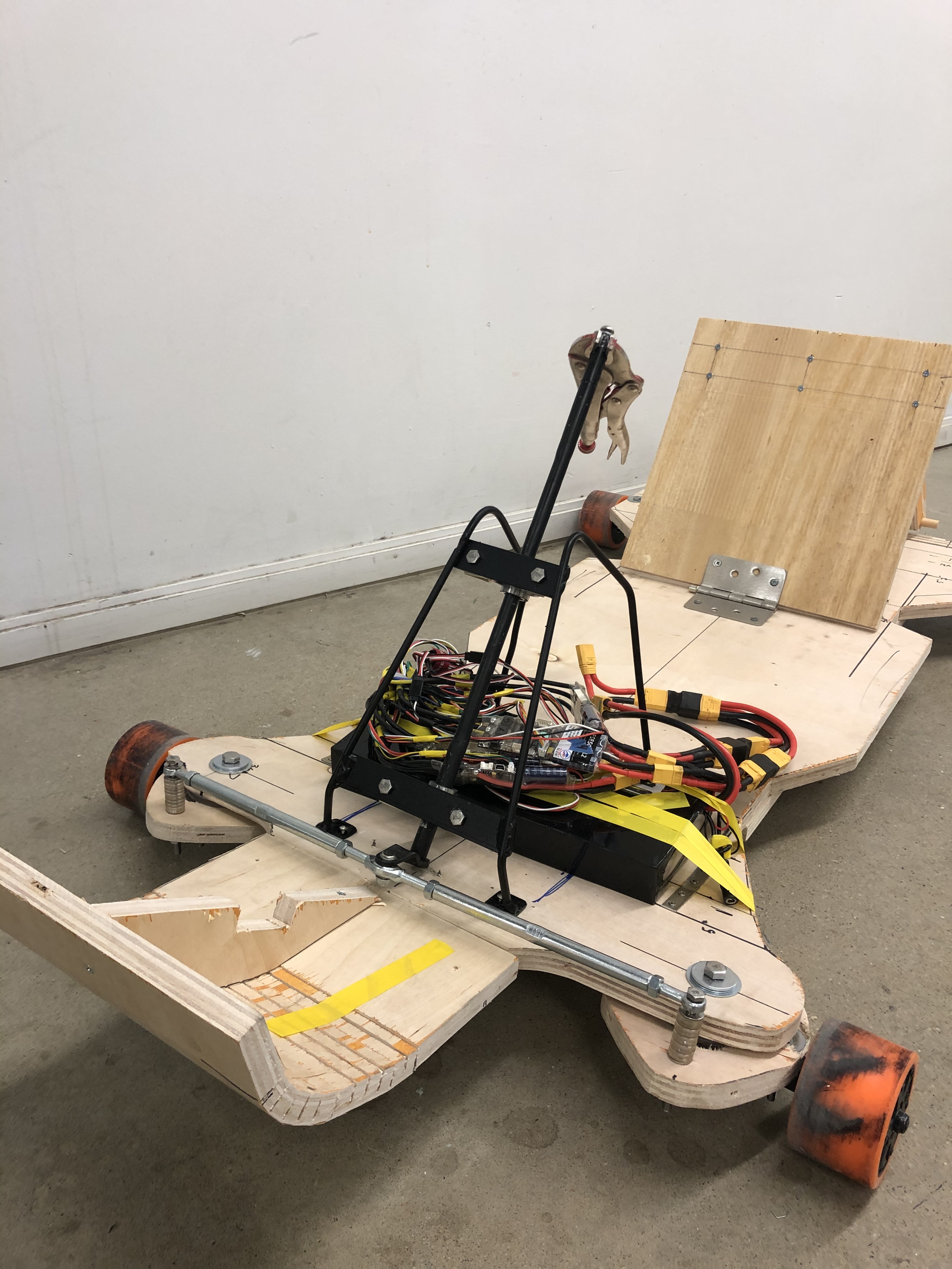

The final build will be so much fun when it is stiffer, the wheels are better aligned, and the steering wheel involves less zip ties and plywood. Super excited to get the deck build started!!!
this looks so cool man.
it is coming along. I am really excited to build the final version of this… One that I’m not fearful of it snapping mid test drive and can look a little prettier than my testing model.
I am still designing the actual bearing setup for the steering arms and think I have figured out what to do to make it steer smooth.
Having 2 of these sandwiched between the deck by the front steering arms to make for an easier to turn steering wheel, plus whatever play there is between the 2 filled with shims.
Thoughts?

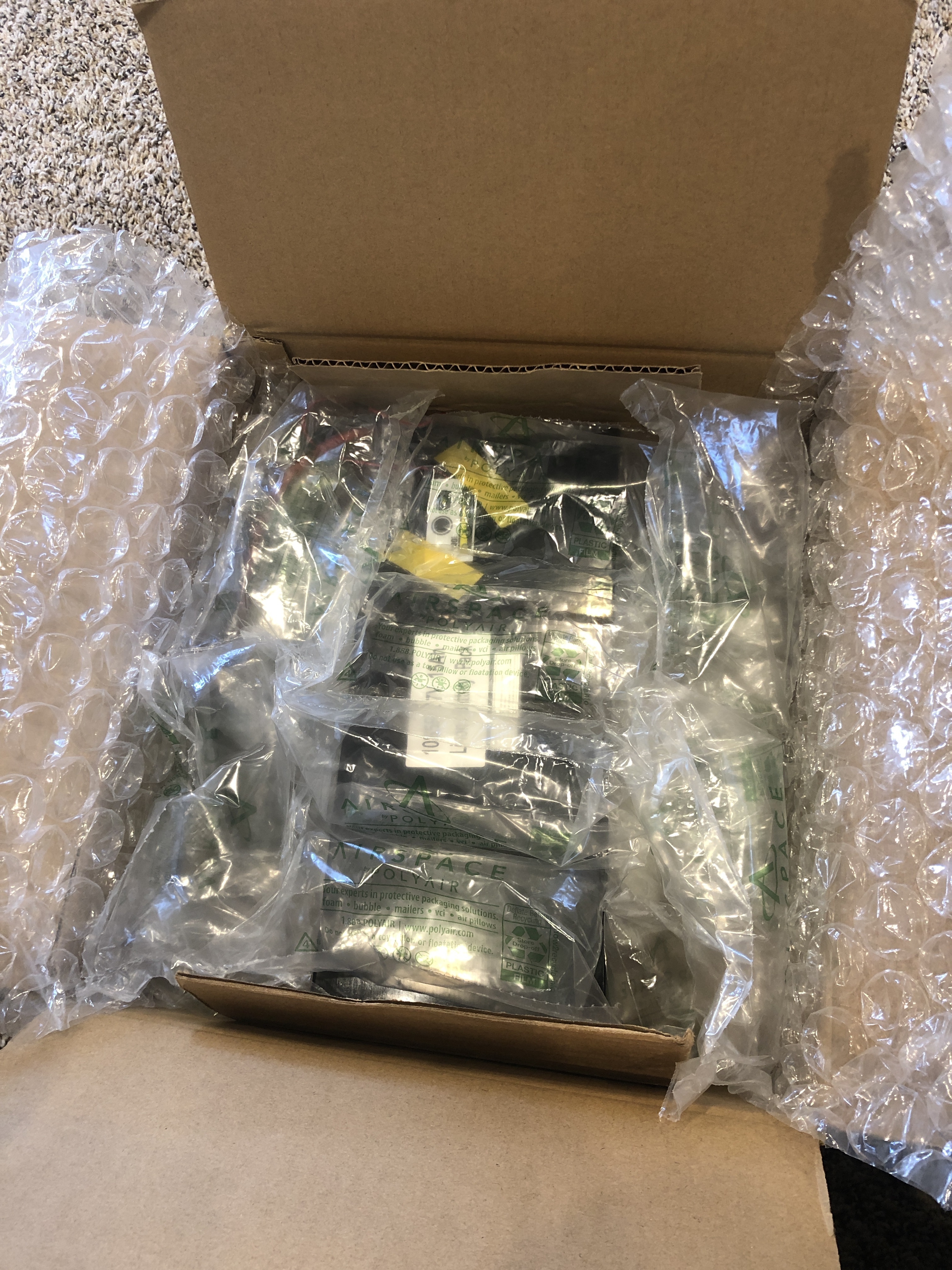

Batteries today got shipped to @BluPenguin for her to do some magic on the battery. I have a 120A fuse waiting when it gets back and can’t wait to feel what it feels like with another P group.
10s2p and a 10s5p are getting turned into a 10s6p (not enough room for a 10s7p) and a fat ass 120A fuse going to be used on the discharge side to play it “safe”
