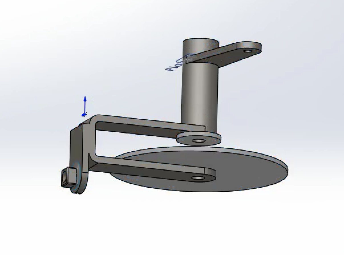

It’s a start. Gosh bent plywood surfacing is a pain! Big shout out to YouTube!
Tomorrow I hope to have a majority of it modeled. Now that the deck is started the only other real important stuff is the bent plywood back rest and the steering “knuckles” that I need to design.
I am hoping washers of a material like delrin will be “self-lubricating” enough to all for the steering to move smoothly and without any sort of slop.
UPDATE. back rest is in there now

Todays update

Thanks, it’s not super detailed but I really just needed to show the general idea.
Steering wheel design needs to be worked out but it’s starting to seem real.
