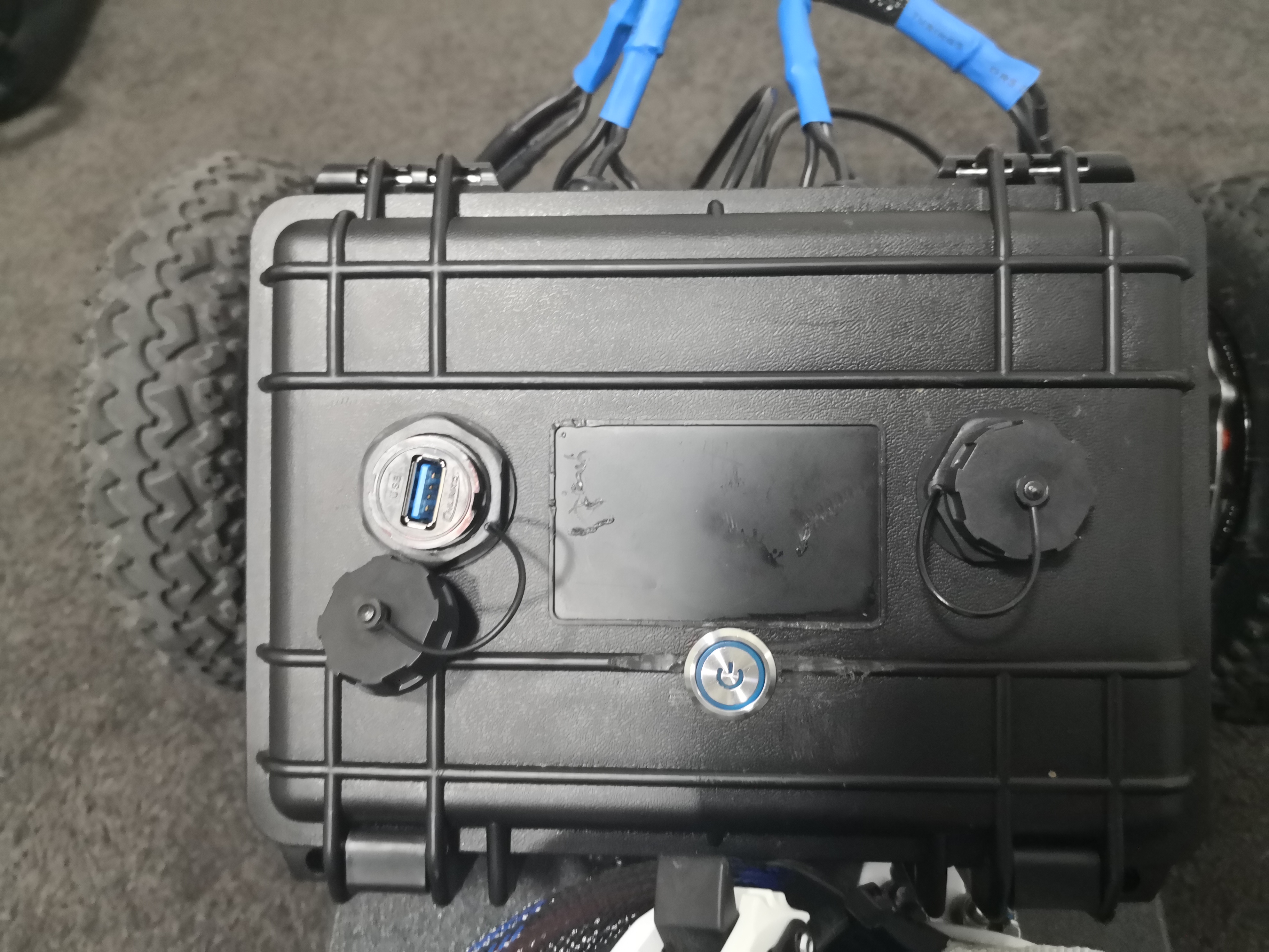

Got my fesc back from repairs it had a damaged can switch on it and the firmware was corrupted. So I didn’t have an St Link to fix that. Took a few weeks but it’s almost done just got some 90 degree USB adapters coming in since the 2 USB charge ports I got on my board fit well but didn’t realise how stiff and long the cable ends are. Got the electronics case all drilled out. Still need to figure out what I want to do with sensor wires without having to cut them.

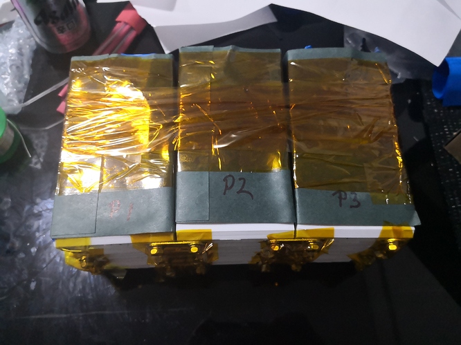

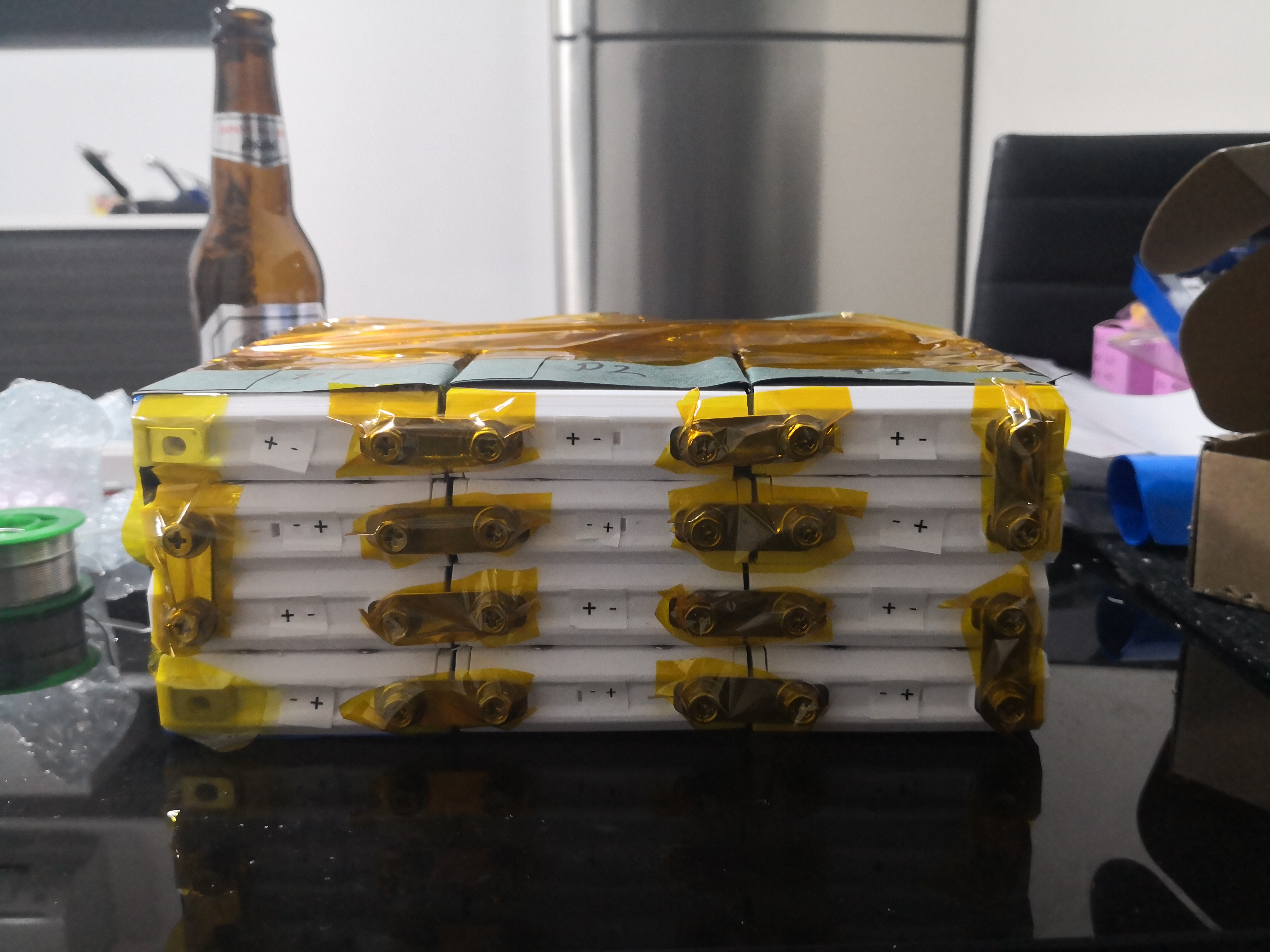

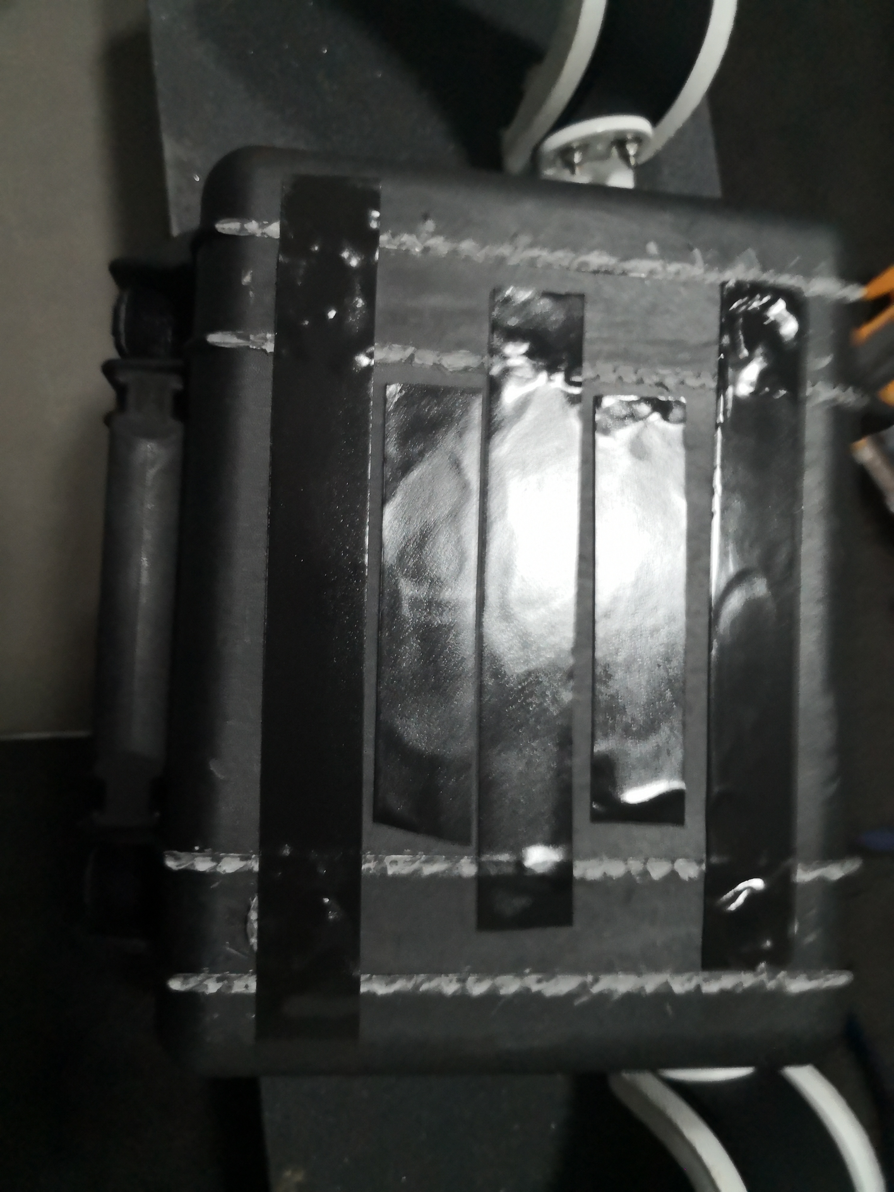

Got the battery mostly assembled with nese modules. I decided to zip tie the lids down at the back be ause I had some issues closing them. My own fault printer wasn’t calibrated correctly and I was in a rush to print 2 modules a day running 24/7 for 5 days printing 13 modules. 1 spare for my 12s7p I ended up going with 7p modules and 12s7p fits perfectly snug in the pelicase 1200

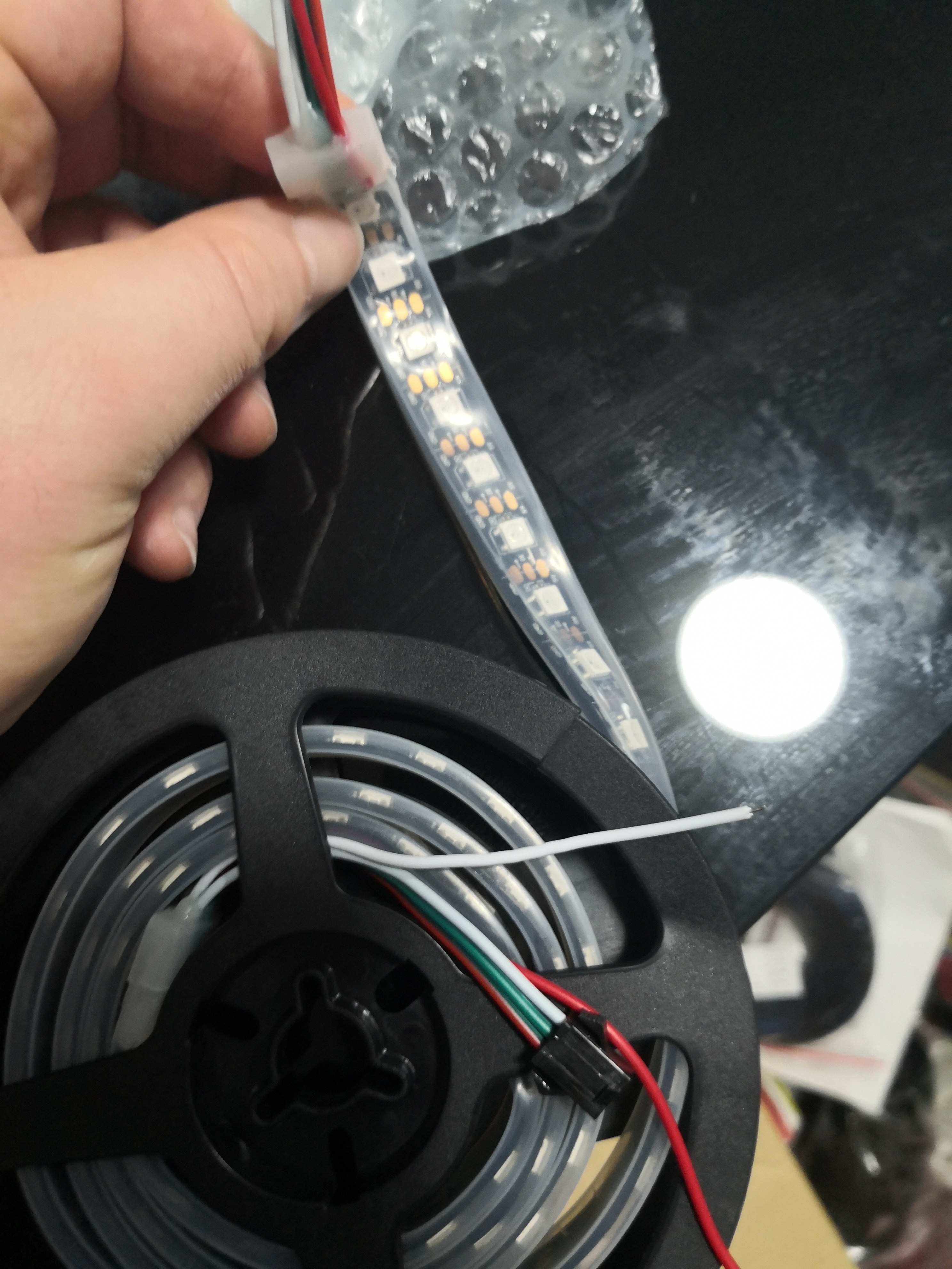

Need to install LEDs with a plug n play. Going to use velcro as I want them removable when I take it off road. And need to figure out how I’m going to wire it to the enclosure. I don’t plan on drilling holes in the deck.

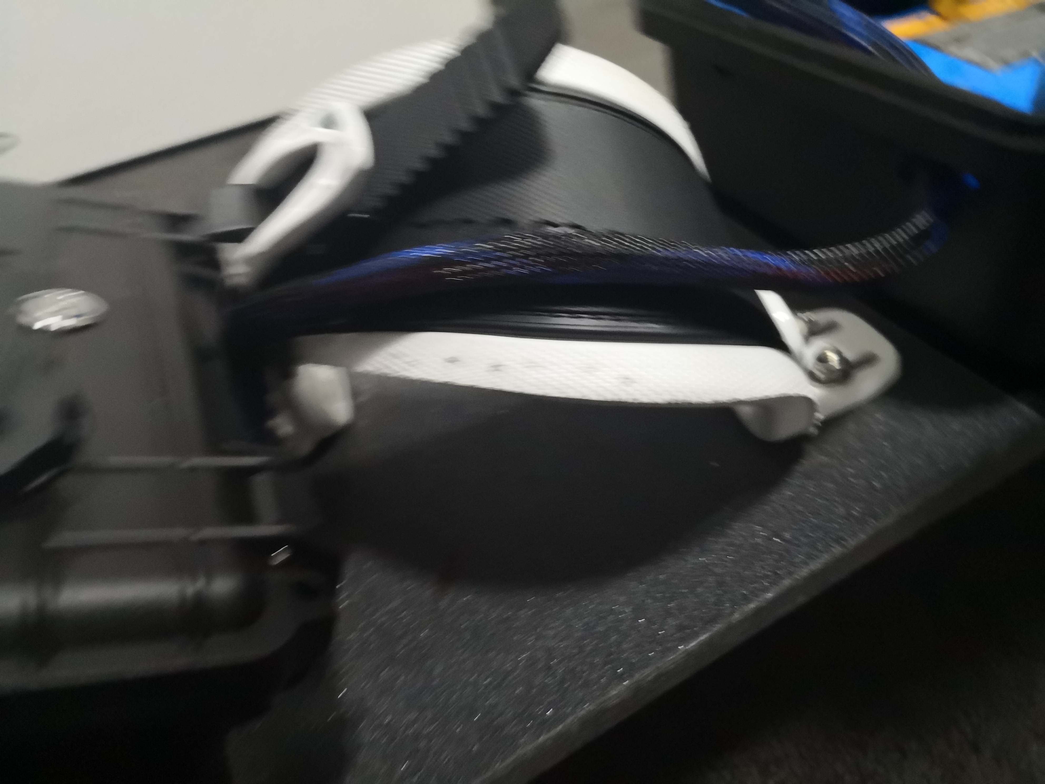

I used almost a roll of scotch double sided tape the strongest tape I know and I well over did it here. I used it to raise the velcro at the back of enclosure. It’s not velcro it’s that 10x seonger ruff that I’m not happy with but I need that removable as it’s over the back trucks and using scotch tape I’m more likely to rip the case apart trying to pry it off the deck.

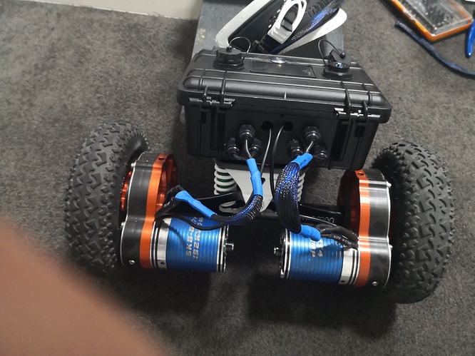

Photo time
It’s not as clean as it should be but I’m limited on tools and working on the floor of my apartment so I did what I could to finish it with what I had.
Why do you need the insulation paper on tbe outside of the nese modules?
Piece of mind. They are also heat shrinked in the same groups. I did this mostly so the packs don’t move around. The battery bms and charge port will be the only thing in that case but just incase its not I don’t want any shorts

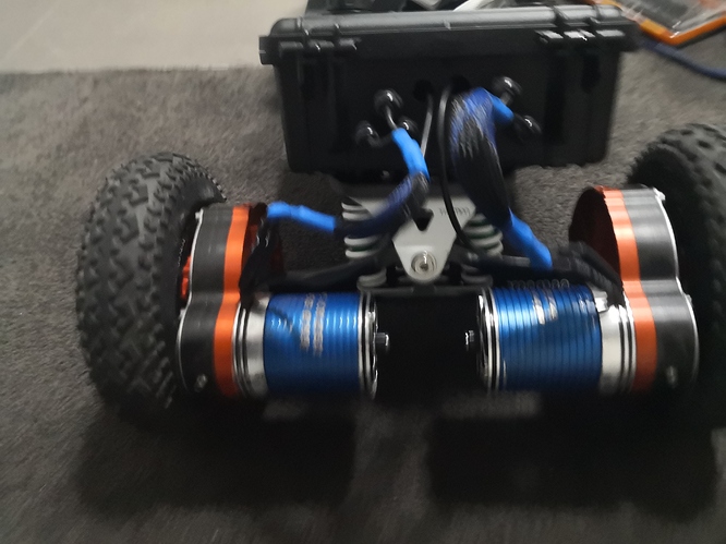

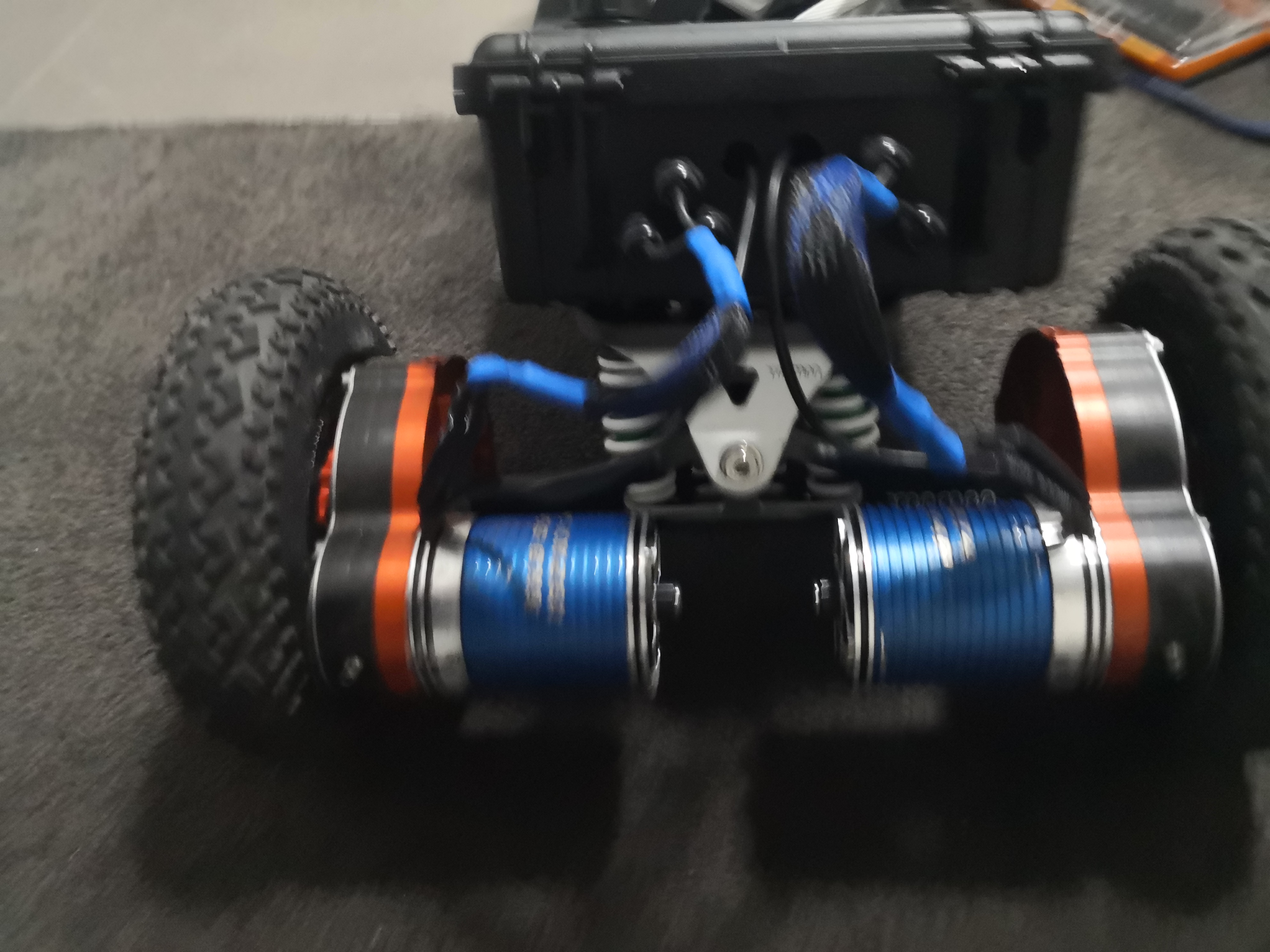

Looks like an amazing build. Love the orange gear drive/blue motor combination. I’ll definitely follow this :eyes:
thanks. i was on the fence about getting blue or orange and wasnt sure if it would look strange. i jsut need to add some more orange to the build and it will look a lot nicer. might do that with the undermount LEDS i plan to add pulsing orange/Blue to make it stand out a bit more.
